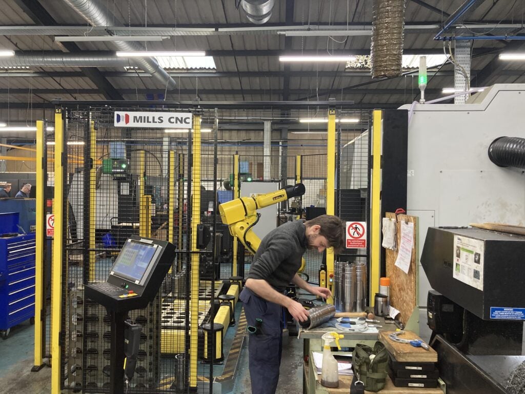

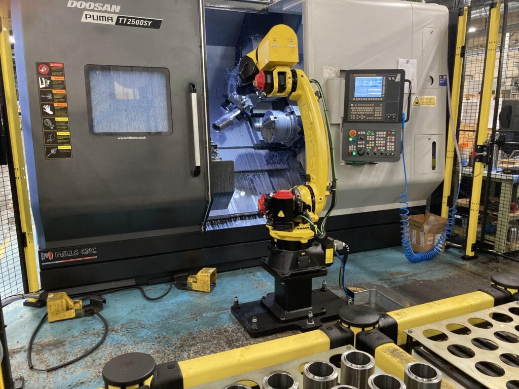

The new process centres around the recently-acquired SYNERGi Sprint system that comprises the following elements:
 • a Fanuc 25kg payload capacity industrial robot with a 2-jaw pneumatic gripper end-effector positioned in front of the TT 2500SY.
• industrial safety guarding and SICK light curtains/barriers that enclose the cell and provide a reliable, non-intrusive and efficient safety solution.

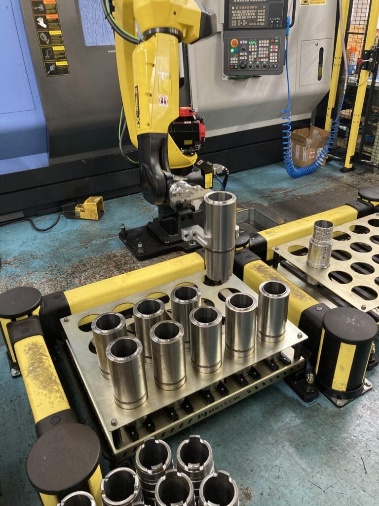

• two, separate, input (load) and output (unload) stations, with a 20-socket laser-cut fabricated, zinc-coated grid plate sitting on top of each.
• a 17” touchscreen HMI powered by Mills’ proprietary SYNERGi software.
Cell operation
The newly-designed automated machining process begins with the operator loading the left grid plate with 20 steel tube blank workpieces.
The robot picks up each workpiece in a programmed sequence and, taking advantage of the TT 2500SY’s auto door opening facility, loads individual parts in the machine’s left spindle.
The door then closes, automatically, to enable all machining operations (i.e., turning diameters, knurling, slotting etc,), to be undertaken seamlessly and in one hit.
Once completed, the robot takes the finished machined part from the machine’s right spindle and places it in a predetermined, designated position on the output grid plate, and the sequence begins again until the 20-part batch has been machined.
