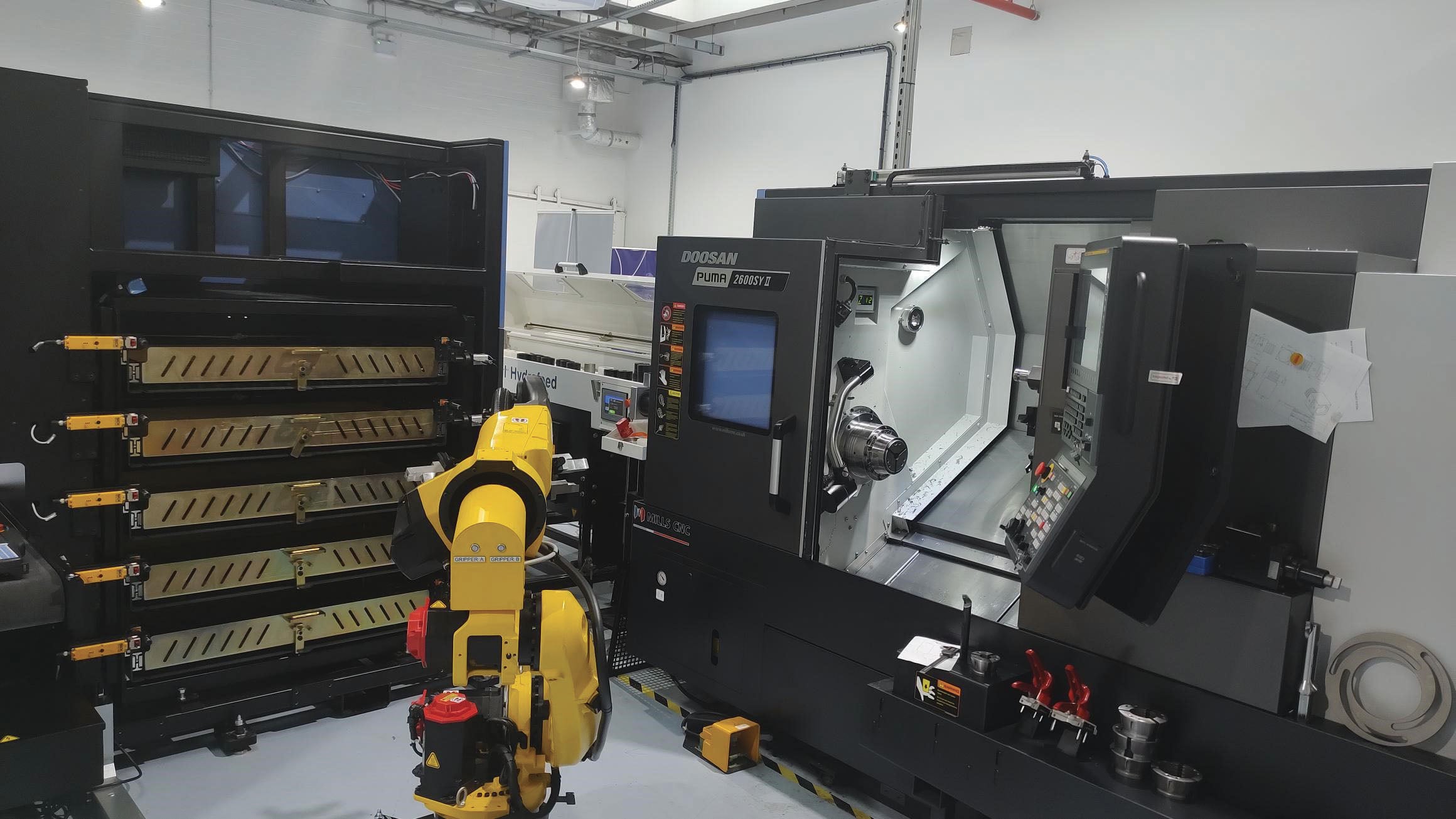

The new, large-capacity SYNERGi Premier system was installed at IMR’s 35,000 sq. ft. Technology Centre facility in Mullinger, Country Westmeath in November 2021, and has been integrated with a Doosan Puma 2600 II multi-tasking lathe, acquired by IMR from Mills in August 2020, to create a flexible automated manufacturing cell.

The SYNERGi Premier system is a rigid, robust and large-capacity automation system comprising a Fanuc 6-axis Industrial robot (25kg payload) with Schunk 3-jaw grippers integrated with a five-drawer, bi-directional part loading and unloading station and laser floor scanner technology. It also features a part inspection conveyor and a 17” touchscreen HMI powered by Mills’ proprietary (SYNERGi) software.

“We particularly liked the System’s Five Drawer configuration and capacity, (each drawer is 900mm (W) x 600mm (D) x 200mm (H) with a 200kg maximum weight per drawer), and it’s innovative laser floor scanner technology that ensures safe operation.
