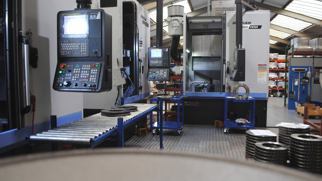

The new flexible manufacturing cell at Alcon comprises three new Doosan 15” chuck V8300 vertical turning lathes with Fanuc controls.
The machines feature an integral box guideway design that helps reduce vibration and facilitates heavy-duty and high-precision machining. All three machines are equipped with powerful (45kW/2000rpm), high-torque (2592N-m) spindles and fast servo-driven turrets (12-station) for rapid indexing and accurate positioning.
The machines have large axis travels – 495mm (X-axis) and 780mm (Z-axis), a maximum turning diameter of 830mm and a 750mm maximum turning height. The machines are fast with 20m/min rapid rates on their X- and Z-axes.
The V8300 lathes at Alcon are positioned in close proximity to each other enabling rapid part transfer between them, and are being used to machine a range of different sized brake discs.
The discs are made from cast iron (castings) and are machined to tight tolerances and high surface finishes in low volumes. Alcon currently machines approximately 500 – 600 discs per week in the new cell.
Brake disc diameters vary in size (from 200mm to 405mm) depending on the end application.
Explains Brian Cutler:
“All our brake discs are produced in three operations using the three machines  – so in effect that’s one operation per machine.
“Initial roughing out operations are performed on one machine before the disc is transferred to the second and third machines for machining the top face and bottom face of the brake discs.
“Having three machines at our disposal means that production is not affected or interrupted if one machine goes down.
“The machining process, developed in collaboration with Mills and using the three V8300 vertical lathes, has enabled us to ramp up production and to reduce part cycle times by up to 40%.
“We are tweaking the process continuously to make it even more efficient and effective.”
