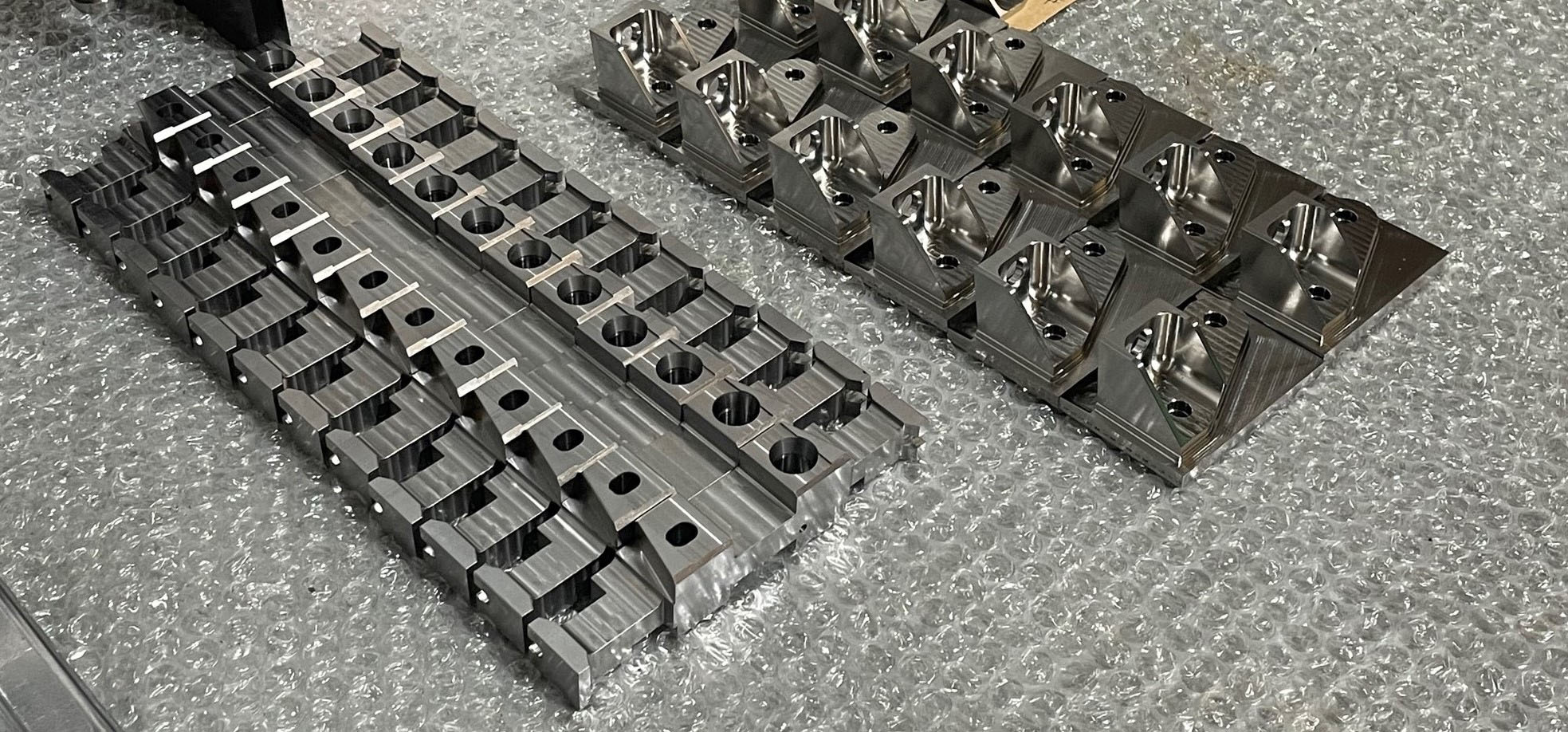

The new DVF 5000 has significantly increased the company’s machining capacity and capabilities and is being used at this moment in time, to machine a range of high-precision, low volume complex components (primarily prototypes, one offs and pre-production parts etc.), for its aerospace and medical device customers.
These components, made from aluminium, stainless and titanium etc., are machined to tight tolerances and exacting surface finishes. They are often characterised by their intricate features that can only be machined, or can only be machined economically, by using simultaneous 5-axis technology.

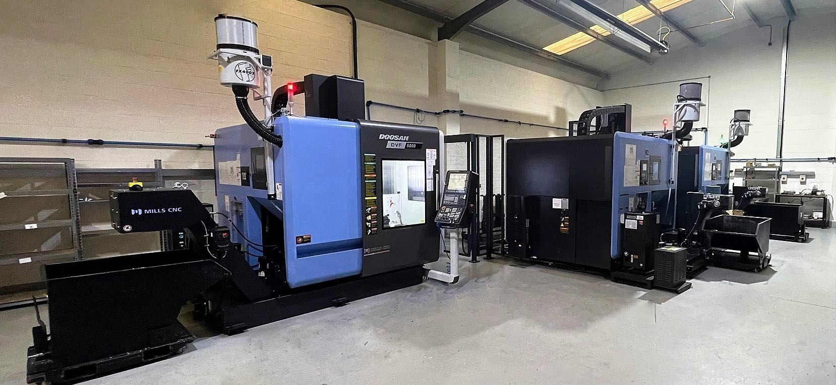

Although currently operating as a standalone machine the latest DVF 5000 investment should not, and cannot, be seen in isolation.
Explains Jim Lenane:
“The new DVF 5000 has been deliberately positioned adjacent to the flexible automated manufacturing cell that was delivered and installed in March 2020. The new DVF 5000 complements and works in tandem with the cell.”

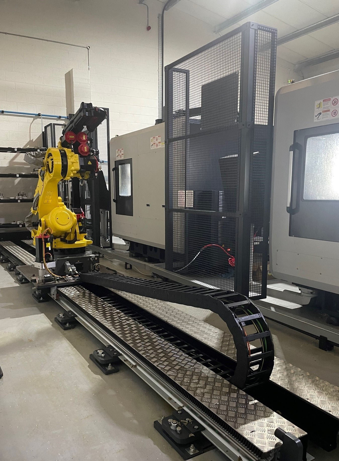

The automated cell – a sophisticated, complex and modular turnkey solution designed by Lenane in conjunction with Mills CNC – comprises two DVF 5000 machining centres and a Fanuc industrial robot integrated by a robot positioning track that runs between both machines to enable fast, efficient and reliable part loading and unloading operations to occur.
Other elements of the cell include an integrated racking system, holding up to 36 x pallets (400mm x 400mm, each with a 140kg maximum load), onto which workpieces are set up and clamped prior to loading into the DVF 5000 machines and, after machining operations are completed, where machined components are stacked and stored.
The cell is driven and controlled by Mills CNC’s proprietary SYNERGi software which, with its touchscreen HMI, provides a seamless interface between the machines and robot.

The latest DVF 5000 machine ordered by Lenane has, to all intents and purposes, the same technical specification as the two previously acquired machines: this was a deliberate decision based on:
a) Staff knowledge of, and familiarity with, the machine’s configuration and operation. The idea of bringing in a different machine and of introducing a new and unknown variable into the production process was not an option
b) The potential integration of the new DVF 5000 into the company’s automated manufacturing cell in the future.
Continues James Ryan:
“Depending on future demand and how we organise ourselves to meet it, the new DVF 5000 machine may well be integrated into the cell.
“Such scaling up can be achieved by extending the robot rail so that the Fanuc robot can service three machines and explains why we installed the new DVF 5000 in such close proximity to the cell in the first place.”
With a significant proportion of prototype and pre-production work undertaken on the standalone DVF 5000 expected to move into full production in the future – it makes perfect sense, from a process consistency perspective, to integrate the machine into the cell.
