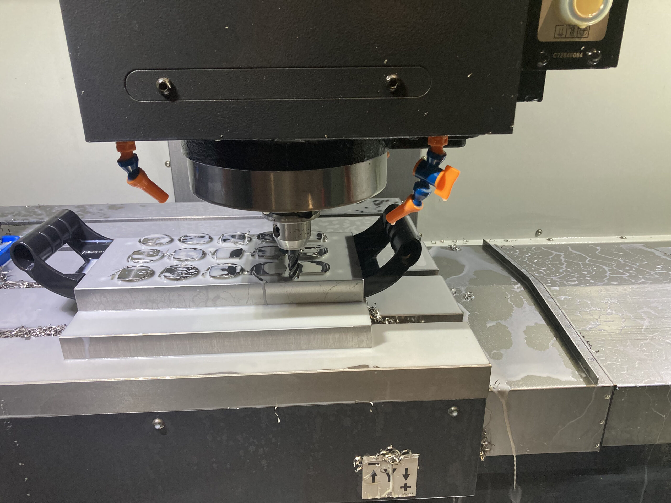

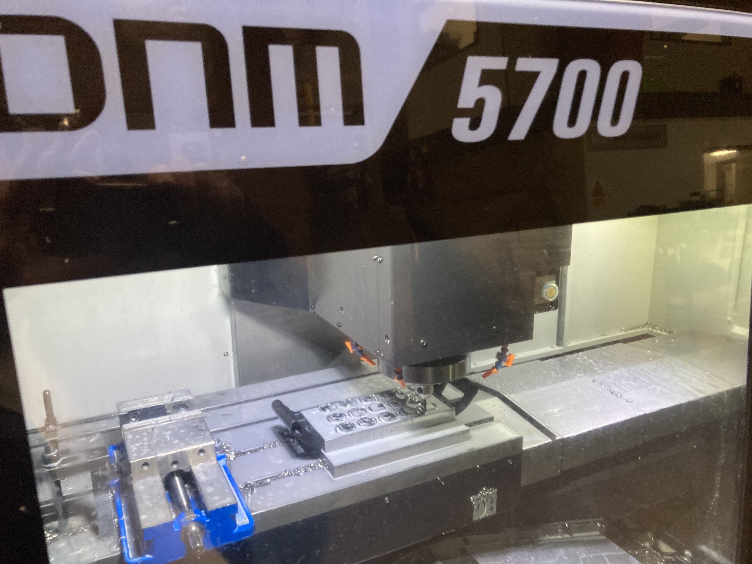

Since being installed in July 2025, NextGen Precision is using the DNM 5700 to not only machine and supply large quantities (i.e. 2500 parts per month) of high-precision parts, machined in batch sizes of 15-off, for its new security industry customer, but also to develop and refine the machining processes currently employed to machine the parts to further optimise processing speeds, repeatability and reliability.
The parts being machined are small (i.e., 50mm diameter), and are made from Stainless 316. They are machined from solid billet, using small diameter tools and high-pressure coolant, to tight, exacting and non-negotiable tolerances (i.e., 10 microns) and, using Fusion CAD/CAM, are machined to completion using innovative fixtures designed and manufactured in-house by NextGen Precision.
(Incidentally, the cycle time currently required to process a batch of 15 parts on the new DNM 5700 is 105 minutes compared to 270 minutes on NextGen Precision’s older milling machines).

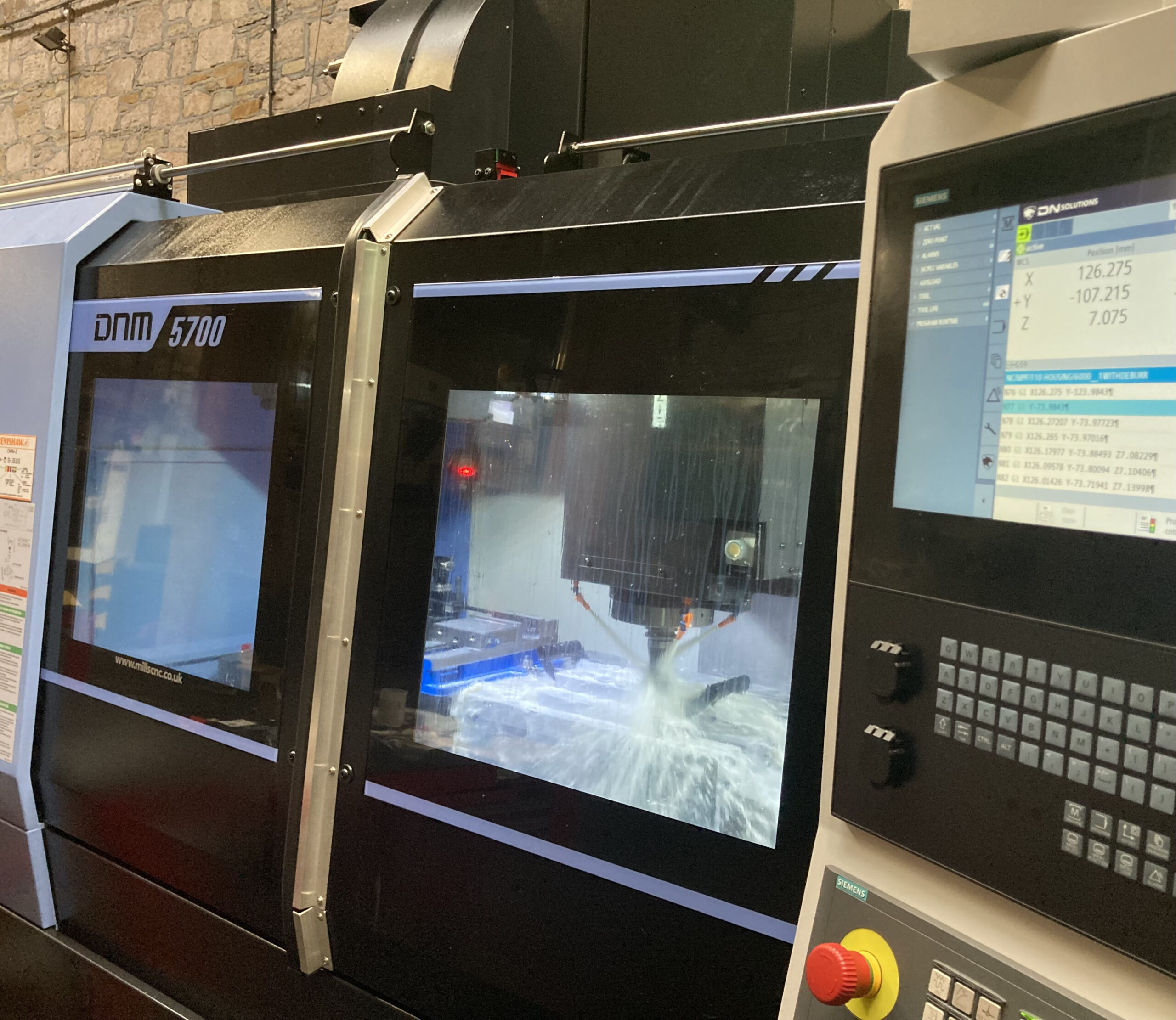

DNM 5700 – a closer look
DN Solutions’ DNM 5700 vertical machining centres are proven performers and are amongst Mills’ best-selling, small to medium sized, CNC milling machines.
The model installed at NextGen Precision was equipped with a powerful, high-torque 18.5kW/ 12,000rpm/ 118N-m directly-coupled spindle, a large worktable (1300mm x 570mm) with a 1000kg table load, roller-type LM guideways, a 30-tool ATC, a large coolant tank (430L) and the, previously mentioned, advanced Siemens 828D control with conversational ShopMill part programming capability.
The machine was also supplied, in addition to its probing systems, with a FilterMist oil mist extraction unit and a swarf conveyor and bin.
