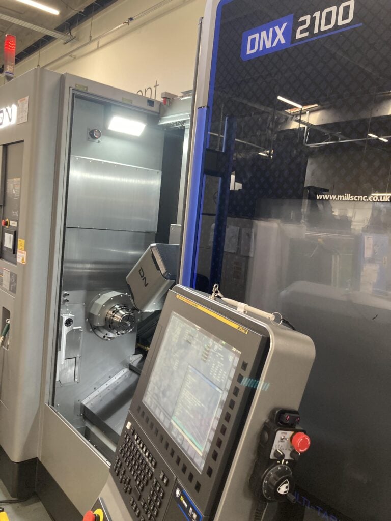

DNX 2100SB machines are equipped with 10” chuck/81mm bar capacity main spindles and 8” chuck sub-spindles, an 18.5kW/12,000rpm B-axis milling head with a +/- 120-degree rotary/tilting movement range and 0.0001 degree indexing capabilities, a 60-tool-position ATC and the advanced Fanuc 0iTP control.

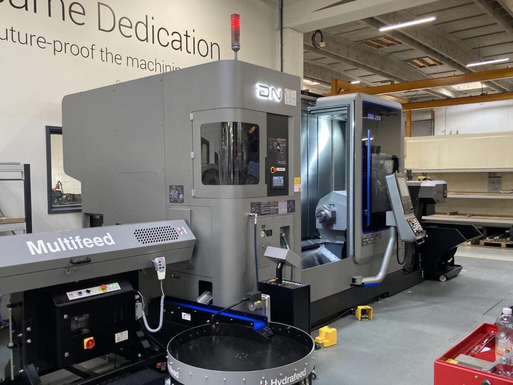

  1.  A Hydrafeed (MultiFeed 80) short magazine bar feeder to facilitate continuous automated production.
  1. A Hydrafeed ‘Rota-Rack’ rotary parts accumulator for the safe transfer and storage of finished parts.
  1. A Renishaw RMP 60QE compact spindle probe with radio signal transmission for automated workpiece inspection and faster job set ups.
  1. A Renishaw HPMA servo-driven, in-process, tool-setting and broken tool detection system.

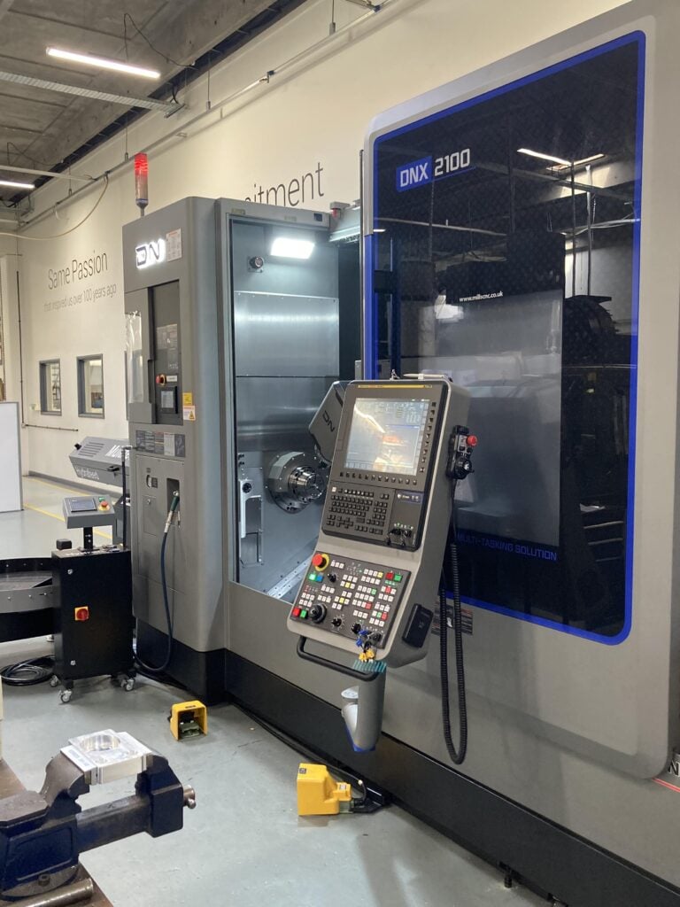

The machine was installed at Cogsdill-Nuneaton’s 27,000sq. ft. facility in December 2025, just before the Christmas break, and was, at that time, the first DNX 2100 model to be both purchased, and installed, anywhere in the UK or Ireland.

The integration of a bar feeder and sophisticated parts accumulator in addition to the machine’s large ATC and in-process tool setting and tool break detection has resulted in the creation of an automated manufacturing cell capable of running 24/7.
