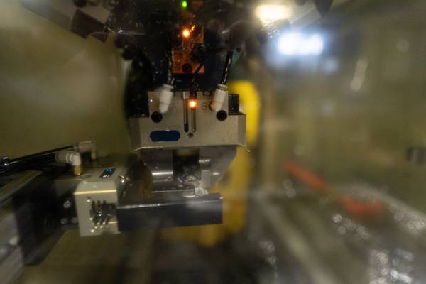

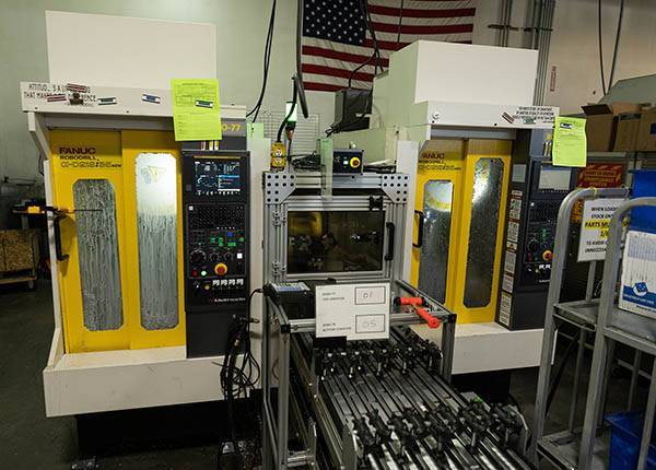

Jones worked with Methods on a turnkey automation cell utilizing the JobShop Cell, which comprises two FANUC RoboDrills and an articulating FANUC LR Mate 200iD robot.

Methods’ applications engineering team designed the cell for single-piece runs. That method retained the RoboDrill’s lightning-like 1.3-second chip-to-chip change time and removed the possibility of errors in the loading/unloading process. Moreover, the shop was free to run unattended.

The JobShop Cell improved nearly every workflow on the shop floor; it unshackled skilled laborers so they can tend to other equipment rather than loading/unloading machines. And, the cell came online just in time for a high-production project for the outdoor goods industry.

Not only did Methods deliver on that big ask, Jones said, but experts also helped him work out some kinks. At first, chips were getting near the cell’s proximity sensor and piling up in the wrong area.
“I requested additional air ports for the robots to help me manage chips, and Methods came in and solved that for me,” Jones explained.
