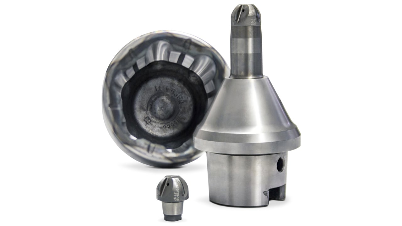

The production of the latest line of drive shafts started at the beginning of 2018, and the production volume will be as high as 35,000 units in 2019. “We use the ball nose milling cutters from MAPAL to machine the ball raceways of what is known as the bell or axle spindle, for which strict tolerances are specified,” says Ahmet Simsek.
It is important that this drive shaft joint transmits the torque with as little influence on the steering as possible, even in the case of large working angles on the drive gears of front-wheel drive vehicles. This is why all requirements regarding quality, dimensions and surface qualities must be observed in a process-consistent manner. For example, the contact angle must be within a tolerance of ± 5°.

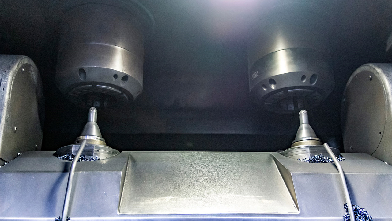

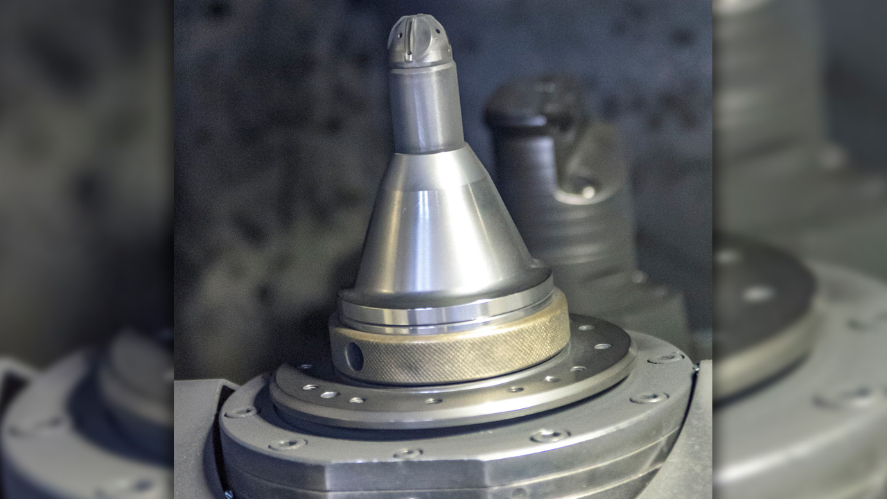

The machining of the forged axle spindles on an EMAG VSC 250 Twin machining centre makes high demands on the machine as well as the machining technology. The C50 mod. material exhibits a hardness between 58 and 63 HRc after induction hardening. “Our ball nose milling cutters are used for the final hard machining of the raceways,” explains Klaus Schwamborn. The tool, which has four soldered PcBN blades, removes between 0.2 and 0.4 mm of material.
MAPAL’s own high-precision connection
The tool is connected to the tool holder via MAPAL’s own HFS connection (Head Fitting System). The milling head is pulled into the holder with a high-strength clamping screw. The cutting head is aligned via the short taper so that it is accurate to the micron and clamped against the surface to ensure that the length dimensions in relation to the HSK face surface are observed. This highly stable connection also enables a high feed rate.
“The biggest challenge when designing the tool was to observe the tolerances in terms of a symmetrical contact angle and surface quality,” Schwamborn recollects. In the interest of cost-effective production, Neapco also places value on a long tool life. “On the basis of the profound knowledge we have gathered over many years, we tailored the tool to fit Neapco’s application and requirements,” says Schwamborn. The tool geometry was adjusted precisely to the required values in terms of raceway clearance and the osculation of the balls that lie between the inner and outer races.
