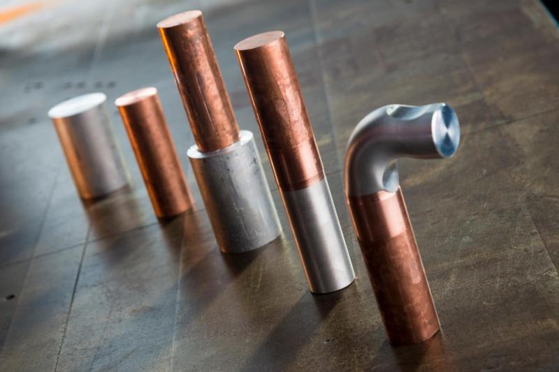

Dissimilar material shafts
One of the most significant benefits of friction welding, is the capability of welding dissimilar materials, which might not be possible using conventional welding methods.
As proven in the above examples, joining dissimilar materials provides a huge advantage across many different applications, whether to reduce cost, or weight. Friction welding can weld many different types of materials together whilst providing a homogeneous bond that is strong as the parent material.
There are many applications in which friction welding is used to join dissimilar materials. In the automotive industry to reduce weight, in the electrical industry for conductivity, and in the tooling industry to reduce material costs.
Many applications could be more efficient by using multiple material combinations, and friction welding is a strong, clean and reliable method of joining them.
