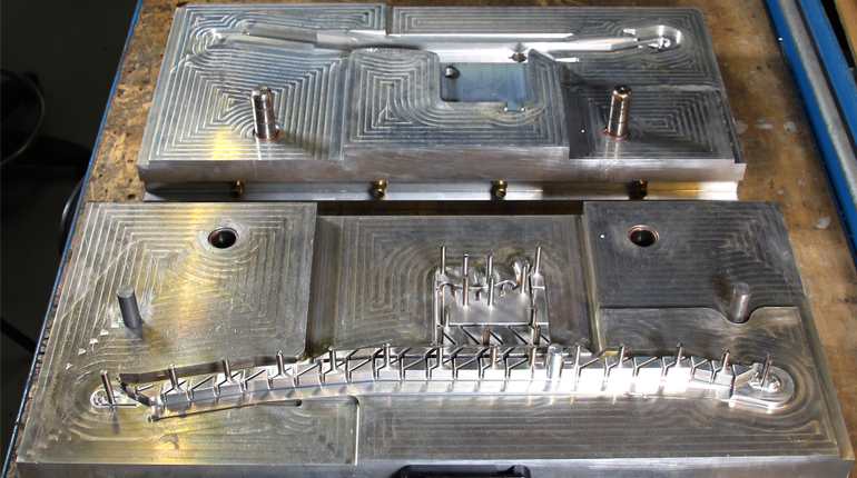

More than just another subcontract manufacturer, Vetech offers design and consultancy services to its customer base that now incorporates high profile names in the military, electronic sensor, motorsport and plastic moulding sectors as well as the ever expanding network of garden equipment manufacturers. Upwards of 60% of business at Vetech is aluminium mould tools for the garden and leisure industry; and it is here that Tamworth cutting tool innovators ITC has made all the difference.

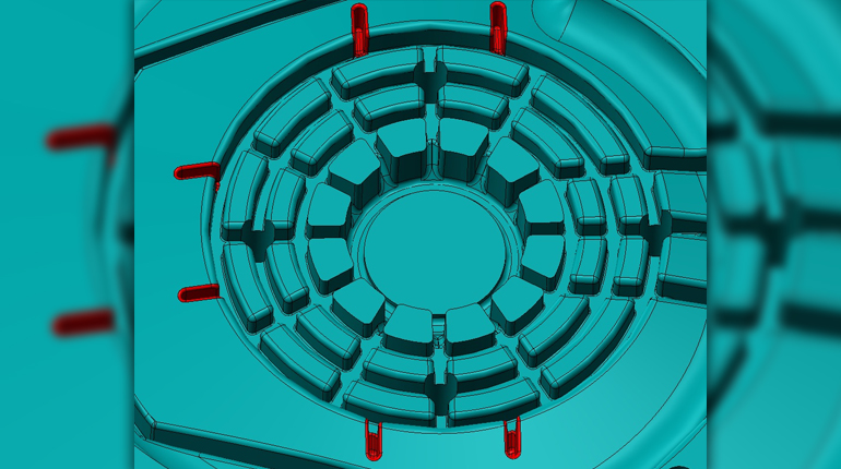

Many of the aluminium mould tools manufactured at Vetech are for rapid prototyping projects, making turaround times critical. With the availability of high spindle speeds of 60,000rpm, Vetech could apply ITC’s 1mm diameter solid carbide end mills to mould tool ribs that were previously processed via EDM.  Referring to this, Mr Smith recalls: “We process a lot of mould tools with complex rib designs that often incorporate cross rib designs. On one of our early tools for a lawnmower motor end frame, we had to spend 3 hours programming two different electrode designs that would then require an additional 4-5 hours of machining. After this, the erosion time would be upwards of 8 hours and finally there would be an additional 3-4 hours of hand finishing.  With ITC tools and the high speed machining, we immediately eliminated this 16-20 hour process and replaced it by CAM programming the mould tool and machining it in 4-5 hours with impeccible surface finishes. This cut our complex mould tool production times by 75%. Essentially, we were producing a challenging mould every 2 weeks – ITC reduced our mould tool production costs by over 25% almost overnight.“
