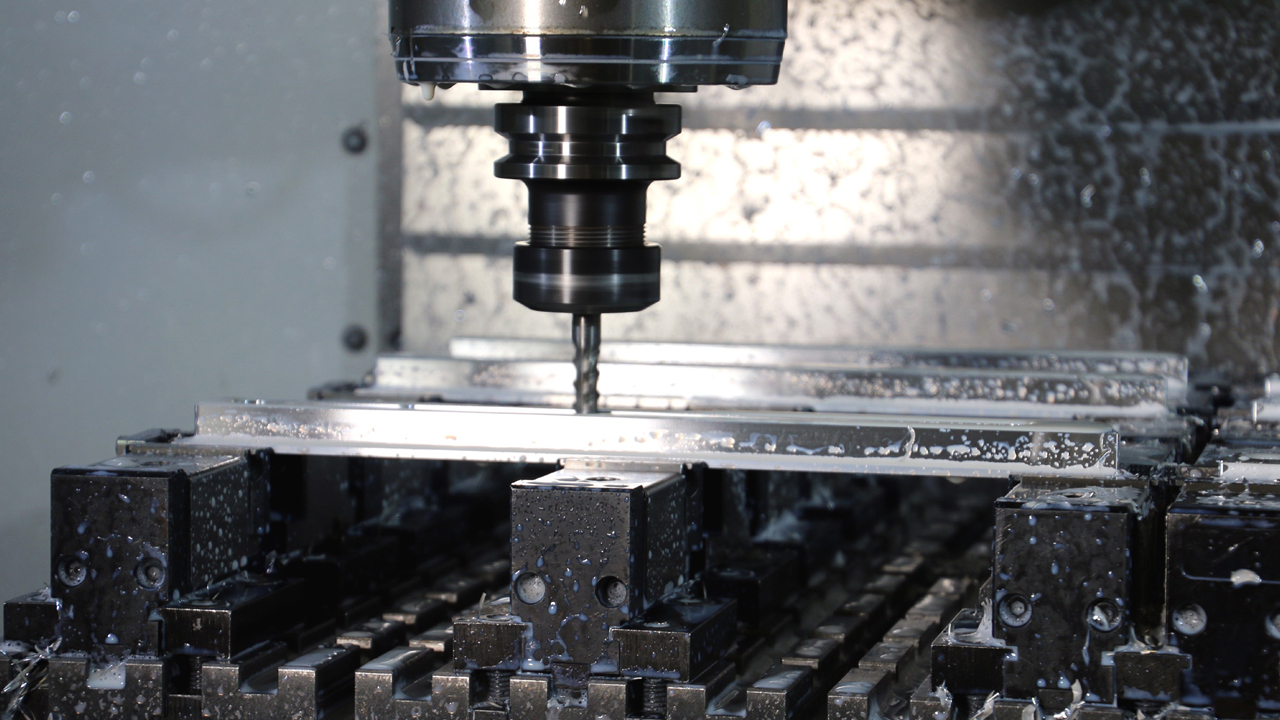

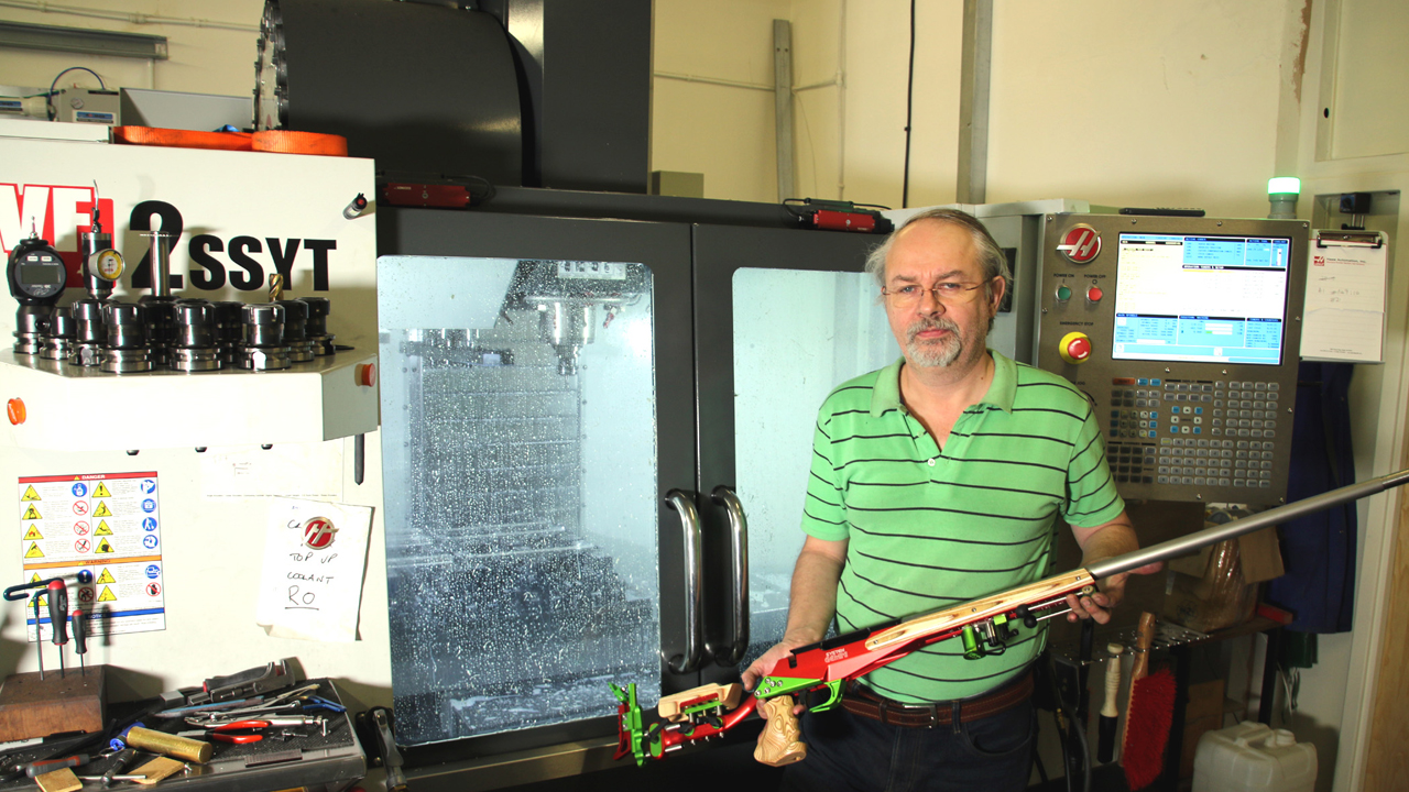

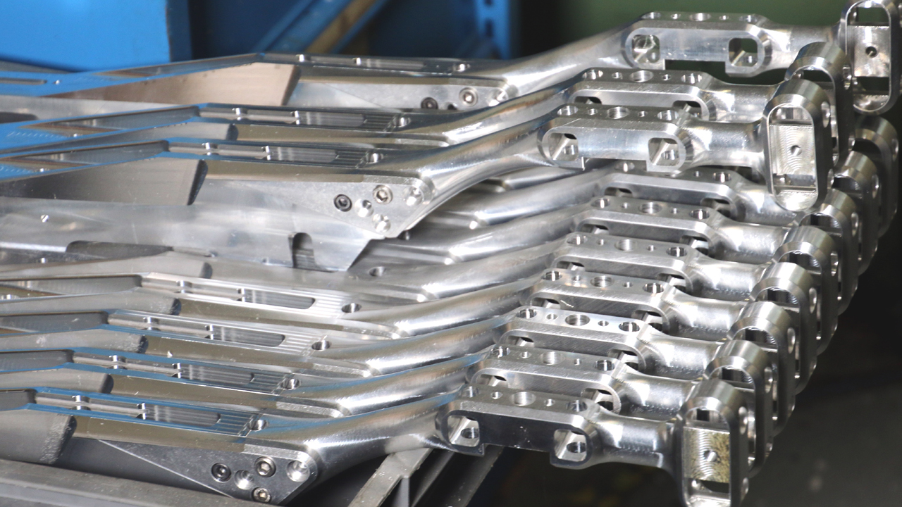

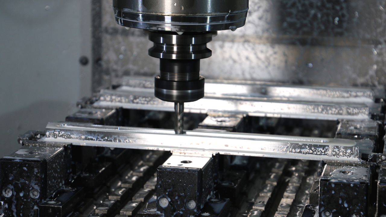

The success of the ITC WIDIA face milling tools opened the door to trial other ITC products on the company’s HAAS VF2-SSYT 3-axis machining centre. “The performance of the WIDIA face mills was exceptional, so we introduced the WIDIA 49N9 solid carbide 3-flute rougher to the profiling of pockets on 6082-T6 grade chassis sections. We previously used solid carbide end mills from two well known brands with limited success. Then Tom Lindley, the Area Sales Engineer for the Tamworth based tooling manufacturer, suggested running the ITC WIDIA 49N9 at 12,000rpm and just shy of 8m/min at full 24mm depth of cut with a 10mm step-over; each parameter at least 50% greater than the previous tools. I was very apprehensive, but the WIDIA tool cut through the aluminium like a hot knife through butter. Processing the roughing operation at double the speed and feed parameters of the previous tools, and with manageable chip size, the WIDIA 49N9 contributed to reducing the overall cycle time of rifle butt components. This high speed machining reduced the chassis blank from 4.1kg to 1.7kg in 75 just seconds.”
