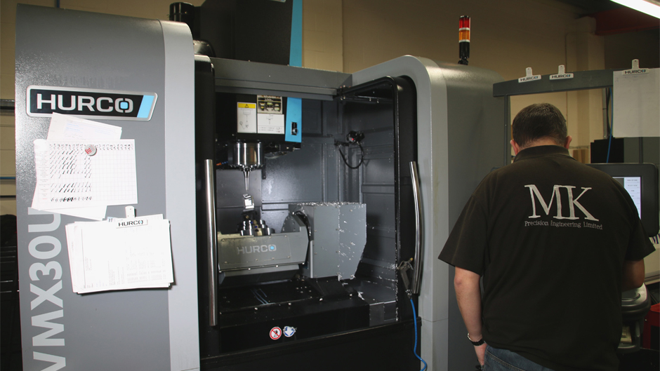

Commenting upon starting the company, Managing Director Mr Allan Carabine recalls: "I relied upon my experience of working with F1 teams and the motorsport supply chain to start the business with a 5-axis Hurco VM10U, which has been followed by two 3-axis VM30's, a larger VMX30U 5-axis and a TM8i turning centre; all of which are programmed with OPEN MIND’s hyperMILL CAM software and tooled with solid carbide and indexible cutting tools from ITC."

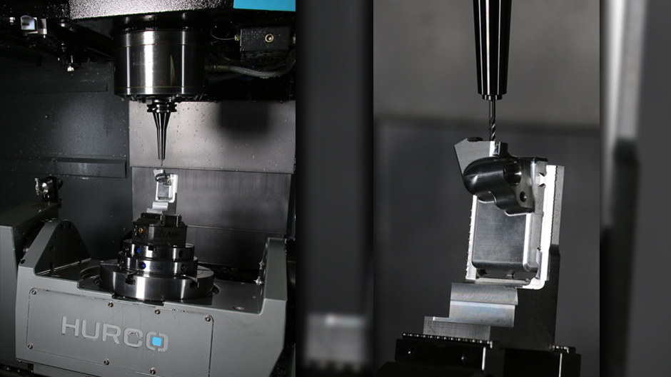

Following the success of ITC’s aluminium end mills at the Buckinghamshire Company; MK Precision then trialled the Widia VariMill 4777 Series of four-flute solid carbide end mills on titanium components. A specific project of 90 components required a 50 by 50mm pocket at a depth of 6mm on each part. The four employee company was again suffering from poor tool life and performance. The Widia VariMill 4777 Series immediately cut the cycle time from 15 minutes to 10 minutes per part. This is credit to the edge and flute geometry that works effectively with trochoidal milling strategies that are commonplace among leading CAM vendors.
The genuinely impressive factor of the VariMill 4777 Series was its ability to reduce cycle times by 35% and return a tool life improvement that enabled MK Precision to complete the whole batch of 90 parts with a single tool. Commenting on this, Mr Carabine recalls: “Firstly, we benefitted hugely from the 3081 Series of aluminium cutters. But implementing the VariMill 4777 Series took our productivity to a new level. With the hyperMILL CAM software, we have the fastest, most efficient and innovative machining strategies at our disposal. The only constraint with this high speed and feed cutting is the rigidity of the machine tool and of course; the capabilities of the cutting tools. Our previous tools were holding us back, but ITC’s tools are allowing us to unleash the full potential of the CAM software.”
