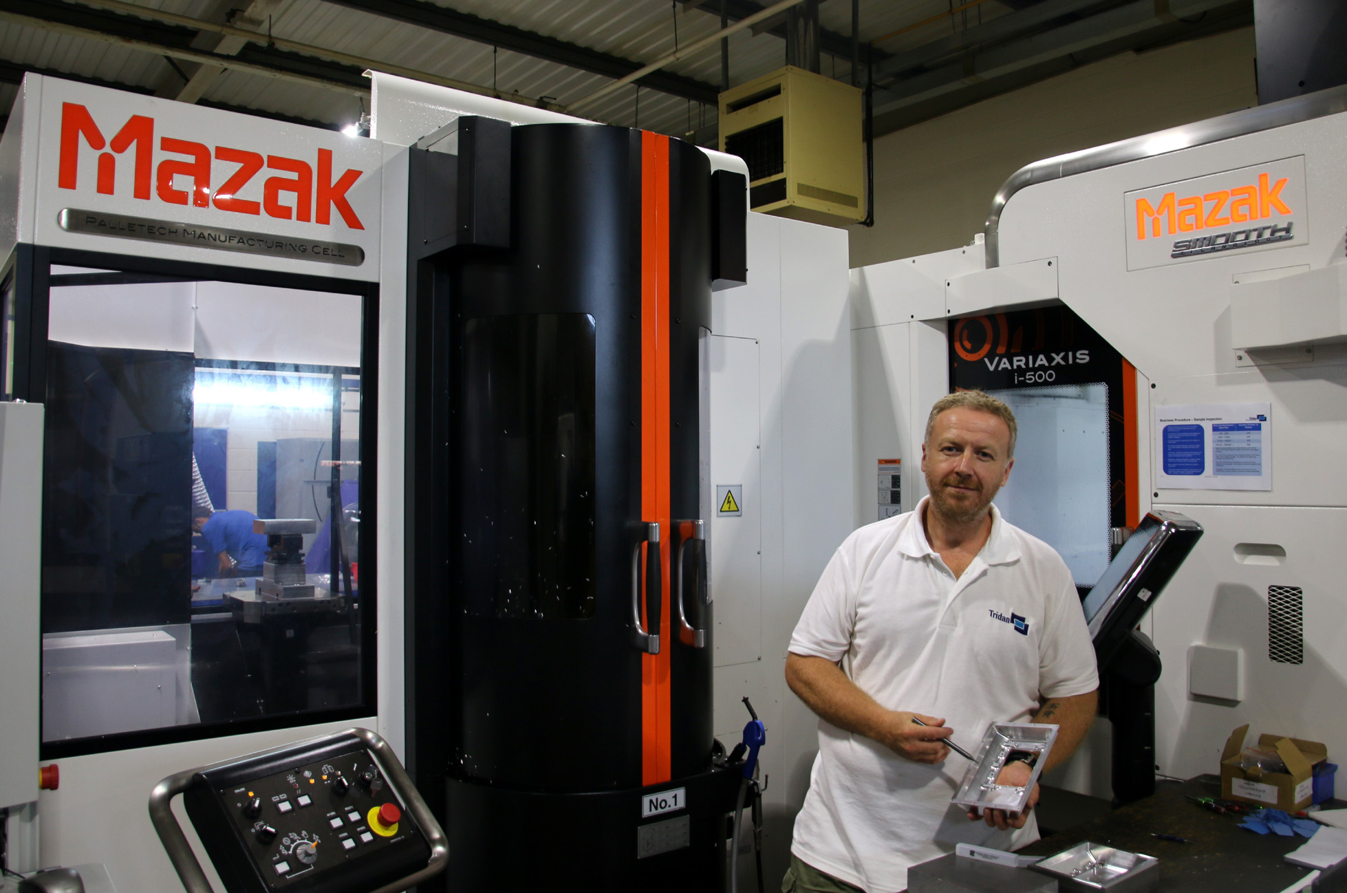

Celebrating its 50th year in business, the Essex subcontractor has spent more than £2.5m in the last two years with new acquisitions including two Mazak Variaxis I500, an I600 and an I700, a Quickturn 300 plus a Quickturn 200MSY, a 6-station Palletech automation system plus an additional three machines on order from XYZ. The investment in high-specification four and 5-axis machine tools and the ever expanding variety of materials being machined has prompted a strategic overview of its cutting tool strategy. In the two years since deciding to overhaul its tooling strategy, the AS: 9100 certified company has reduced its cutting tool suppliers from 14 to just two. From the 14 vendors, it is Tamworth based Industrial Tooling Corporation (ITC) Ltd that is driving innovation, cost reductions and standardising cutting tools.

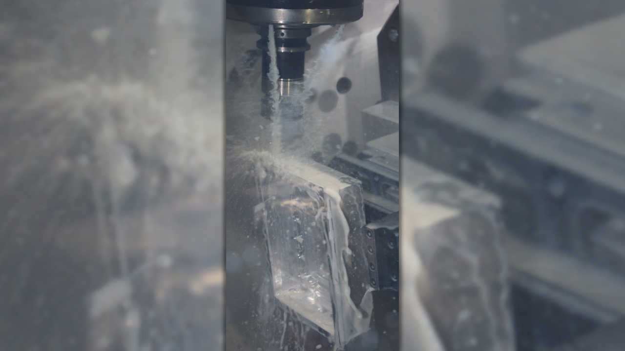

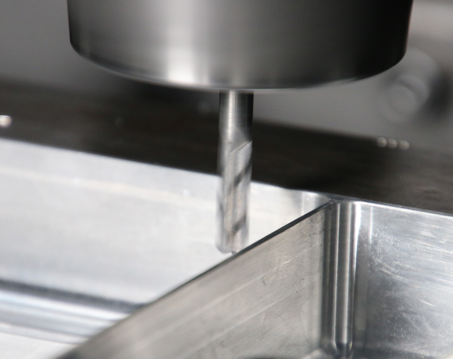

During the trial period, ITC was fast emerging as the front runner to win the solid carbide round tooling business from Tridan. This preference emerged from the relationship between ITC's Technical Sales Engineer, Mr Gary Bambrick and the Tridan engineers and shop floor machinists. However, with tooling manufactured in Tamworth, it was the rapid turnaround on standard and special tools that also impressed Tridan. Emphasising an example of this, Mr Townsend recalls: "We manufacture families of aluminium frame racks for the aerospace industry in batches of 10-off every couple of weeks. With a significant amount of material removal, we applied the ITC 49G9 Series of ripper end mills with through coolant and a trochoidal strategy that was recommended by Gary. This immediately reduced the cycle time from 6 hours to less than 5, a 20% reduction. With these racks there are a number of thin walls that needed machining and the tools were pushing against the wall, generating different wall thicknesses and wavy surface finishes. Gary worked closely with us and ITC’s Tamworth headquarters to change tool geometries, edge preparation and corner rads on a 10mm diameter 3081 Series end mill that was used for finishing the thin wall profiles. This not only resolved our technical issue, it demonstrated the expertise and the level of support from ITC."

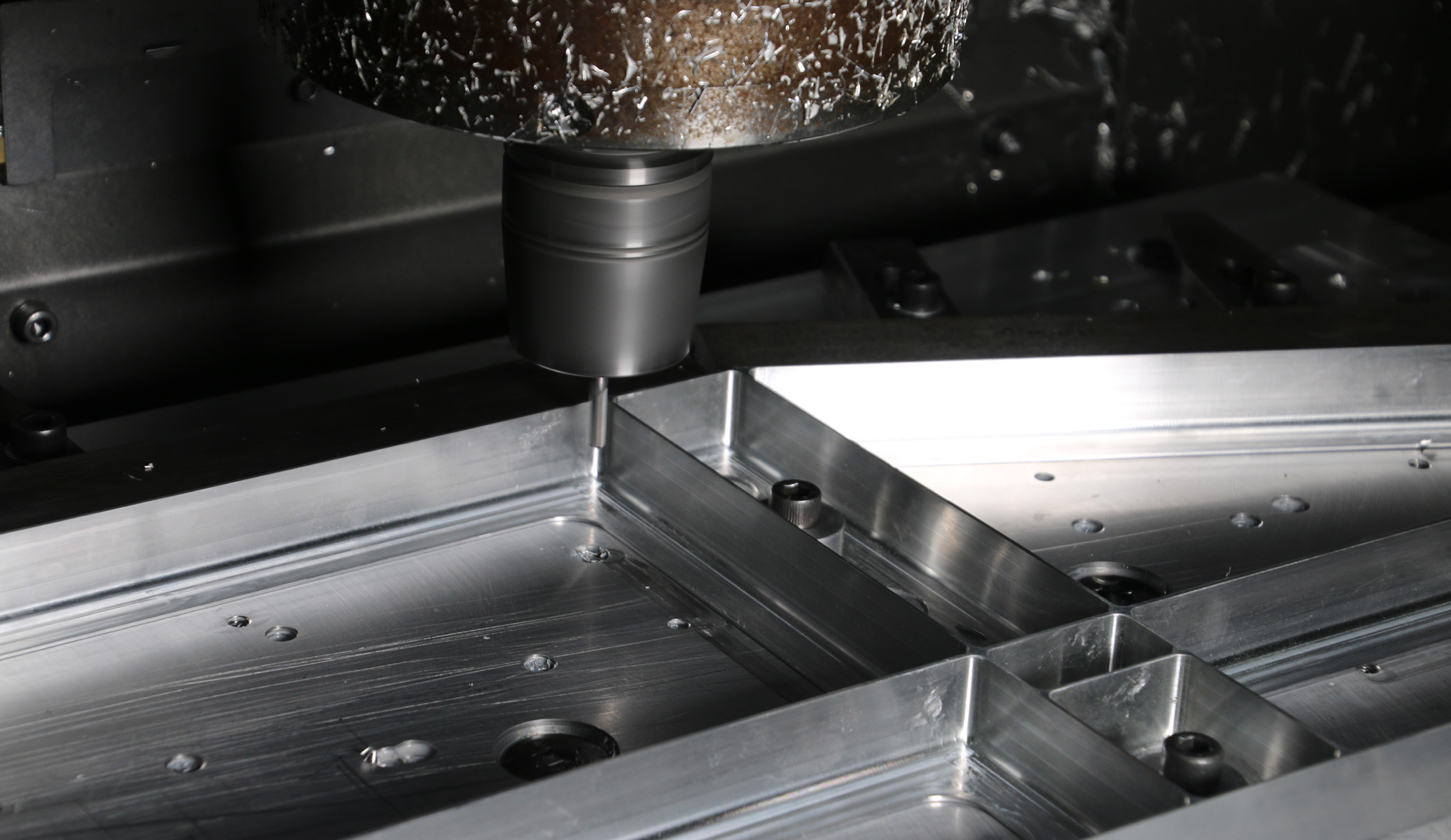

Another special application that was causing tremendous difficulty was a nose cone for the defense industry. The titanium cone had a rough machining cycle time of 45 minutes that ITC rapidly reduced to 25 minutes with a 5-fluted ripper, a significant saving on a batch of 100 parts. Following internal rough machining, the cone requires a series of slots and features and the limited reach inside the cone caused tool vibration that was impacting upon tool life. The previous end mills were wearing out rapidly through vibration after machining just three parts. As Mr Townsend continues: "The combination of the challenging aluminium alloy material and the extended reach requirement; the vibration created was ruining cutters. Added to this, the slots have a 0.03mm tolerance and we struggled to hit this tolerance because of the vibration. ITC developed a 2.8mm diameter extra long end mill on a 12mm shank that instantly eradicated vibration, improved surface finish and tool life. The new tool ensured we were easily within tolerance and the tool life went from 1 tool for every three parts to 5 tools for the full batch of 100 parts. This gave us consistency, reliability, conformity and it meant we didn't have to keep changing tools and checking parts. With this job running around the clock, we have a number of ITC tools that have been running for weeks on this family of parts.”
