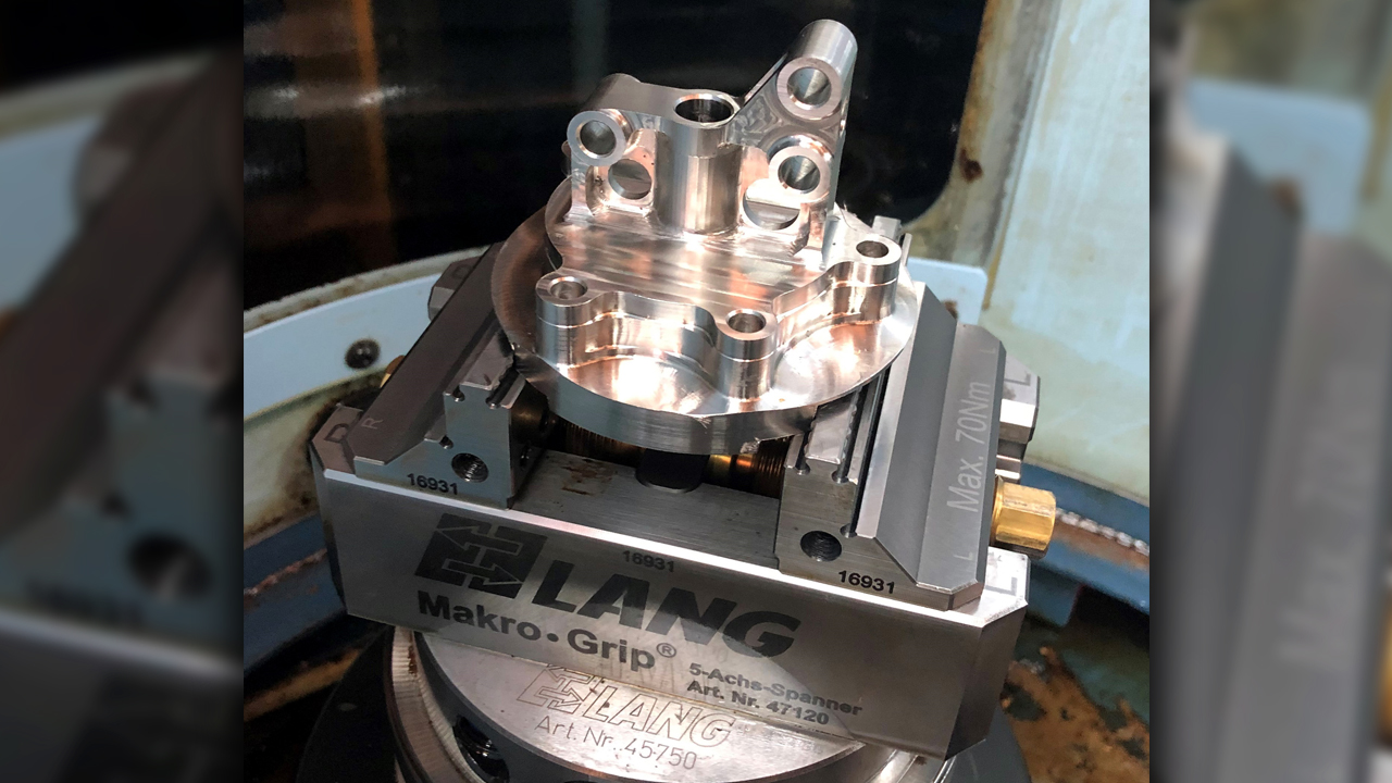

The Fife Company recently undertook a project for Mercedes HPP (high performance powertrain) that required programming and tooling efficiencies and improvements for the machining of a series of engine components. The complex outlet manifolds and valve waste assembly are manufactured from inconel 625 on Euro Precision’s high-spec Matsuura MAM-72 5-axis multi pallet machining centre. Manufactured for the next generation of supercar, the Mercedes HPP project requires over 2700 manifold outlets and 2000 valve waste assemblies. With such production volumes, it was critical for Euro Precision Ltd to get the process running efficiently as possible and this is where ITC entered the fray.

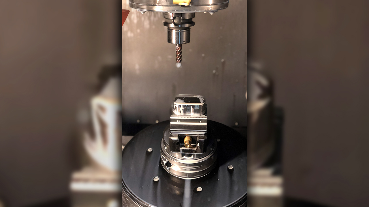

“Gary immediately doubled the surface speed by introducing ITC’s Cyber Series of multi-flute variable helix end mills and a trochoidal machining strategy at a 3XD axial depth of cut with a 4% radial step over and a high feed per tooth. The outcome was outstanding,” says Mr Steele.

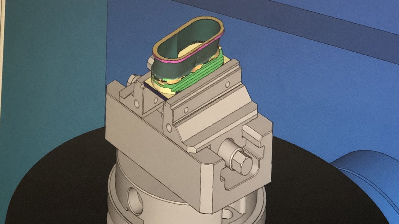

“With some subtle programme changes, we instigated a trochoidal machining strategy that increased the step over and radial engagement with the application of ITC’s 12mm diameter solid carbide Cyber Series. This reduced the cycle time by 50% and increased tool life by 3 times.”
By implementing a machining strategy that incorporated a 3XD axial depth of cut instead of the previous 1.5XD strategy, Euro Precision was able to conduct most of the rough machining in a single pass. The machining parameters far exceeded the realms of possibility for the previous tools supplied by a prominent international tooling vendor. The performance of the ITC Cyber Series and its ability to prolong machining on such a challenging material led to further ITC solid carbide end mill introductions to the prestigious project.
