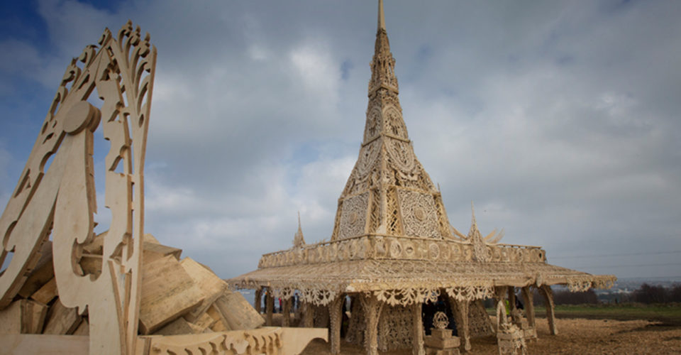

Working with show organisers Artichoke and David Best, Cutting Edge Designs was commissioned to cut 16 designs, each in a large quantity with over 1500 parts being cut from many of the 8 by 4ft sheets of birch wood. Employing all three of its routers to the project and a variation of ITC cutting tools, Cutting Edge Designs estimates more than 400,000 cuts were made in the 3-month timeframe on this project. A video of the project can be viewed here: https://www.youtube.com/watch?v=SfqdLyI3Mgo
