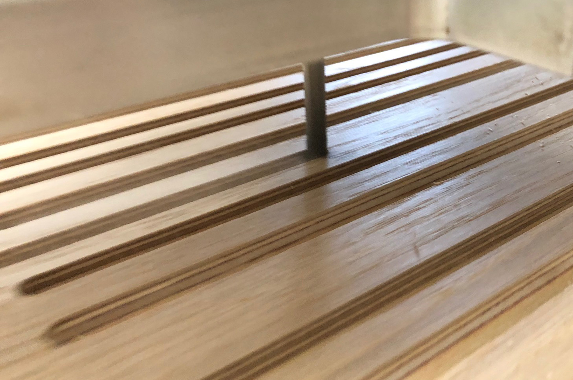

About a year ago, Woodcut Components received an order for acoustic ceiling tiles for a commercial customer that wanted the tiles manufactured from a laminated fire retardant MDF board that was a specified Euro Class A material grade. The existing solid carbide tools were inappropriate for the abrasive grade and machining characteristics of the board, so Woodcut Components once again called upon ITC and their Technical Sales Engineer Sally Hunt. As Mr Bate says: “The job order was for over 300 tiles, each one measuring 1200 by 600mm that had to be cut from 10 by 4 foot boards with lots of 10mm wide grooves in each tile. The machining time for the entire project was over 3 weeks and we knew that to get the job finished on time and to the quality required, we had to once again investigate new tooling strategies. Luckily, Sally from ITC introduced us to their 2102 Series of PCD tipped cutting tools.”
“At the start of the project, we applied our existing solid carbide routing tools, but the abrasive nature of the material would burn-out a tool after machining five tiles. We knew that the tooling costs and time constraints would be costly without changing to the ITC range of PCD tools. Sally recommended the 2102 Series and we bought 10 tools, we only needed 5 to finish the entire project. The tool life was phenomenal. We went from one tool for every 5 tiles with carbide to 50 tiles with the PCD tool; it increased our tool life by 10 times. We machined the dimensions of the 12mm thick tiles and the 10mm wide groove features with an 8mm diameter PCD tool from ITC and the results were staggering. We even had 4 tools left over at the end of the project. Thankfully, the ITC PCD tools are very versatile and they are being used to machine all our abrasive material projects.”
