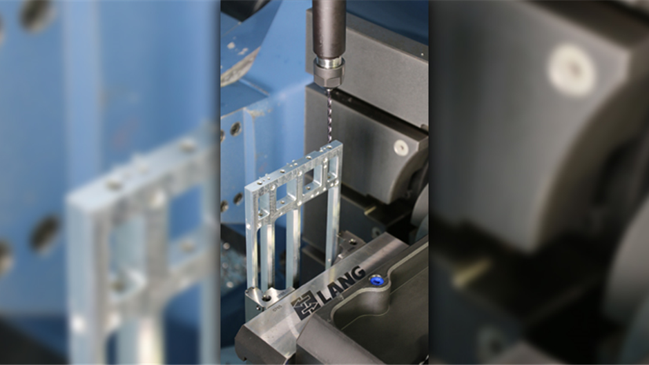

So, when the company recently won an order to manufacture aluminium telecommunication parts and it was witnessing poor tool life during drilling cycles, GPR once again turned to ITC. As GPR Managing Director, Mr Vernon Ward recalls: “We won an initial order for 20 sets of mobile phone test-bed housings and each set consisted of six parts. Included in the test-bed sets were four centre guides and each guide required the drilling of over 50 holes of varying diameters. The job required five drill diameters of 2.1, 2.5, 3, 4.2 and 6.2mm and with upward of 300 holes per set, we would have an average of three drill failures per set. The roughing, pocketing, slotting and other operations were all very productive as we were applying ITC’s aluminium end mills; however the drilling cycles were letting us down.”
“We persevered with existing HSS drills for a while and then we won an extended order for 80 sets of the mobile phone test-bed housings. This would have required a total of over 24,000 drilled holes; we instantly called ITC’s Dave Cleeve for a solution as we knew we wouldn’t meet the tight delivery schedule with drill failures and the associated downtime and changeovers.”

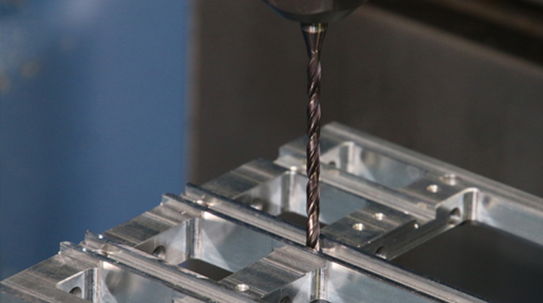

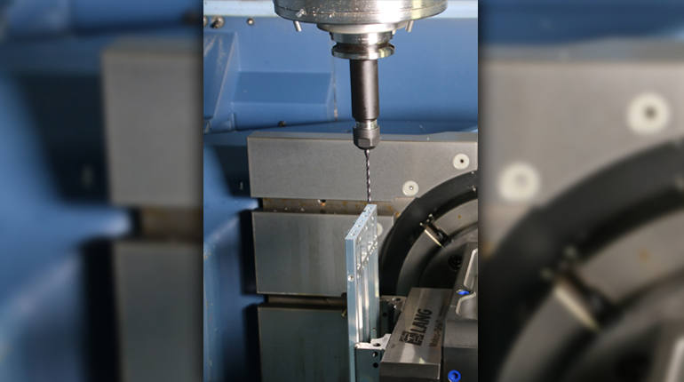

The experienced ITC engineer immediately suggested the Widia range of VDS solid carbide thru-coolant drills to eliminate tool failures and the associated time and costs involved with changeovers. Added to this, GPR wanted to improve the cycle times for drilling operations.
Each of the four centre guides had an overall cycle time of 1 hour 10 minutes and the application of the Widia VDS drills immediately reduced the cycle time to 49 minutes. This 20 minute reduction per part is credit to a number of factors that include the elimination of tool burnout and subsequent changeovers, the ability to run the VDS drills at higher speeds and feeds and also the ability to feed the drill straight through the part with no pecking cycle. The thru-coolant feature on the VDS drills eliminated pecking cycles by flushing the swarf away from the cutting area whilst keeping the cutting edge at its optimal operating temperature.
Commenting upon the success of the VDS drills, Mr Ward says: “We completed the entire batch of 80 sets that consists of 480 parts and approximately 24,000 holes with a single set of drills. Upon completion of the project the VDS drills are still in an ‘as-new’ condition. The drills may have been more expensive than our previous drills but they paid for themselves by the time we machined 20 parts.”
