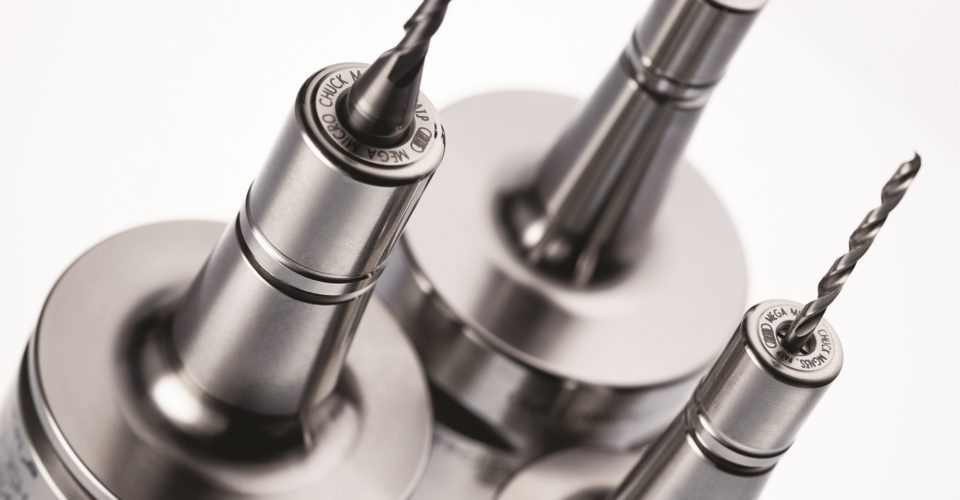

After browsing tooling catalogues in search of holders that could be quick and easy to handle and with dimensions that would allow access to tricky pockets, Marty invited Mark Sazy from BIG KAISER to demonstrate the company’s MEGA Micro Chuck. The chuck’s narrow body, with nut diameters as slim as 10mm, is supported by a shallower taper angle that boosts the holder’s rigidity and limits the extreme angles needed to reach down into deeper pockets.
“MEGA Micro Chucks were designed for the exact scenario Cory was dealing with in the prototype lab,” said Sazy, who specialises in value-added sales at BIG KAISER. “The prototyping lab is a place where everything is under a microscope in a way. All eyes are on the details. It was great to have the opportunity to demonstrate our tools under those conditions—that’s where the value is evident, with what we refer to as the ‘economy of quality.’”
Marty decided to purchase one package of 15 MEGA Micro Chucks to use with all of Trek’s cutters 6.35mm diameter and under. “The quality of the tool holders themselves was just phenomenal, better than I’ve seen on any tool holders before,” Marty said. “The finish on every single surface of the holder is just fantastic and that just screams quality when you pull it out of the box.”
The slim nut and simple collet clamping turned out to be the best of both worlds for Trek, according to Marty. “The MEGA Micro Chucks have the same profiles and shapes of shrink-fit holders with the versatility of collets. You can use any size shank you want. They’re balanced a lot better, so they don’t vibrate as much as the ER 32s that we were running previously.
The extreme tilts the programming software once had to adjust for, have been eliminated. “I’d say probably 50 percent of our reach issues were resolved just by changing holders without manually changing the way things are programmed. The machine only has to tilt maybe 10 degrees out of the way to get down into the pockets. We’re able to reach into places we weren’t before without extravagant, cobbled-together extensions – and all with higher speeds, feeds, and finishes.”
