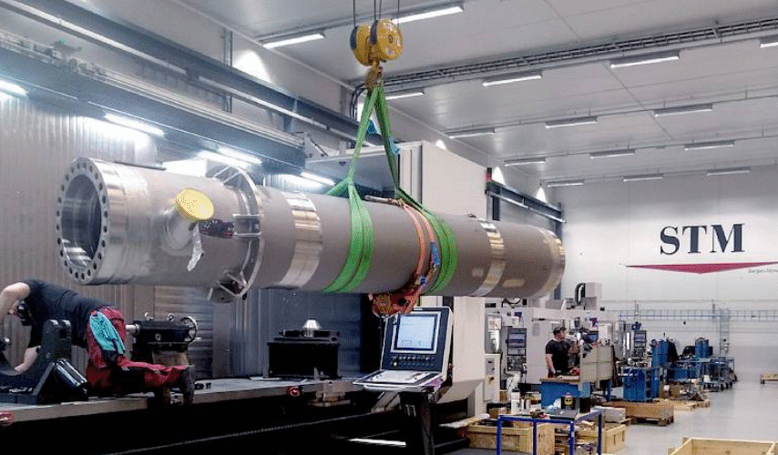

Norwegian manufacturer STM, a specialist in high-precision components for the Oil & Gas industry, has recently expanded its machining capabilities with the installation of an IBARMIA ZVH60/L6000 MULTIPROCESS machine — an advanced and highly customised solution that delivers exceptional flexibility, stability, and power.
Based in Bergen, STM selected this particular machine configuration to meet the rigorous demands of machining complex components from challenging materials like 316L stainless steel. The project was successfully delivered in collaboration with KASPO, IBARMIA’s distributor in Norway since 2012.

Together, these features enable the ZVH60 to perform a wide range of processes, from vertical and horizontal turning to complex 5-axis milling, using special heads and long tools — all on a single platform.
Stable Cutting and High Precision
One of the most notable achievements from this installation is the performance of the long boring bars on difficult materials. STM reports “exceptional cutting stability and perfect surface finishes,” highlighting the machine’s rigidity and vibration-damping performance.
Utilising Edge Cam and tailored post-processors, STM has been able to exploit the machine’s full capabilities, including simultaneous turning and milling operations using A and C axes.
