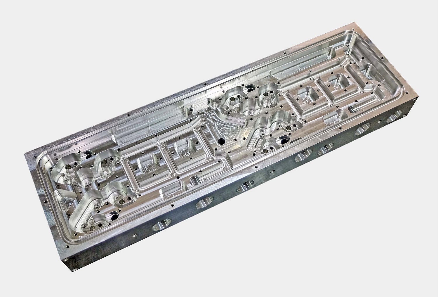

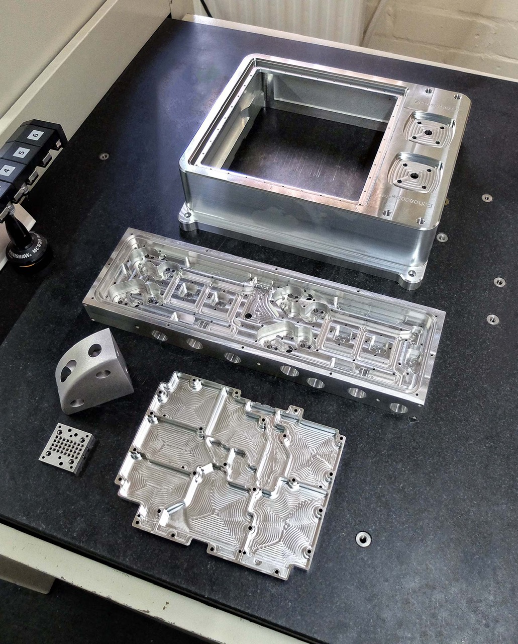

Mr Blues mentioned an underwater camera housing milled and drilled from solid aluminium on the top and sides in two operations on the VMX30i in a cycle time of one hour and 20 minutes, half of which was taken up by engraving lettering imported via DXF. Inspection on a coordinate measuring machine verified that 5 µm flatness and 20 µm parallelism and perpendicularity are achieved.

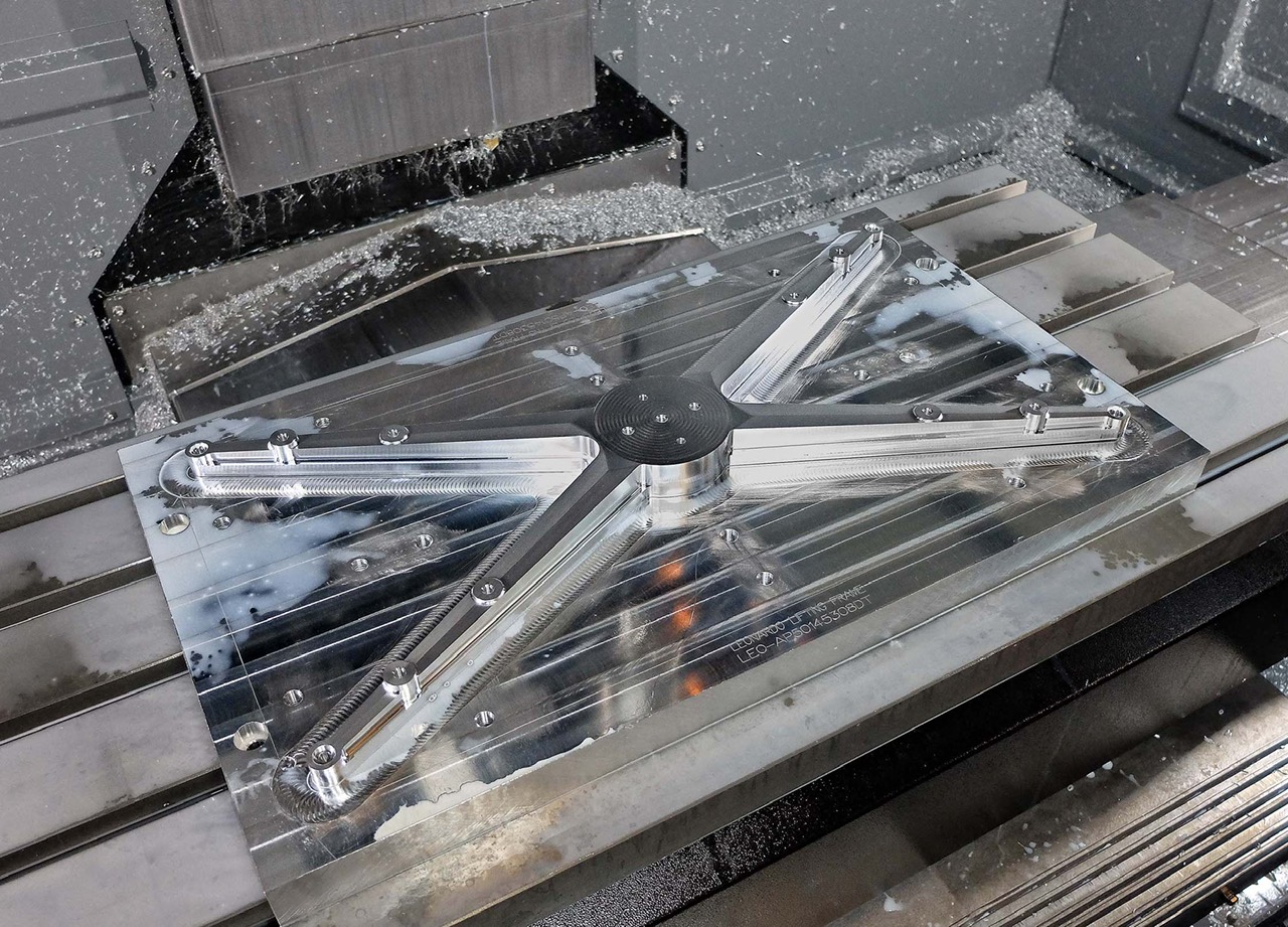

Another example he cited of DXF input involves the complex pockets of an aerospace component with a 0.8 mm base thickness, designed in BobCad running on a PC on the shop floor. It ensures there are no errors in transferring the profiles. An instance whereNC Merge proved useful was in the production of a different aerospace part, a lifting frame, whereby the simple basic 2D shape was programmed conversationally in WinMAX but a DXF file needed to be imported to define the draft angle of four radial arms.
