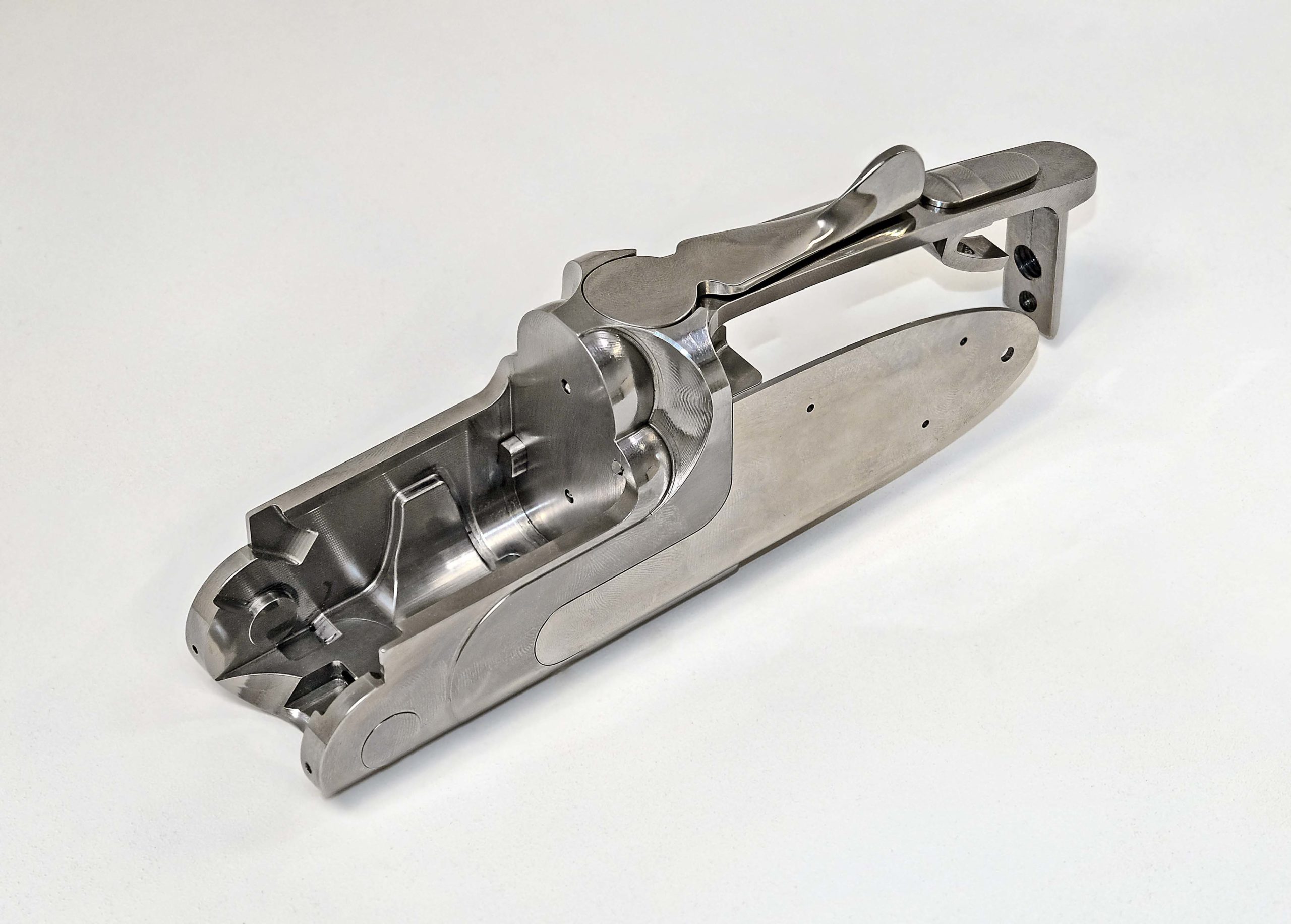

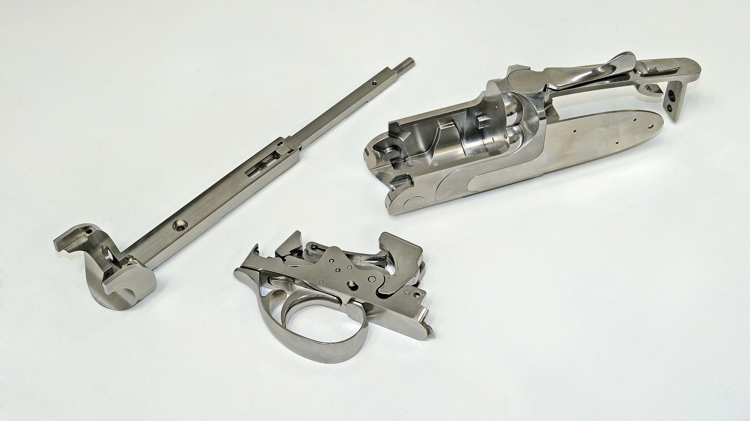

With that knowledge and having an antipathy towards the mild steel parts on his own shotgun rusting, he decided to design and construct a new version from a special blend of PH17-4 hardened stainless steel. It is particularly difficult to machine, as it is a sticky material requiring very sharp cutters yet has a hardness of 38 HRc and above, which tends to wear them quickly. To make matters worse, small drills are involved in the production as well as milling cutters down to 0.6 mm in diameter.

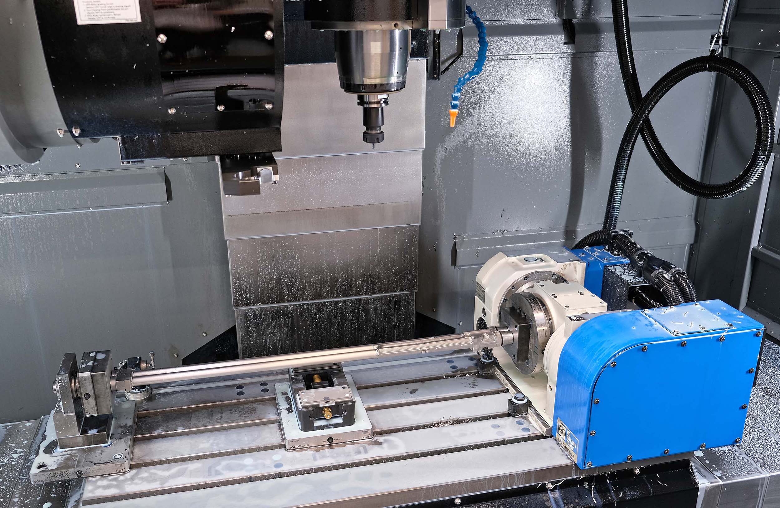

Hurco offers two main styles of integrated 5-axis vertical machining centre (VMC), one with a swivelling trunnion supporting a rotary table and the other with a B-axis spindle and a horizontal rotary table. Neither design was suitable for RIMD, as it would have been impossible to mill the outside of the one-piece shotgun barrel from a 76 mm diameter, 900 mm long billet without buying an excessively large machine.
The answer was to purchase a Hurco VMX42HSi 3-axis VMC equipped with a Kitagawa 2-axis compound rotary table positioned at the far right hand side of the machining area. The latter enables the 900 mm barrel billet, which has already had the two bores roughed and finished on the DSG, to be fixtured by picking up on the bores and rotated. The entire outside can then be milled along its length using the VMC’s one-metre X-axis. In the process, the barrel is reduced to about 1.2 mm wall thickness and 1.4 kg, just five percent of the original billet weight of 28 kg.
The machine is equipped with an 18,000 rpm spindle, so very high surface finish is achieved. Linear scales provide ultra-precise feedback of the orthogonal axis positions to the control. The table additionally feeds its rotary positions back to the proprietary Hurco WinMax CNC, which is capable of controlling all five axis motions simultaneously. Many such programs are employed in the production of components for the Chiltern gun, all of which come off the Hurco in one operation to within 5 microns dimensional accuracy on all critical features.
