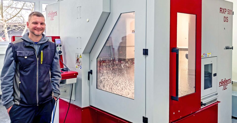

BCE Special Ceramics GmbH in Mannheim has now successfully broken this barrier using a high-speed (42,000 rpm) Roeders RXP 501 DS trunnion-type, 5-axis machining centre. It is achieving the required micron-levels of precision by milling as well as grinding, reducing cost and allowing more sophisticated machined features. Hurco Europe, the UK and Ireland agent for the German machine manufacturer, describes the technological advance.

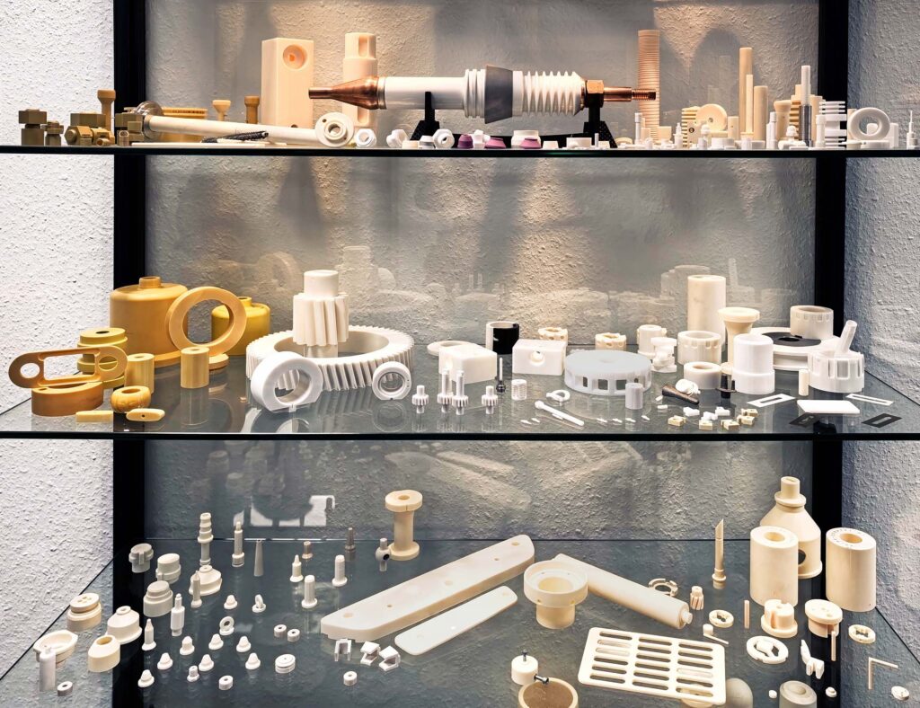

Founded in 1986, BCE specialises in high-precision components made from ceramics such as aluminium oxide, zirconia, and composite ceramics like ATZ (alumina toughened zirconia) and ZTA (zirconia toughened alumina). The company serves industries ranging from medical to aerospace, producing custom parts from single prototypes to medium-size series. Larger volumes are outsourced to specialist partners.
Each application is developed in collaboration with the customer’s R&D team. The process begins by selecting the optimal ceramic material, sometimes modified with additives for enhanced properties like conductivity, or compatibility with metals and plastics.

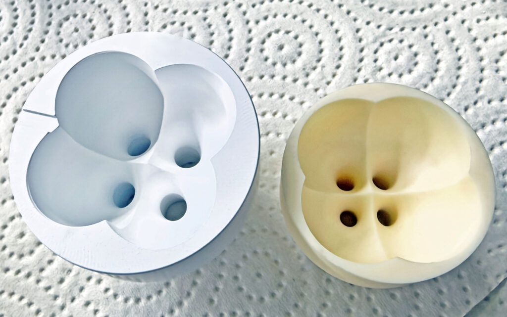

Production in Mannheim begins with pressing a ceramic powder mixed with a small amount of organic binder into a green compact. This fragile but machinable part is strengthened through cold isostatic pressing at around 2,000 bar. It is still relatively soft and must be oversized by about 20% to compensate for shrinkage during sintering.
_cuva
Subsequent firing at a temperature between 1,300°C and 2,000°C removes the binder and fuses the ceramic particles into a dense, durable structure with only 0.5% porosity. After sintering, these ceramics possess outstanding hardness, chemical resistance and temperature tolerance down to absolute zero. However, their hardness presents a machining challenge.

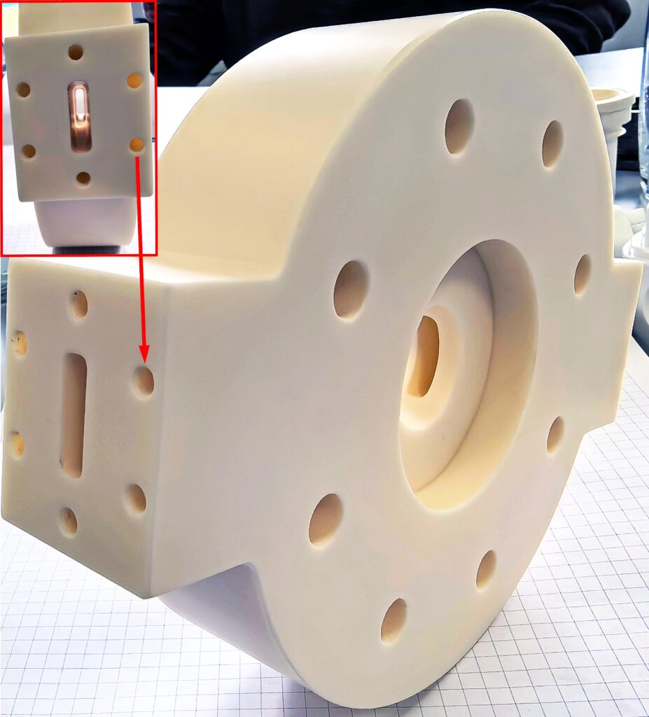

Historically, grinding was the primary method for machining sintered ceramics, especially when precise sizing was needed. In BCE’s applications, for simpler 2D and 2.5D geometries, predefined grinding cycles using mounted points exchanged from the tool magazine are frequently used. Milling cutters and drills are utilised for more intricate 3D geometries and free-form surfaces that are difficult or unfeasible to grind.
Dr Torsten Prescher, application engineer at BCE said, “When we researched the market for machining centre platforms able to mill as well as grind our ceramic materials, Roeders stood out for its in-house development of control systems and machine components, which allow unmatched contouring accuracy. The roundness of our machined holes is to within one micron, for example.”
_cuva
Roeders machining centres use direct drives, robust linear guideways and protective sealing to avoid ingress of abrasive ceramic dust. Both manual and CAD/CAM programming is supported, allowing operators to choose the most efficient workflow. The machine is supplied with built-in grinding cycles, a dressing spindle and acoustic sensors for process monitoring. Through-tool cooling of the cutting zone using an emulsion at pressures up to 80 bar ensures tool longevity and machining accuracy, which are particularly important when using small-diameter tools.

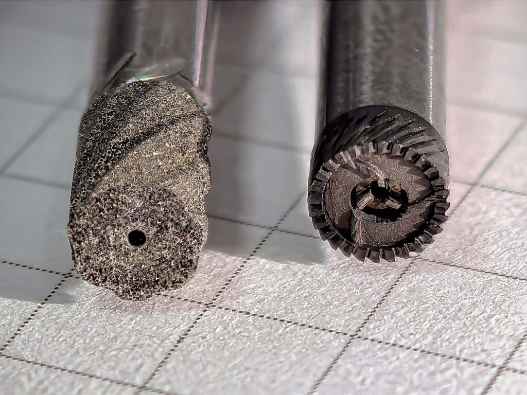

BCE partnered with high-performance tool manufacturer Zecha to address the challenges of milling ultra-hard ceramics. It supplied custom polycrystalline diamond (PCD) and diamond-coated carbide tools designed for high-wear, high-precision requirements.
Fabian Henning, a mechanical engineer at the Mannheim factory, despite coming from a Siemens control background, found the Roeders system intuitive to operate. For simpler 2D and 2.5D components, he often programs NC grinding sequences directly at the machine. The Roeders control not only uses its own grinding cycles, but also retrieves parameters from an internal machining database to speed programming. For more complex geometries, Mr Henning uses a seat of VISI CAM to create 3- or 5-axis milling cycles.
He said, “Machine reliability and after-sales service were key for us when selecting the machine. In three years, we’ve only had one breakdown – a defective sensor which was replaced the following day.”
