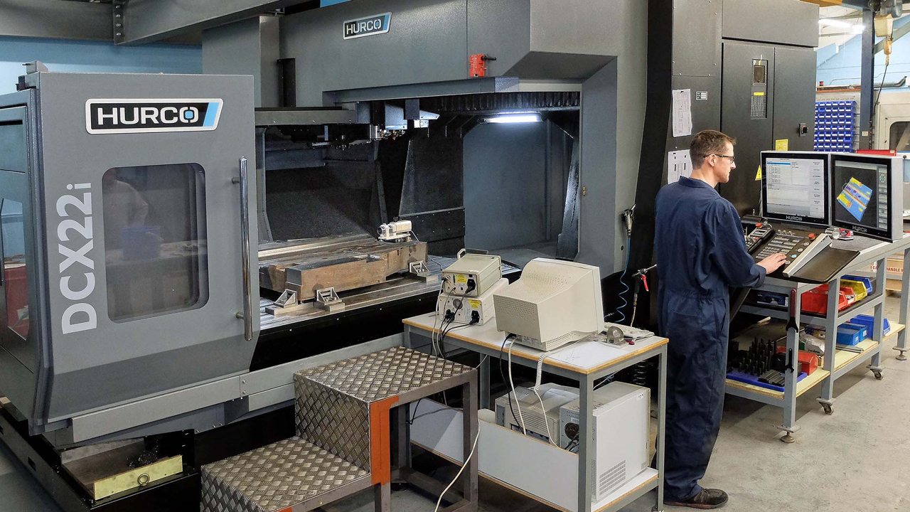

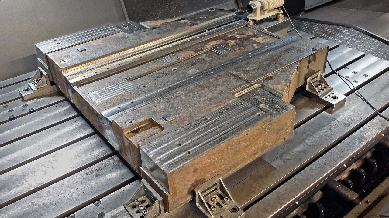

Previously, larger castings that form the bases of Loadpoint’s products had to be subcontracted out for milling. That cost is now saved, added to which control over lead-time and quality is much improved. Drawing tolerance is ± 5 microns for both straightness and flatness over the 750 mm length of the largest base casting for a Loadpoint Macroace dicing saw. This accuracy is being exceeded on a 20-tonne, bridge-type Hurco DCX22 machining centre with 2,200 x 1,700 X 750 mm working volume.

A one-metre deep concrete foundation was prepared to support the DCX22. Hurco engineers spent considerable time and effort during the commissioning phase to ensure that the required machining accuracies could be attained. They are verified using a Taylor Hobson autocollimator.
Mr Bond went on to explain the technique that allows tolerances within ± 5 microns to be held over such a large distance. The secret lies in unclamping the heavy casting and simply restraining it in position on the table during the final operation, which involves taking only very light passes with a milling cutter. The process was successfully proved out at a Midlands subcontractor using a similar Hurco DCX machining centre prior to Mr Bond’s investment decision.

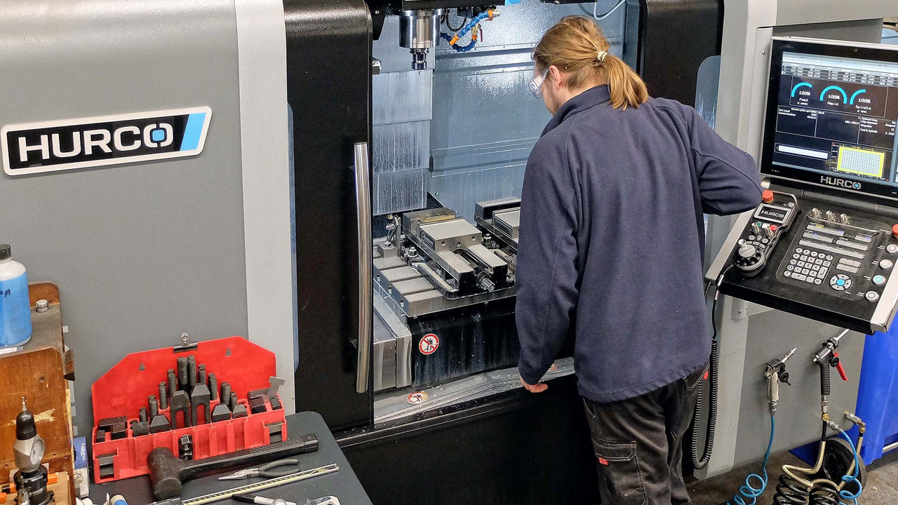

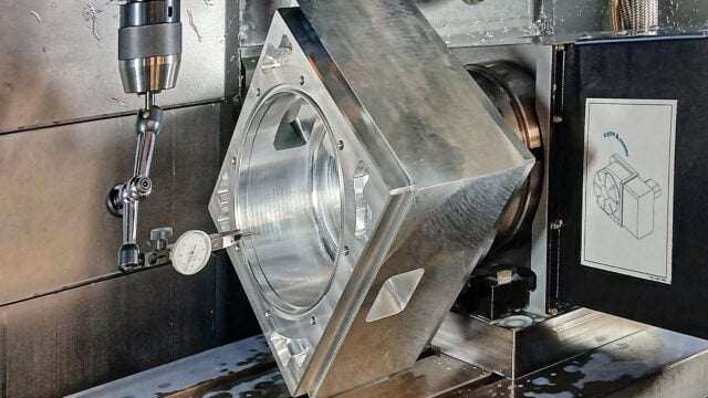

Another role of the new lathe is to turn a stainless steel disc that forms the carrier for a vacuum chuck that secures material during dicing. After heat treatment, the component is held in a bespoke fixture on the third new Hurco machine on-site, a smaller VM20i 3-axis machining centre, where recesses are milled over one face for subsequently containing the adhesive that holds a high precision, ceramic insert in place. Many of Loadpoint’s smaller castings and components are also produced in the VM20i, which replaced a manual-tool-change CNC mill.

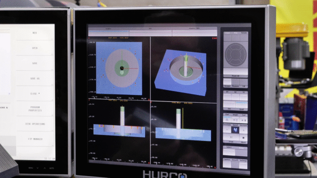

Machinists at Cricklade were familiar with Heidenhain and Fanuc controls, so there was initially some scepticism about using a new CNC system, Hurco’s own WinMax, which employs a second screen on controls fitted to the manufacturer’s larger machining centres. The system has a reputation in the market for ease of conversational programming. Mr Bond confirmed that his operators were immediately convinced of its suitability during a demonstration at a Hurco open house held in the company’s High Wycombe showroom and technical centre.
Such is the software’s ease of use that menu-driven programming on the shop floor using the touch-screens on the controls is carried out all of the time at Cricklade, to the exclusion of offline program preparation via CAD/CAM, even though Loadpoint machine components are created in CAD and available as solid models.
