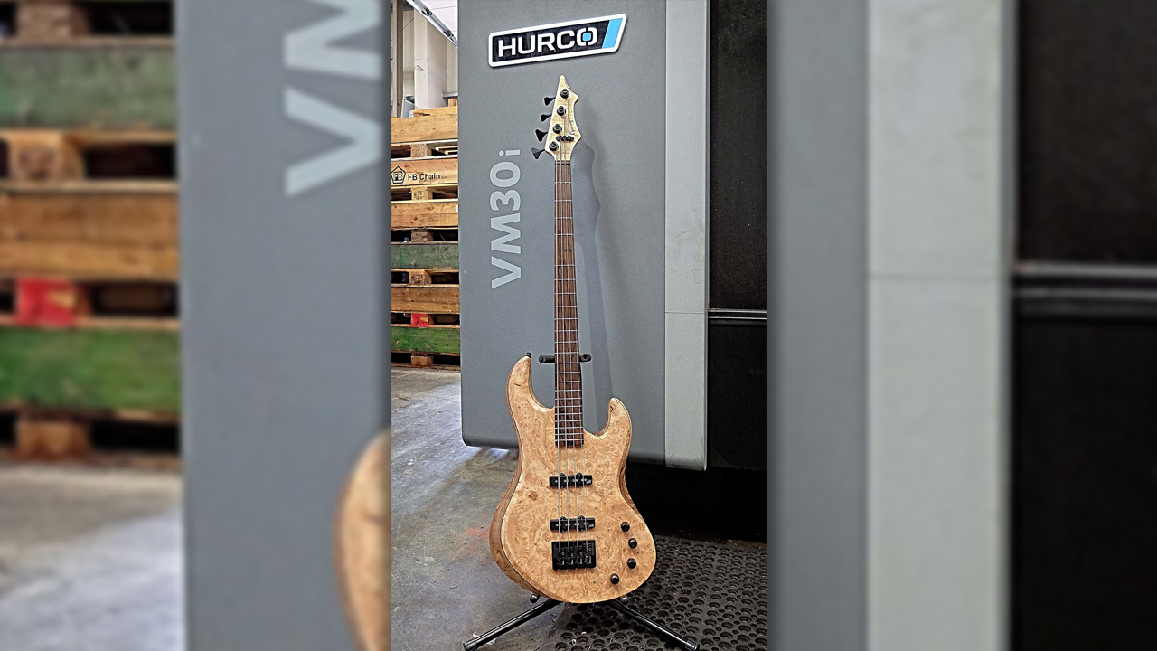

On Saturdays and Sundays, Hi-Spec’s owner Darren Grainger and his brother Gavin indulge their lifelong passion for music by milling electric guitar bodies from solid wood. Initially they used CAD files downloaded from the internet but latterly have produced five designs of their own, including one for a bass guitar. It is a hobby that is proving lucrative, as some of the instruments sell both at home and abroad for up to £3,500 under the brand name Grainger Guitars (www.graingerguitars.com), owned jointly by Gavin and Darren.

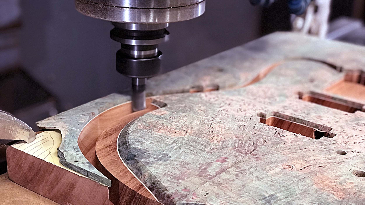

“All that’s needed is to wipe down the machine table on Saturday morning and block off the coolant nozzles to prevent ingress of sawdust. When we’ve finished profiling wooden components, we simply vacuum out any wood residue, clean down the machine, uncover the coolant holes and we’re ready to cut metal again on Monday morning.”
A large and exotic array of woods is used in the creation of the guitar bodies. Early materials were maple, alder and poplar, but lately the Grainger brothers have introduced swamp ash, mahogany, ebony, wenge, walnut, buckeye burl, limba, purpleheart and some wood/resin composites. Pearl and stone materials are also machined on the Hurcos for the marquetry inlays.
Router cutters were used at the outset but solid carbide end mills and ball nose mills designed for machining aluminium were found to produce a much better result, as the sharpness of the cutters virtually eliminates burrs and produces a fine surface finish. It is consistent with the final use of ultra-fine, 2000 grit sandpaper with an average particle diameter of 10 microns to smooth the wooden components prior to the application of multiple coats of gun barrel oil to achieve a lustrous finish.

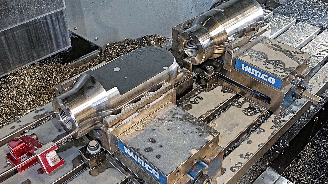

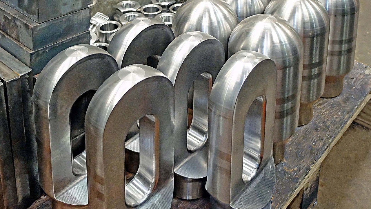

“In some instances, we have more than halved cycle times. For example, we produce batches of 38 puller ends for hydraulic tooling two at a time from EN24T billets in two operations on the VM30i in a cycle that previously took more than four hours.
“Now, taking a 16 mm depth of cut with a solid carbide, 12 mm diameter end mill at 6 m/min feed rate, and using Hurco’s twin nozzle coolant delivery together with the standard air blast facility, which incidentally is used on its own when machining wooden components, the same job takes approximately two hours.
“In another case, production of a steel matrix used to take 40 and 35 minutes for ops 1 and 2 respectively, which have been reduced by an even greater percentage to 17 and 12 minute cycles.”
