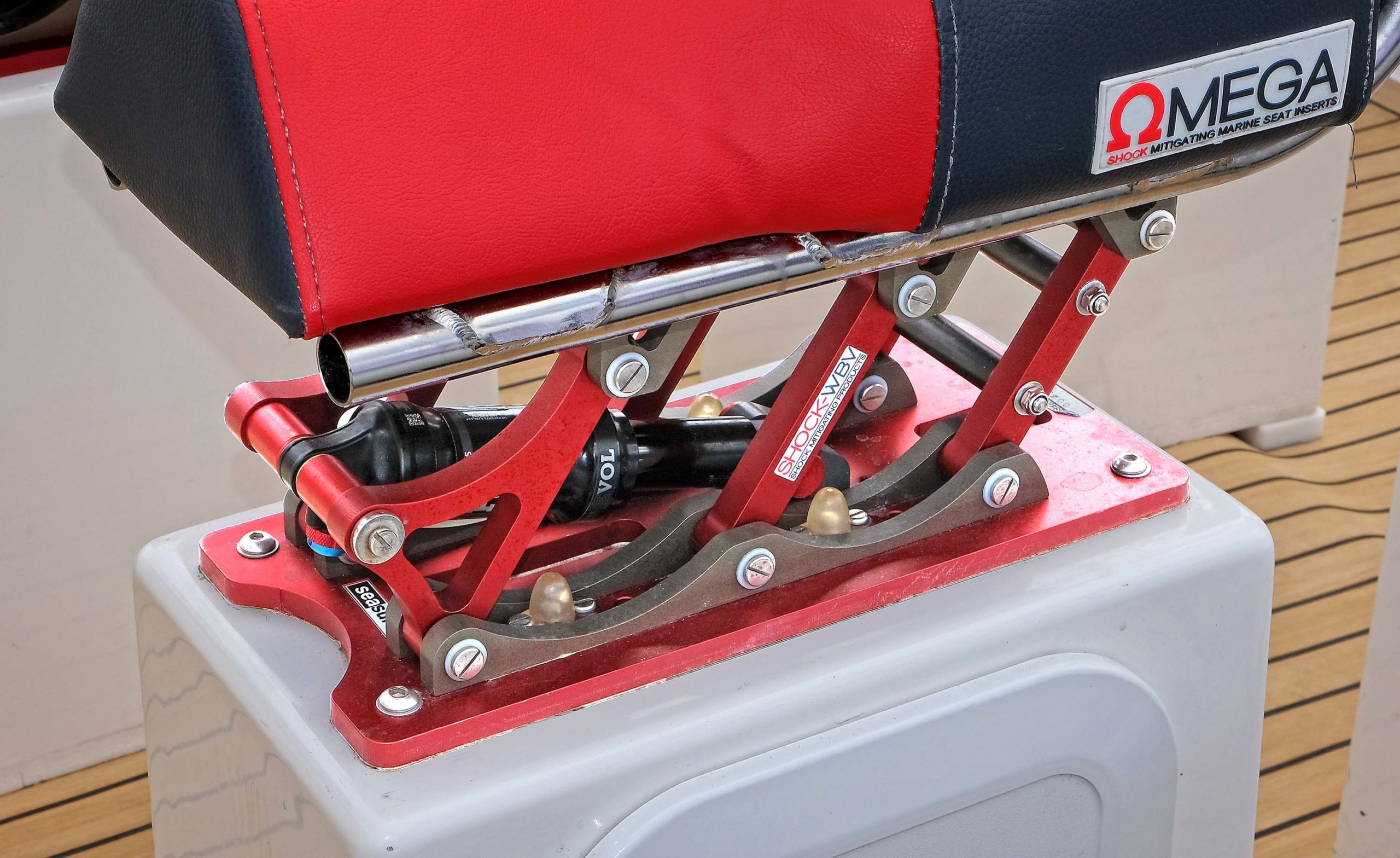

Graham Brown, managing director of Sea Sure Ltd (www.sea-sure.co.uk), a boat fittings and accessories design, development and manufacturing specialist in Warsash, Southampton, bought his wife Judith a Merry Fisher powerboat nearly 10 years ago. It was intended for relatively smooth conditions in lakes and inlets but she wanted to cross the Solent to the Isle of Wight over waters that are much choppier, despite it being one of the most sheltered channels in Europe.

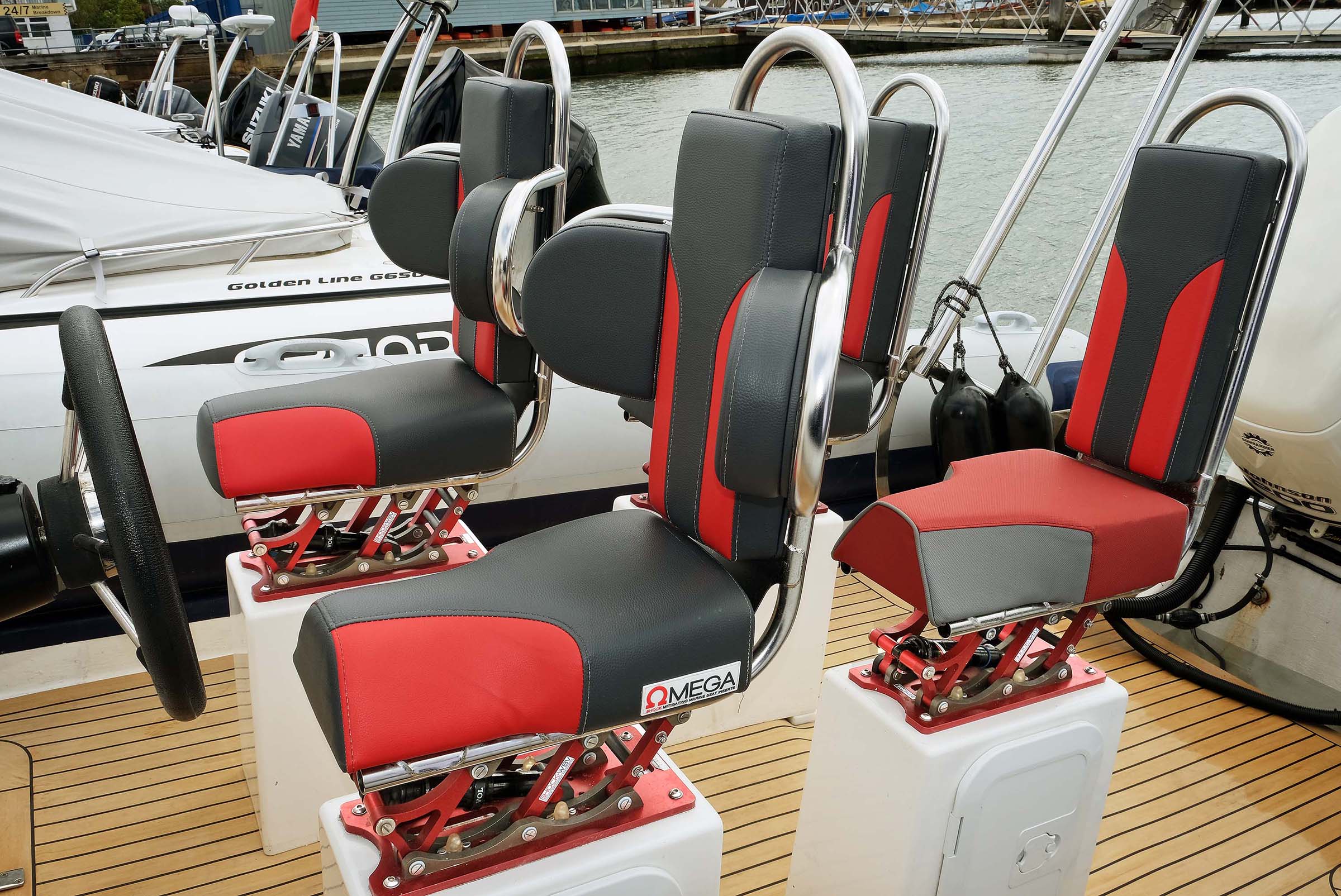

The buffeting she endured when seated in the boat and her observations on how useful it would be to have a suspension system under the seat were the start of a new venture that looks set to transform the fortunes of Mr Brown’s company. The shock mitigation product range, SHOCK-WBV, he went on to develop was a difficult project, as jolting in a boat is complex and in multiple axes and the motions have to be monitored by on-board accelerometers to more than 10g at elevated speeds. The full mitigation solution now includes cushioning in the seat upholstery as well.
Today, sales of three versions of SHOCK-WBV, which were introduced five years ago, account for 10 percent of turnover but it could easily become three-quarters within the next few years. Boat builders around the world are ordering them in quantities of up to 300 at time and there is also a big retrofit market, including on the company’s doorstep along the busy River Hamble. In powerboat recreational use and racing globally, the suspension systems that Sea Sure was instrumental in creating are becoming increasingly popular and the firm currently has a two-thirds market share.

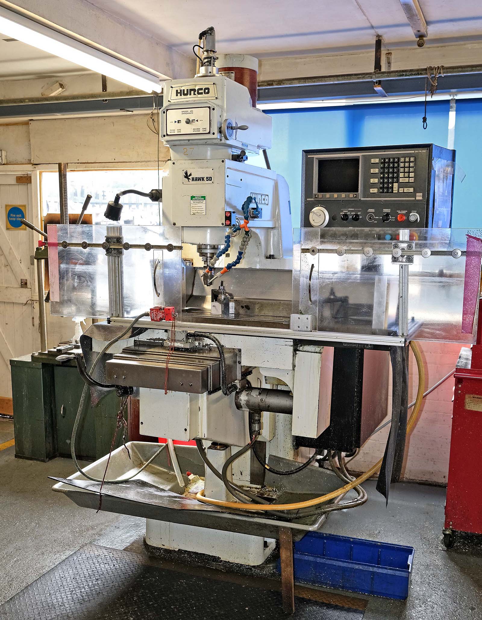

A Hurco (www.hurco.co.uk) Hawk CNC knee-type milling machine had been the mainstay of all prismatic machining in the Warsash factory, both for prototyping and production, since it was purchased second-hand in 2012. Travel restrictions due to the coronavirus pandemic has tended to keep people all over the world within their own countries and given them more time to enjoy pastimes such as boating. Consequently, growth on the shock absorber side of Sea Sure’s business has quickened and so also have deliveries of the company’s 2,000 catalogue items for all types of small craft.

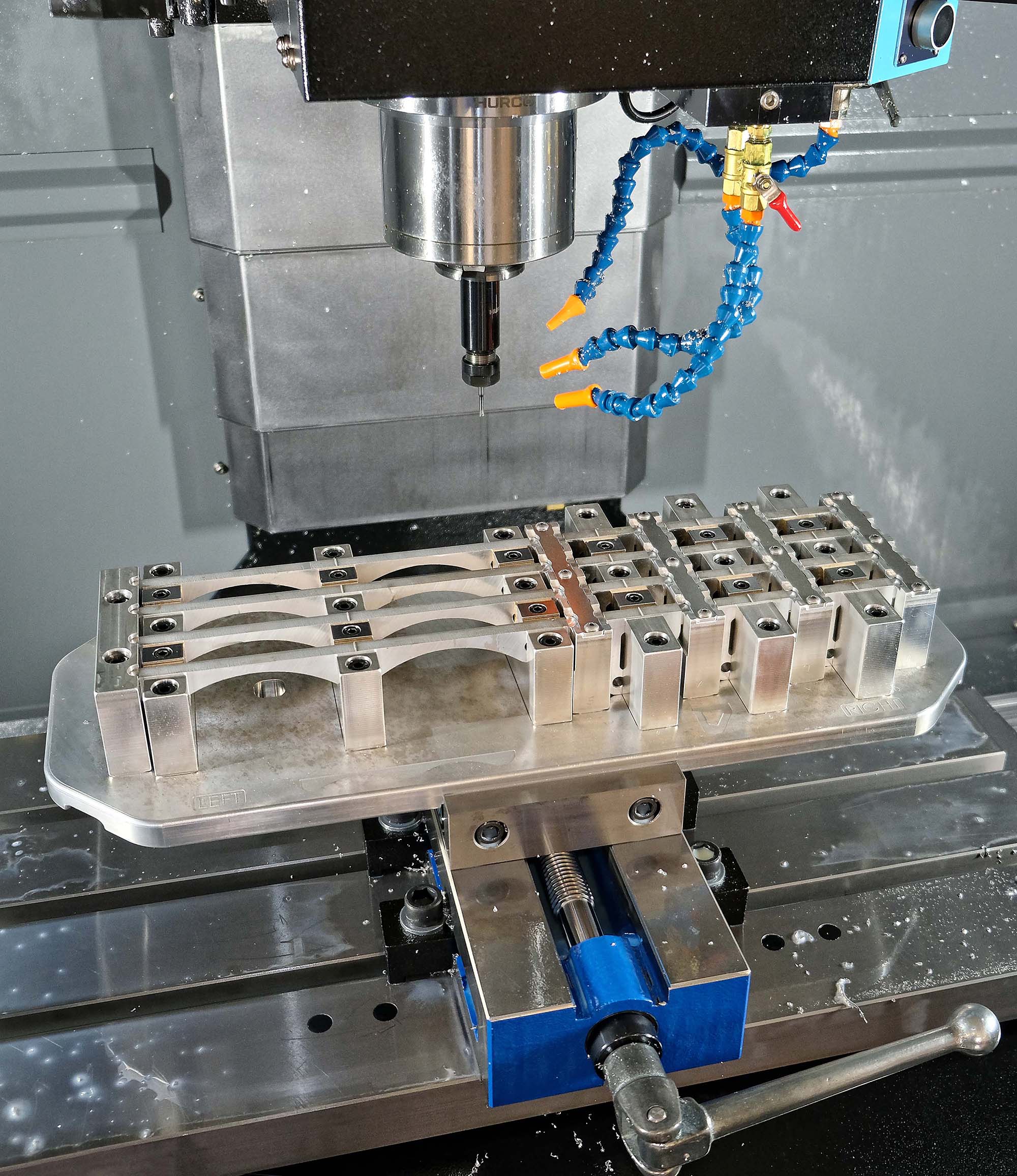

“We now fixture a complete kit of 10 mm and 15 mm thick billets of waterjet-cut aluminium tooling plate and other raw material for one of our shock mitigation products so they can all be machined in one hit on the new Hurco.
“It saves set-up time and shortens overall cycles due to fewer tool changes. Just half an hour is needed to machine everything under the spindle and that includes thread milling more than 40 holes of 4 mm diameter.”
