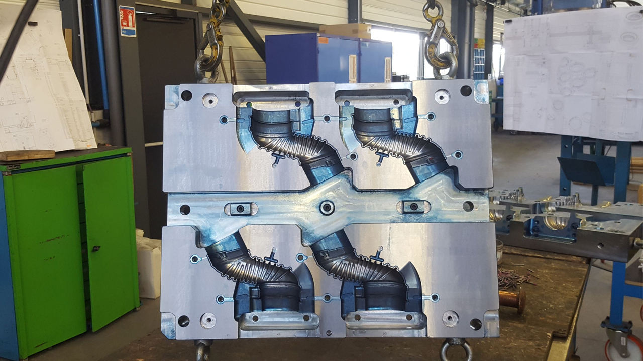

Their main business is designing and manufacturing tooling equipment, and manufacturing moulds for all-rubber bonded inserts, and plastic, metal and rubber parts. Managing Director Gérard Beloeil says these can be injection, compression, regulated transfer or cold plate moulds produced in different grades of steel; pre-treated, hardened, and with a special coating.
“The finished parts are used to support gearboxes, engines, exhaust pipes, suspension systems, engine sealings, and soundproofing.”

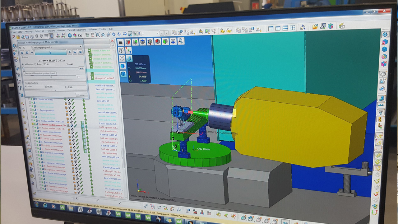

About three-quarters of the total production goes through WorkNC, which Milling Sector Manager Fabrice Provost says is fundamental to ensuring that the moulds coming off the machine tools are of the high precision required. “The software’s 3D functions are particularly important to us as we use 3+2 axis machining, but can’t program 3D manually. And since new enhancements have been made for 2D operations such as manual and semi-automatic drilling, we use all 2D toolpaths as they’re now more flexible.”
WorkNC programs three Huron and two Mazak vertical milling centres, and two Mazak horizontal palletised milling centres to produce the moulds and blocks, along with one HSM milling centre for machining electrodes. “It’s this software/machine tandem that allows us to achieve a high level of precision. The two go hand in hand.”
Initially, the mould CAD files are sent to the Engineering Department to check the project’s feasibility and to determine the different steps required to produce the tool. Each part of the mould is identified and listed, and a bill of materials is inserted into WorkPLAN. Based on that information, a set of documents is generated, containing full details about the mould, which will be used by the purchasing document and shopfloor, allowing work to start on tooling elements. Machining information about the mould’s individual components means the milling and turning team can assign them to specific machines, and the files are opened in WorkNC for the toolpaths to be programmed.
“Our programmers often use standard WorkNC toolpaths such as 3-axis Finishing and Contour Remachining, which we find perfect for producing a high-quality finish on curved surfaces where there are no right angles. And the comprehensive Global Roughing functions are extremely efficient, producing exactly the results we need.”

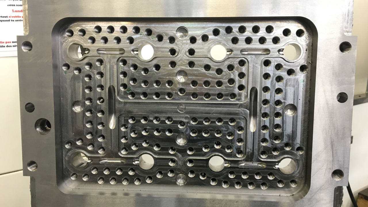

Even though some parts they produce are similar, all moulds manufactured by Dixence are different. Generally, they make two new mould tools each week. They also produce one cold runner block, which is positioned on the mould, meaning they can multiply the number of injection points for rubber-based components. “An important feature of our process is that we design a cold runner block for each project, so it is specific to each mould. This offers a means of reducing material costs for our customers, especially as rubber can’t be recycled.”
