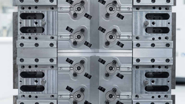

Operating with 12 employees, the company produces an average of around 40 tools a year, ranging in size from 100mm x 100mm x 100mm, up to 600mm x 1-metre, mainly for the automotive, medical, packaging and electronics industry sectors.

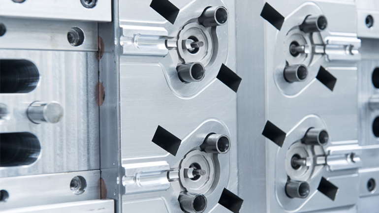

Two of their current projects: Producing a number of high cavitation tools for one of their many medical customers; and a contract for two-shot plastic injection tools, which involves an overmould. “Although two-shot production adds another element by involving a second material and process, VISI keeps it simple and efficient.”

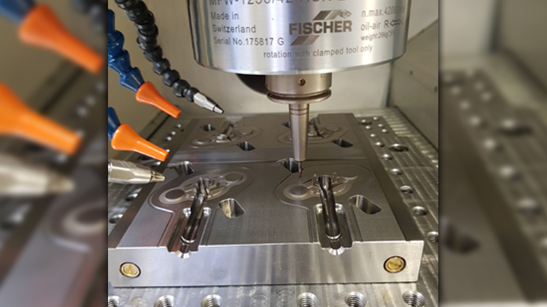

With VISI programs running their high speed milling on Röder, and F3 and F5 Makino machining centres, the challenges posed by the medical industry requiring very fine micro levels, are readily overcome.  “We use high-end 42,000 rpm spindle speed for very small detail finishing, and cut our electrodes on the Makino F3, with high definition being done on the F5. And we can also machine a cavity in just one night, that would otherwise take a week. Using VISI Machining we can quickly produce a highly polished medical part with fine detail, a milled finish, and a split line within micron accuracy.”

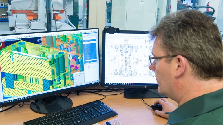

Having invested in many VISI modules including Modelling, Analysis, Flow, Mould, Progress, the wire cutting and electrode systems, along with 2D Milling, 3D Milling and High Speed Milling, the software is used at every stage of their process, beginning with providing an accurate quotation for the customer. “We use VISI’s analytical tools to check the drafts and all the different features we’ll need to build into the mould, such as the core and side pieces.
“When the order’s been placed, we work closely with our customer’s moulders on the design concept, including flow analysis and tool layout. Once the 2D design is broken down and we have the tooling in full 3D we really begin to see the huge power of VISI, which controls everything from design, through milling to wiring in one environment. Because we’re not going across translators there’s a perfect understanding within the technology, taking it right through every stage.”
