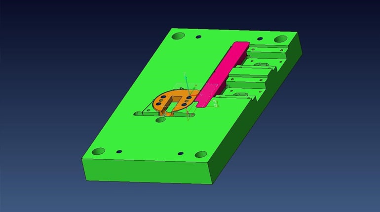

He says their process begins with the plastic component – whether they are producing the tool for another moulder, or to run on their own moulding machines. “A big advantage of VISI is that we can check the model’s integrity before we start. It’s got a variety of tools to ensure that all surfaces meet up, because if we’re trying to work with a poorly designed model, the mould tool won’t work.
“I check the features with the draft analysis function, making sure it has relevant draft tapers, and then move on to the design. As VISI has a large library of materials with all their specs and characteristics it’s simple to apply shrinkage to the particular plastic I’m working with.”

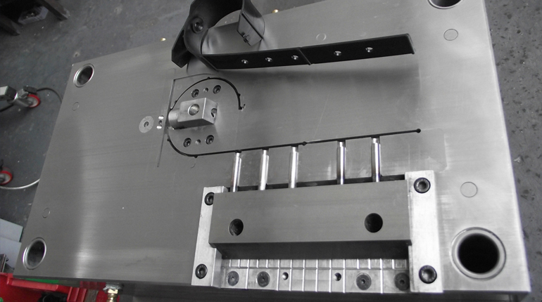

And he says core and cavity separation is quick and easy, even with varied split lines, as are sliding block and tricky shot out areas. “I make either the fixed half or moving half transparent onscreen, so I can look inside and ensure the faces are touching, and that everything fits and works properly.”
Once he is happy with the split he subtracts the part out of the inserts and establishes the insert size around it. While VISI automatically picks the mould base when the insert and part are complete, he is particularly impressed with the speed and accuracy it can be manually tailored if required. “And when working on multi-cavity tools VISI lets me literally copy a completed insert into the next position, and when that operation’s finished it automatically selects the bolster – and, again, there are manual editing tools if necessary.”
He says the feed gate generator and library of ejector pins all help to move the design along at a fast pace. And transferring from VISI’s CAD process to WorkNC for CAM is also fast and seamless. “I put each plate on a different layer, so l have my clamp plate, the fixed half form plate and the moving half form plate all saved as individual parts in native VISI files. As WorkNC reads the VISI files, I simply move them across. I can pull a finished plate design out of VISI, and WorkNC is generating toolpaths for it within a minute.”

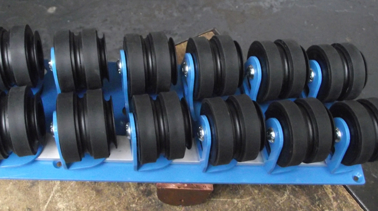

And the contract for the pulley wheel system came about after producing a small clamping block for Axiom GB. “We made around 5,000 parts, which was their first venture into moulding. It was so successful that they asked us to work on the wheels for their conveyor system. We designed the full mould in VISI and transferred the files to WorkNC for machining the bolster, forms and electrodes.”
