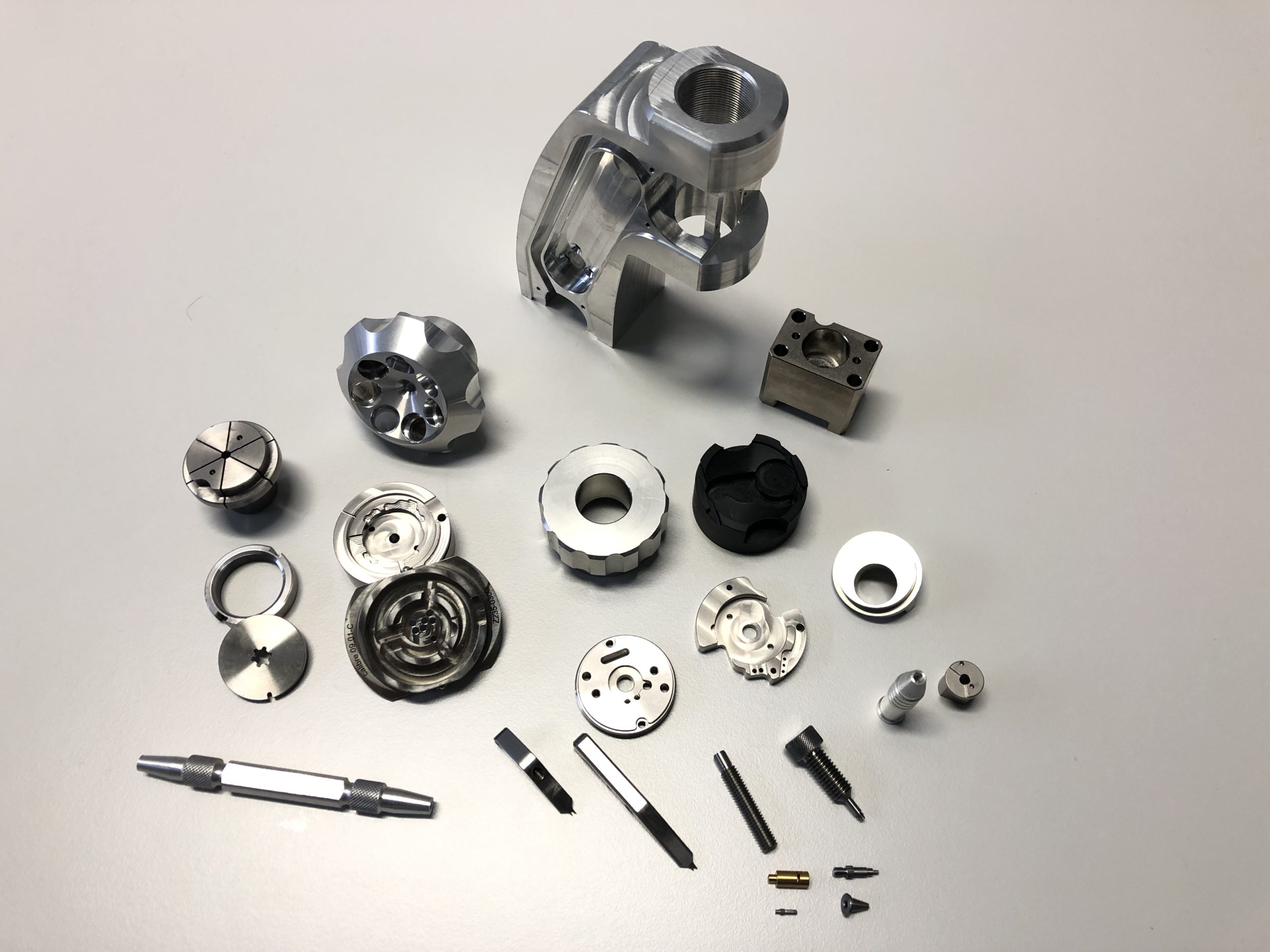

Single watch movement holders are included in their wide range of tools and parts for the watchmaking industry, along with manual tools such as precision screwdrivers. For other industrial sectors, they produce complex metrology and quality control machines, and furniture accessories such as mechanical armrests.

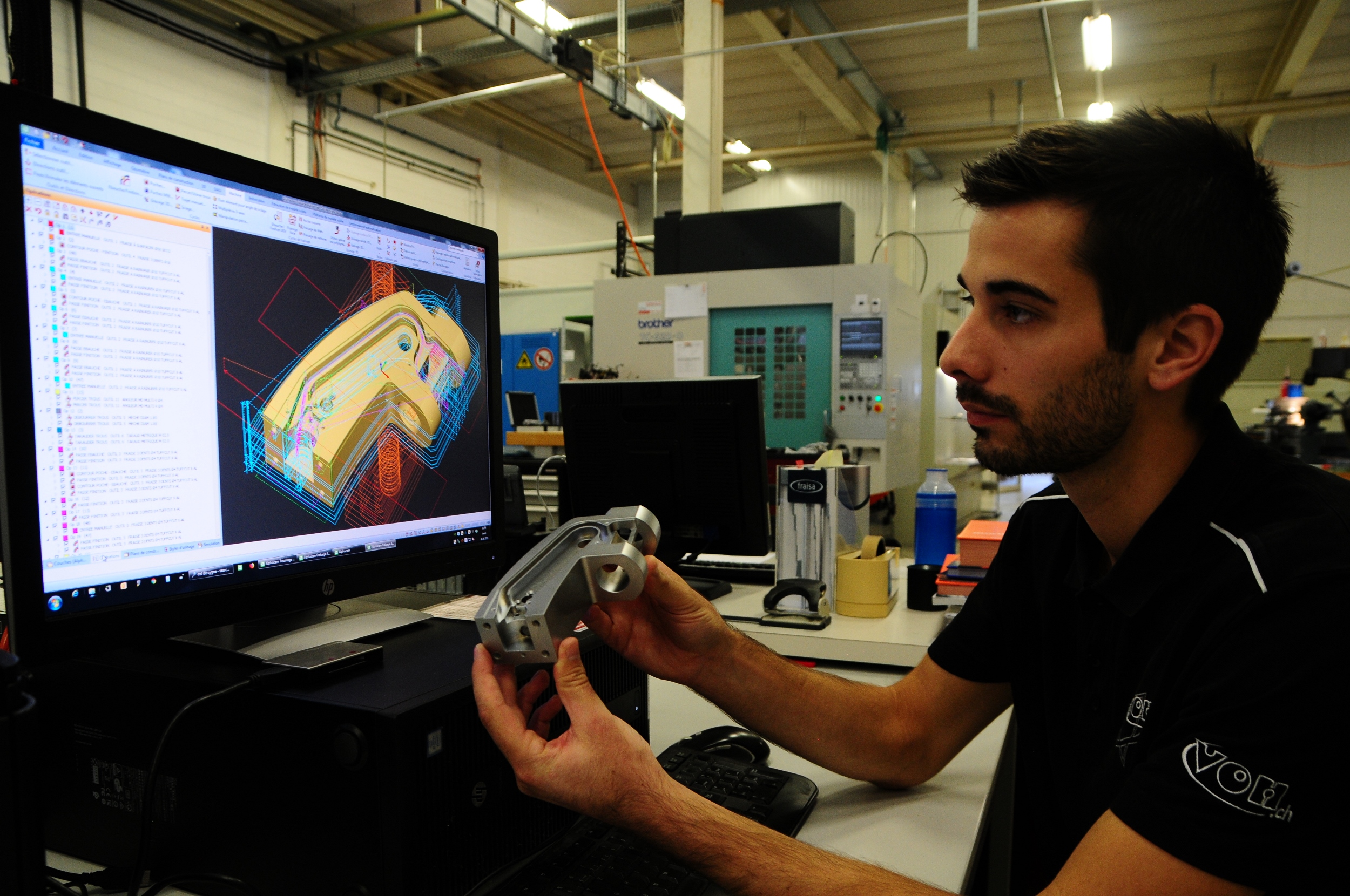

He explains that these new tools have considerably improved the organisation of the workshop, and increased production efficiency. “When I create a new program, it’s now possible to attach the clamps and tool images along with any other photos. Therefore we have a manufacturing file that’s ultra-flexible and easy to set up.”
Now, six months after the changes were commissioned, he says he simply searches for the drawing numbers in the File Manager module, and retrieves them easily. “Then I just need to print the personalised document, and I have all the information I need for the job on one page.  It’s a much easier way of starting the machine set-ups. And, as a result, there are far fewer programming issues.
