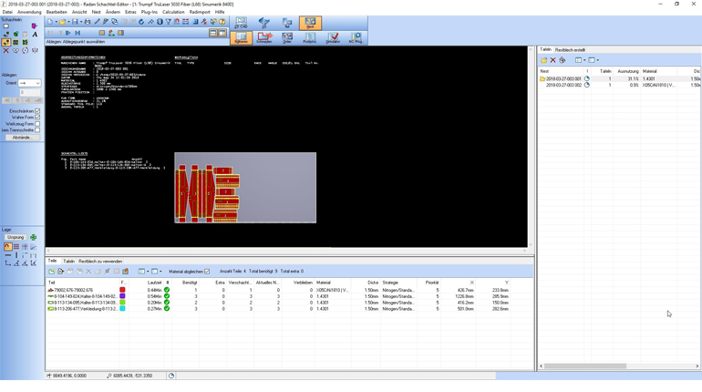

To manage that, Bosch invested in several Radan modules – Radimport, Radprofile, Radmanager and Radquote, which automates most of the calculations. The engineering department produces 3D SolidWorks models which are imported into Radprofile through Radimport, and automatically unfolded, showing laser cutting time and material usage.
“Predefined formulae are then inputted using popup menus for the costs of individual operations on the parts – including bending, straighten, deburring, welding, glass-bead-blasting, drilling, purchased parts, manpower and delivery.
“These calculations fix the price for machining cycle times and all additions,” says Dominik Bach. “The only variable is the hourly rate for our suppliers’ shopfloor workers. But it means we fix the end price we’re prepared to pay each subcontractor, and we can back it up with our calculations produced by the market-leading sheetmetal software.
