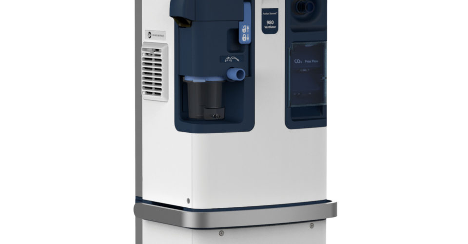

At the start of the coronavirus pandemic, they were contacted by their long-standing medical customer, Medtronic – the global leader for ICU ventilators. They were already manufacturing components for Medtronic’s Puritan Bennett PB 980 and Puritan Bennett PB 840 high performance ventilators at their purpose-built facility in Shannon, Ireland. The ventilators are primarily for critically ill patients requiring high intensive care. Due to the spread of COVID-19, demand jumped to unprecedented levels, and Medtronic needed to produce 500 units a week, instead of 100…which meant Bolgers needed to ramp up their production of individual parts.
