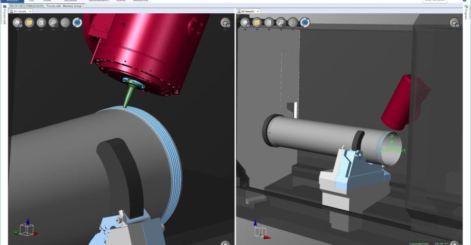

All that changed, though, when they invested in NCSIMUL machine simulation software from Hexagon. This now means he can simulate, verify, optimise and review machine programs, based on the characteristics of the individual parts, cutting tools and the specific CNC machine involved. 3D graphics help him avoid machining crashes, while complex algorithms and embedded process-based knowledge enables cutting conditions to be optimised. “The software reduces time I spend on debugging programs, and eliminates the risk of spindle collisions, tool breakages and scrap, while improving cycle times and process efficiencies.”
One of the largest parts the California-based company produced was on their 5-axis Hwacheon bridge mill. It was a 4.5-metre 7050 aluminium aerospace structural component. “I had it hanging off from one side of the machine while working on the other side, then rotated it 180-degrees to machine the rest of it.”
The first component that he used NCSIMUL to verify the machine G-code for, was on that same machine, with the same metal. “It was a fuel cell cover with several 5-axis features. Now we use it all the time. We can have a program ready within around two hours instead of between 12 and 16 hours. I can have it adjusted. and feel comfortable enough to run it without having to climb up into the machine to have a look. And we no longer have to buy an additional back-up piece of material, so it saves us money there, as well as time, and gives us complete peace of mind.”
Marton Precision now has NCSIMUL packages for eight different CNC machine tools, customised for each machine they are used on. “We have an STL model of the machine from the machine tool builder, which includes control information and other parameters; then we send it to NCSIMUL. They then build the software package according to exactly what we have. NCSIMUL looks at the final G-code that will run the machine, and if there’s an issue with the program I just use the edit mode to make any necessary adjustments.”
Their NCSIMUL Machine module provides machining verification in three steps: it investigates and corrects coding errors; simulates to locate collisions and correct motion errors; and validates the machining result. “As well as the toolpath verification, it also takes the machine’s interior features and tool movement patterns into consideration. With NCSIMUL we know we’re going to get it right first time, every time.”
