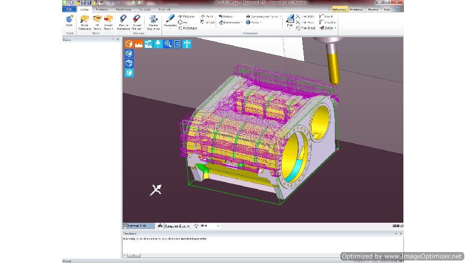

Thanks to Edgecam they are also starting to change how they manufacture certain parts. He says they use a lot of resin cast units for their bearing carriers. “These aren’t as precise as they could be, but because Edgecam is so quick and accurate we can switch to machining them from solid block.
“The ability to move away from castings is really going to change how we work. The market is used to having castings for many components, but we’re now starting to turn that on its head by showing that they don’t actually need castings – the products can be machined from solid block which is far quicker, even though there’s more material to remove.” Where specifically required, Edgecam does machine cast iron, both in round bar and block form.
He says the software’s powerful game-changing Waveform Roughing Strategy is one reason it is so fast. “We were able to triple the feed rates, and have the cutter going in considerably deeper than we could with traditional roughing.”
