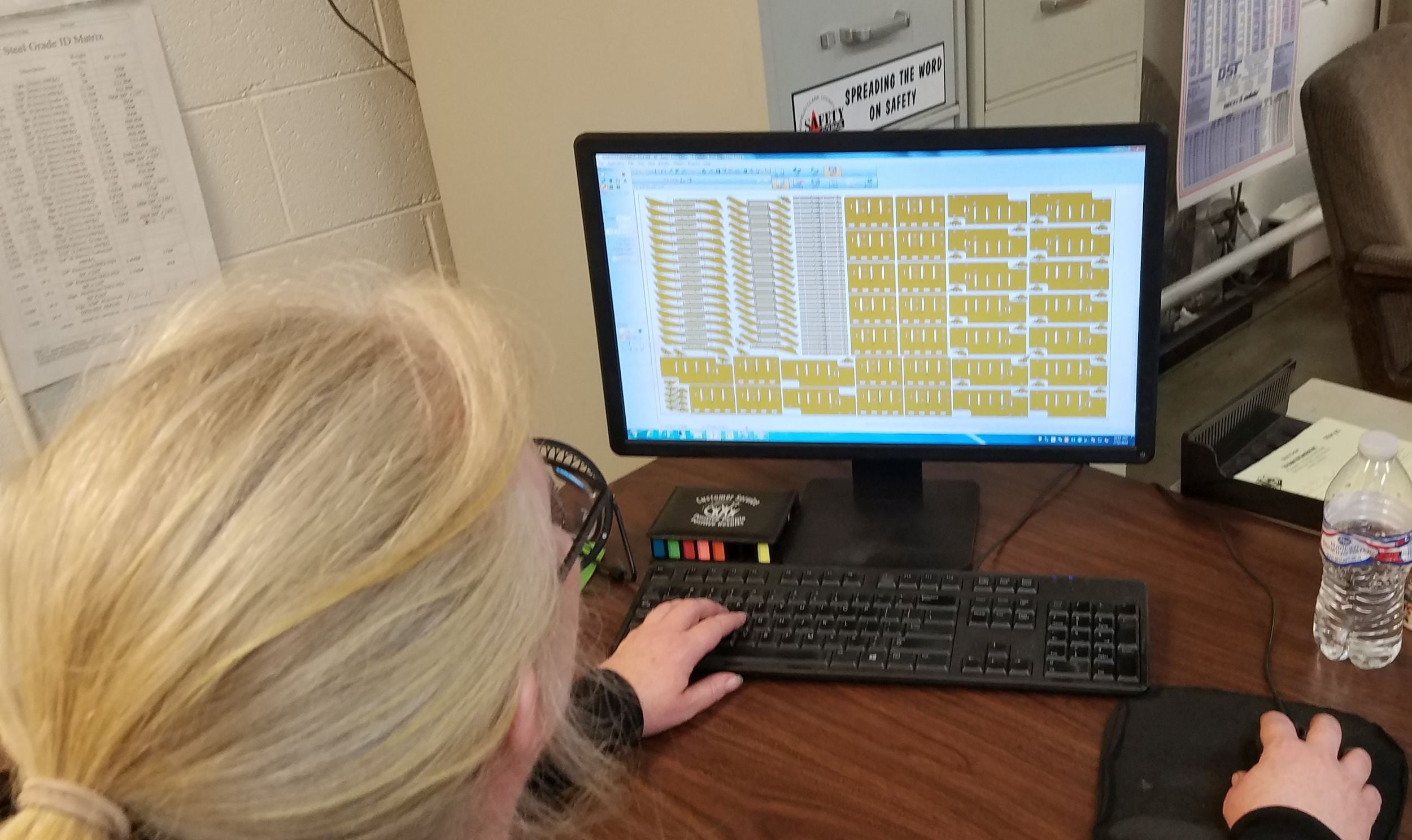

“One of the nicest things about RADAN is that we can program tooling at the part level.” Those are the words of Scheduler and Programmer Sue Conley, of Beach Manufacturing Company (BMC).
“I like this flexibility because, depending on the characteristics of the individual part, it may cut better at a different speed than another one cut on the same material. This ensures that parts set up to cut at different speeds will all cut well when nested on the same sheet.”

As well as programming tooling at part level to allow different cutting speeds on the same nest, the solution’s flexibility extends to its general nesting capabilities, as users are able to edit automatically generated nests if desired. Part and parcel of creating efficient nests for maximum material yield is RADAN’s ability to analyse the true shape, material, and thickness of all parts in a batch. Separating and sorting automatically, RADAN generates manufacturable nests from sheets, off-cuts and remnants to improve sheet utilisation and overall efficiency.
“RADAN’s nesting software helps us select the best option for obtaining the highest yield of production parts with the least amount of time and material,” Sue Conley says. “Once a part has been through the production process and been tooled to cut successfully, the nesting of each part becomes very simple and easy to do, saving us considerable programming time.”
