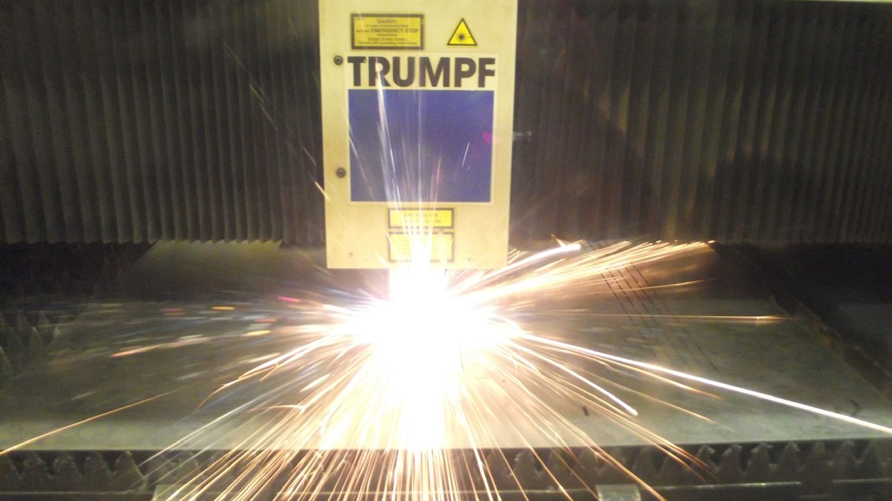

Vero Software’s powerful sheet metal CAD/CAM solution, Radan, programs their Trumpf laser cutter and two Bystronic press brakes. While most parts have an average of four folds which need to be programmed in the correct bending sequence, some of their more complex components need up to 15 folds.

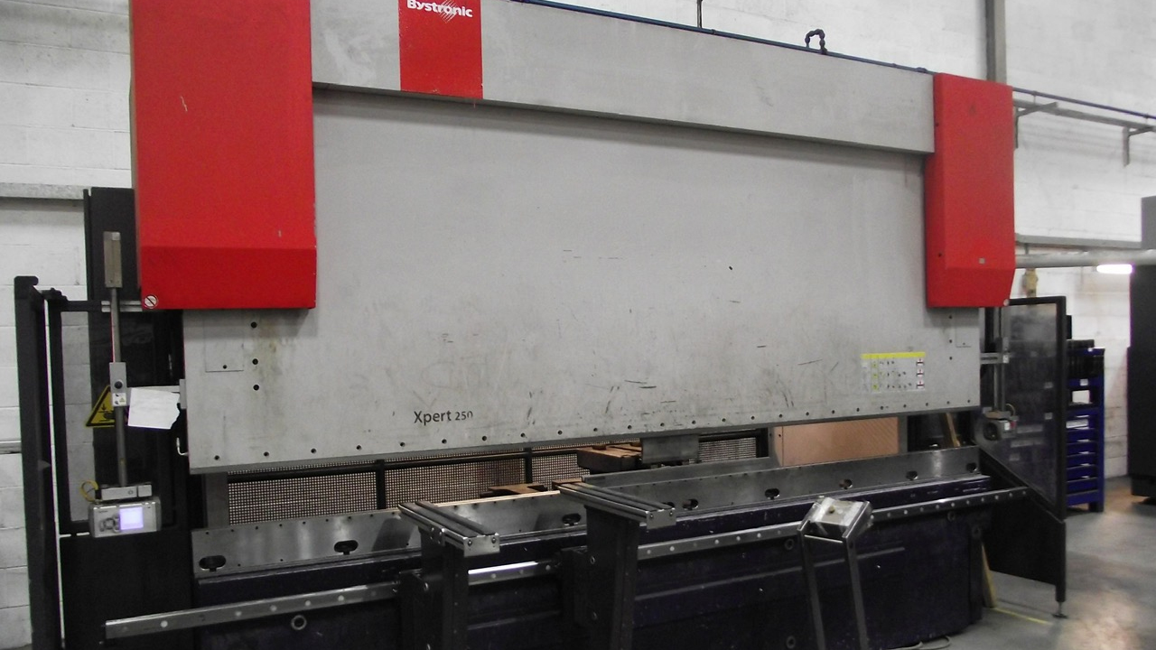

Previously, Spooner Industries took around 21 separate steps to import each individual Autodesk Inventor Part file (IPT) into Radan’s press brake module, Radbend. “Then we had to open it in Radbend and program the bending sequence, save it, and open the new file for whichever one of our two Bystronic Xpert 250 press brakes we were using for the job,” says Production Engineer Nick Murgatroyd. “Two people were assigned to the task full-time.”

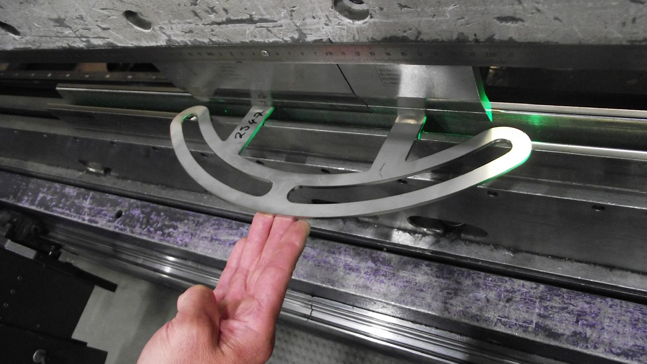

Andy Carlton is the Programmer/Operator who uses Batch Bending. He says Radan engineers included a verification warning which alerts him when manual intervention is needed. Much of it is only when the system recognises a potential issue that requires verification, and it just needs a simple mouse click to proceed. Other instances are when a collision has been detected, and he needs to recompile the bending program.
“Alternatively, it may need to be re-sequenced if the part can’t be completely folded with the original sequence, or where the part can’t physically be folded with one tool set-up and we need to produce separate programs for the same part using two or three tool set-ups.”
Manual intervention is achieved by opening the Server Message Block (SMB) viewer which shows exactly what the issue is, enabling him to reprogram or re-sequence the part quickly and seamlessly.
