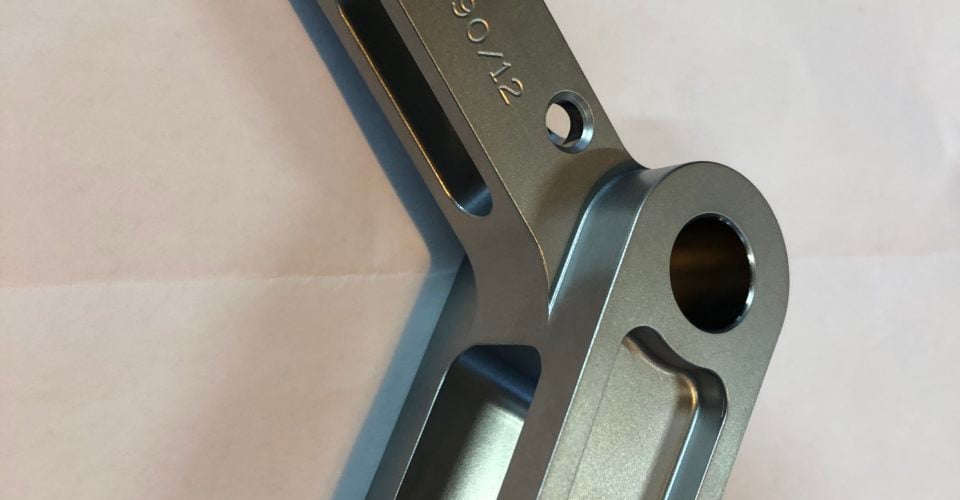

Leemark manufacture every machinable part for the Cargo Hook; the most complex, in terms of 5-axis machining, being the cover and solenoid case. But the most accurate is the steel lever which carries out several actions inside the body of the hook. “A high percentage of the milled components have bores on them with an 18 micron tolerance,” says Neil Stockwell. “The majority of the turned components have even tighter tolerances.”

“We hold the part on one face to work on all the others. Then a second operation machines the final face. We restrict as many parts as we can to just two setups. Components are becoming increasingly more complicated nowadays as designers try to limit the weight of everything that goes on the aircraft. But ALPHACAM Advanced Mill’s 5-axis capability means we’re not only able to produce them, but we can keep cycle times and costs down, too.”
