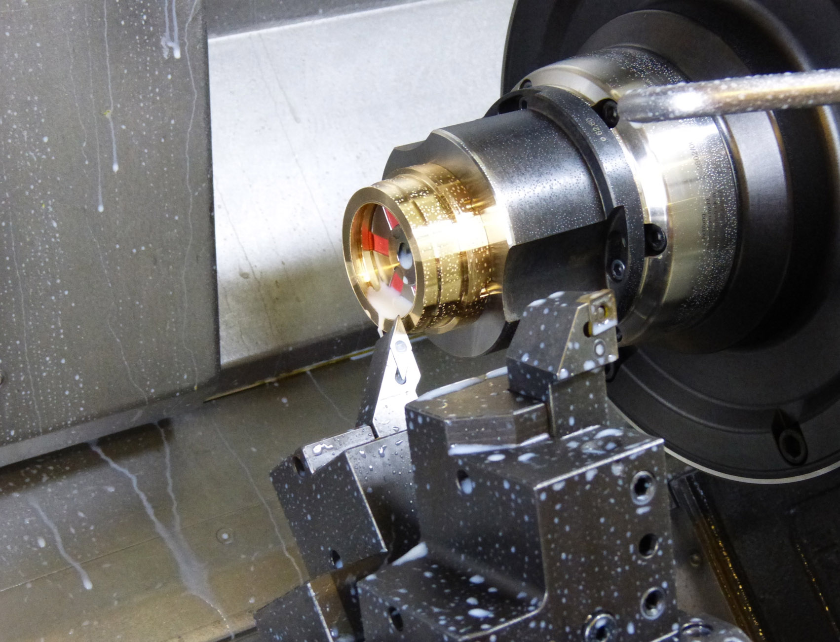

With Hainbuch, Villingen-Schwenningen based Steinel has certainly adopted the right clamping devices and impeccable level of precision for the high-precision manufacture of its durable guides and pneumatic springs. In addition, cube cast parts that require interrupted machining can also be machined on the new turn/mill centre. These parts were previously complexly manufactured on two other machines using a time consuming jaw chuck process. Hepfer recalls: “The parts were turned and then milled. This required two set-ups. Hainbuch recommended a mandrel for this clamping situation and we gave Hainbuch a sample part for a turning trial.”
Tresselt states: “We were not sure whether with the Mando mandrel would deliver on what Hainbuch promised. But we were surprised at how tightly, rigidly and accurately the mandrel performed. We now save one operation, as well as the change-over time. This significantly shortens through-put times and parts can also be machined very easily thanks to the minimal interference contour of the mandrel. We like the Mando system a lot and now we are even considering what other workpieces we can clamp with the mandrel.”

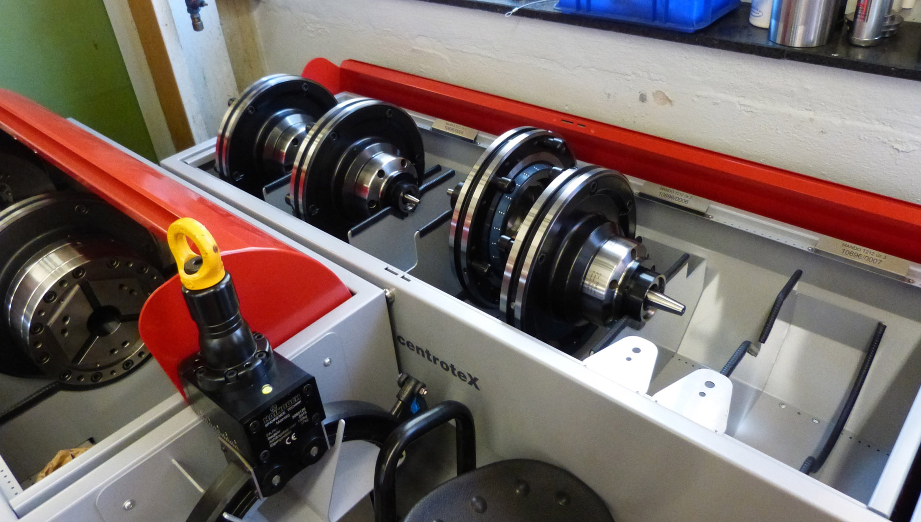

Steinel places a high priority on flexibility because batch sizes for the standard cast parts and for the pneumatic springs are small. However, with the new concept, Steinel wants to further reduce batch sizes in order to respond more effectively and with greater flexibility to customer requests. Tresselt says: “When the new programs run at their optimal level on the machine, we will further reduce the batch sizes. Today, with the new clamping devices, we are saving over 60 minutes every day. There is still space to improve. For our employees, the handling with the new clamping devices works perfectly. We have also purchased the compatible Monteq changing fixture and two storage containers. This ensures everything is cleaned-up and on hand for the employees.”
