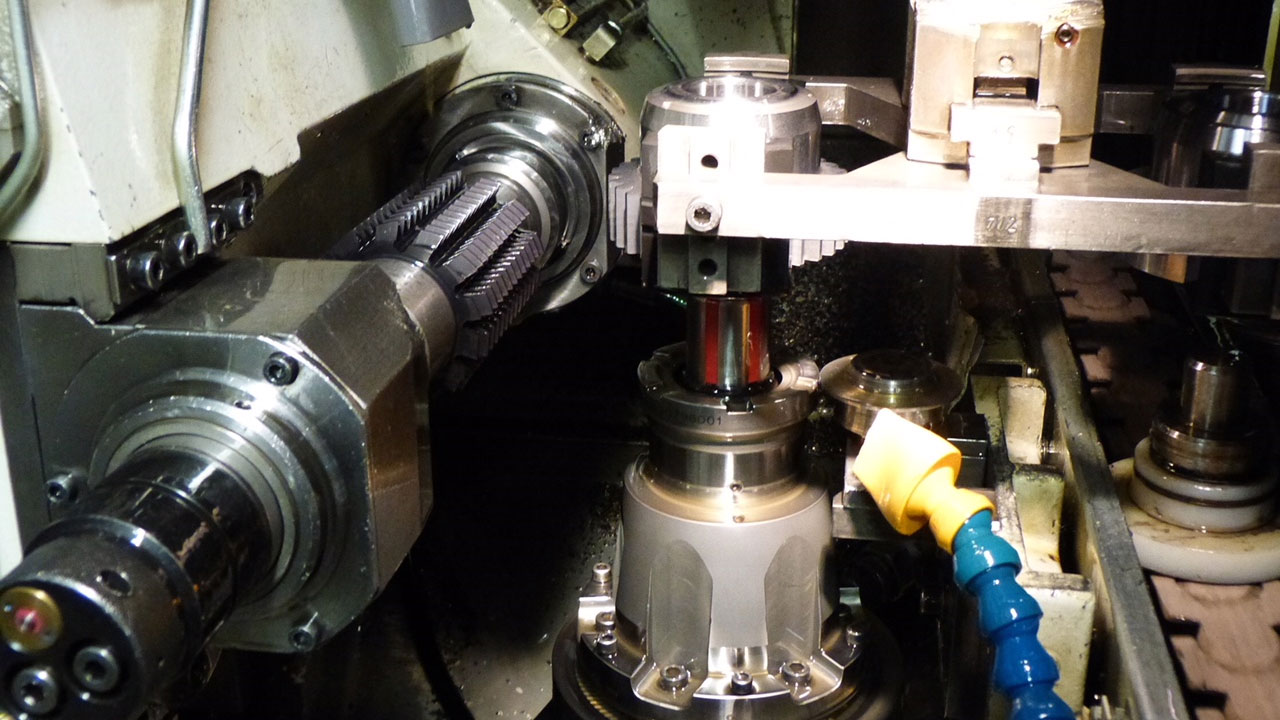

Hänel initially received two prototypes of the Mando G211 mandrel in sizes zero and two. The mandrels were tested on the Richardon R400 manual loading machine and on the Gleason-Pfauter GP200 hobbing machine with automatic loading to see if they would be compatible. Renner has to admit: “For our employees, this new clamping system was very strange as for 20 years they worked with a clamping system from the machine manufacturer without radial clamping, which worked fine so far. Initially, we had to make some adjustments to the machine and in addition, we did not reach our zero-line on the Gleasen-Pfauter machine because the mandrel was too tall. As a result, adjustments to the machine and loading system were required. What followed were conversations with the responsible designers at Hainbuch. We have diligently tested and passed on all the information needed to further optimise the mandrel and all design changes were implemented by Hainbuch.“
Subsequently, the revised second prototypes were made available, underwent field trials and a few minor adjustments to the machine were made. It was evident that the stiff and slender mandrel could go into series production and be produced for stock.

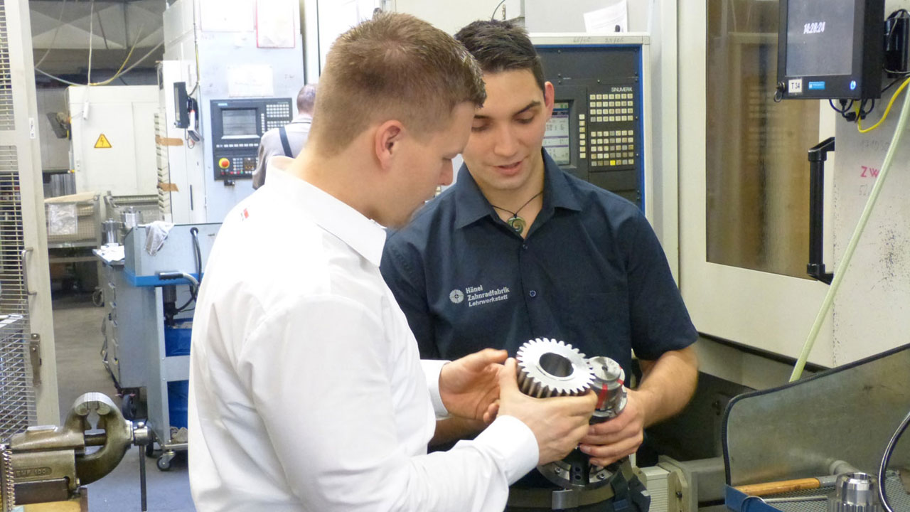

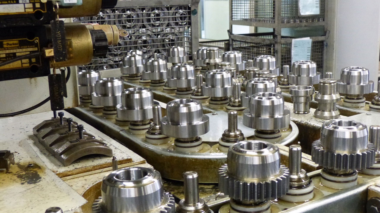

At Hänel the batch sizes are between 30 and 1,000 pieces, which customers specify because of the precision. As a rule, the very high quality gears are hardened and ground, so re-working is not an option. “With the current clamping system, we couldn‘t achieve good concentricity. The workpiece was pressed axially downwards. Now it is clamped with the mandrel from the inside, radially outwards. Thus, we have higher clamping stability. This eliminates the reworking of certain components. For some of our orders, the old clamping system was good, because the concentricity was not so important. But basically, the better the concentricity, the easier it works later. With a normal hardened gear, the bore still needs to be reworked, but all the workpieces that are fully geared can now be reduced to one operation,“ says Renner.
Further ratio effects
In addition, Hänel has improved set-up times with the new mandrel. This is because when using the Mando G211 mandrel, only the segmented clamping bushing and not the entire clamping system has to be changed. It also eliminates the need for alignment, which of course saves time. Even if the mandrel and segmented clamping bushing have to be changed to a different size, this is still faster. There are only three screws on the mandrel for the support and a screw on the segmented clamping bushing. Renner estimates: “If everything is prepared, optimally the part family is in stock and can be processed one after the other; we will certainly save 50 percent of the set-up time. Not only is the setup faster, but the process is also more stable and safer.“ Andreas Hoffmann, Head of Toolmaking, sees even more benefits: “Thanks to better stability, we can drive higher feed rates. Even  tool wear is reduced because we have less vibration.“
