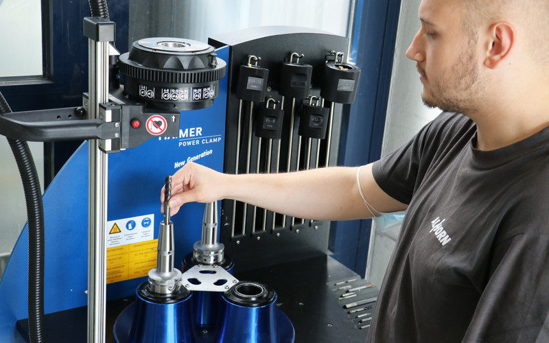

“The benchmark and the positive feedback from our sister company was what prompted us to get in contact with HAIMER,” reports Soldato. Their first contact was Thorsten Böker, who is the technical sales representative at HAIMER for Alhorn. He supplied basic information regarding the quality of HAIMER products and the different versions: “The BT30 and BT40 interfaces versions with face contact have also been a part of HAIMER’s standard product range for some time. All other steep taper holders can be supplied as semi-standard as well as with face contact. HAIMER is well known for the high accuracy of the interface, as we grind all functionally relevant surfaces ultra-precisely in production and subject the holders to a double 100% quality inspection process. Generally, our shrink fit chucks are made of heat-resistant steel, hardened to 54-2 HRC. They are suitable for HSS and solid carbide tools with shaft tolerance h6 and guarantee runout accuracy less than 0.003 mm at 3 x D with extremely high clamping force. They are available in various versions including the extra-slim Power Mini Shrink Chuck with 1.5-mm wall thickness and 3° slope in the tip area.”
The comprehensive range also features various different interfaces, an important point for Alhorn, as Sascha Soldato stresses: “We not only required the slim contours of the shrink fit chuck but also tool holders with a BT40 interface and face contact as well as HSK-A63. The interfering contours of these tool holders in various spindle interfaces need to be precisely symmetrical, which is the case for HAIMER.” The reason for this wish is the benefits for programming and system maintenance  because Alhorn has digitalized and saved all tool holders and machinist vices, etc. in their CAD / CAM system. Using the same holder contour, production planning can easily switch tools from the Yasda to a machine tool from another manufacturer with the same spindle interface.
The HAIMER BT40 shrink-fit chucks with face contact, which are new to the program, have been used on the Yasda machines for several months. Alhorn uses the corresponding holders with the HSK-A63 interface on other machining centers. Plant manager Timo Schwiering concludes: “The shrink fit chucks completely fulfil our requirements on interfering contours, true runout accuracy, diversity and manufacturing quality. We are also very satisfied with the HAIMER Power Clamp Comfort NG shrink machine. As we consider ourselves to be a growing and innovative company, we plan to continue to expand our collaboration with HAIMER in the future.”
