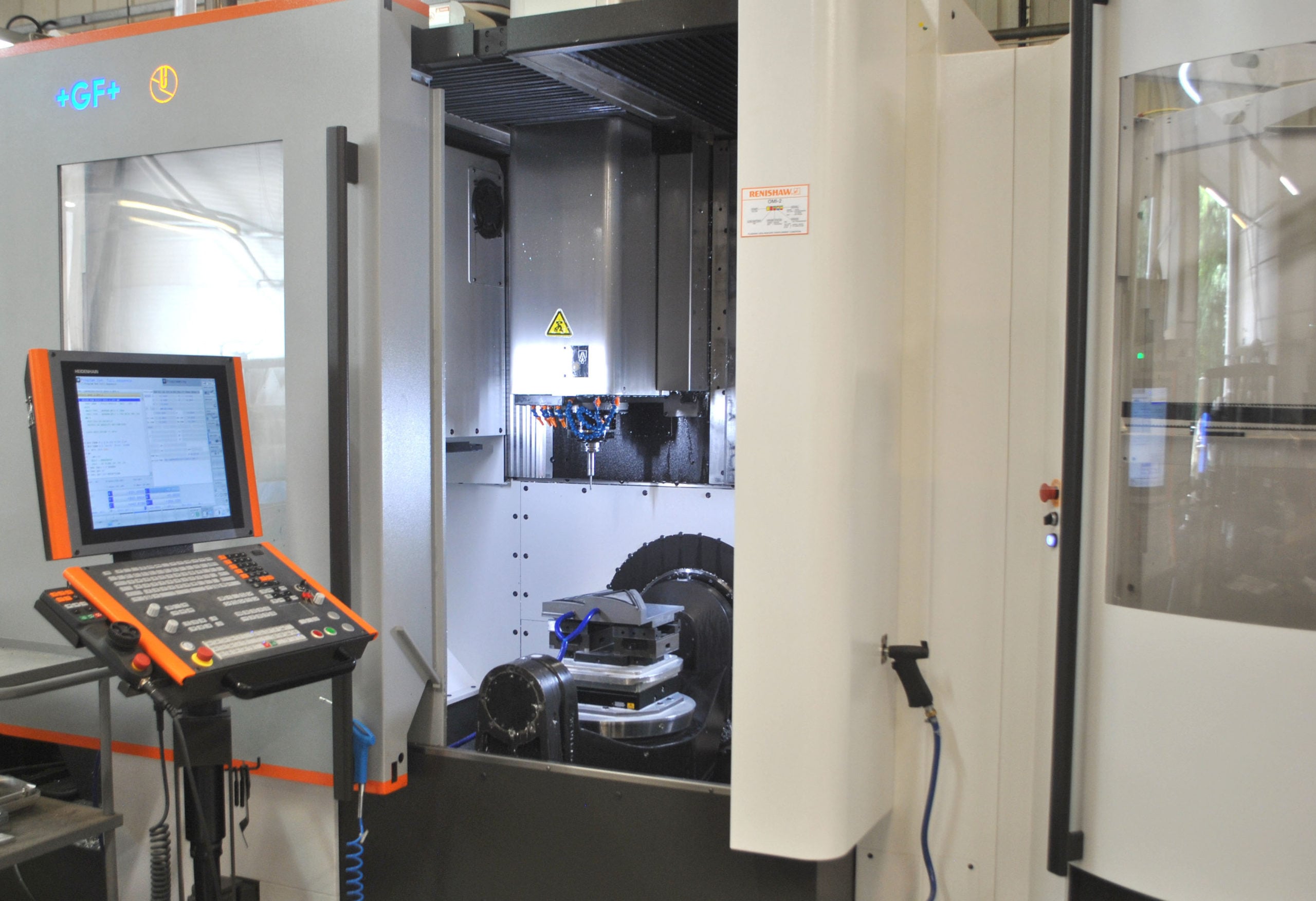

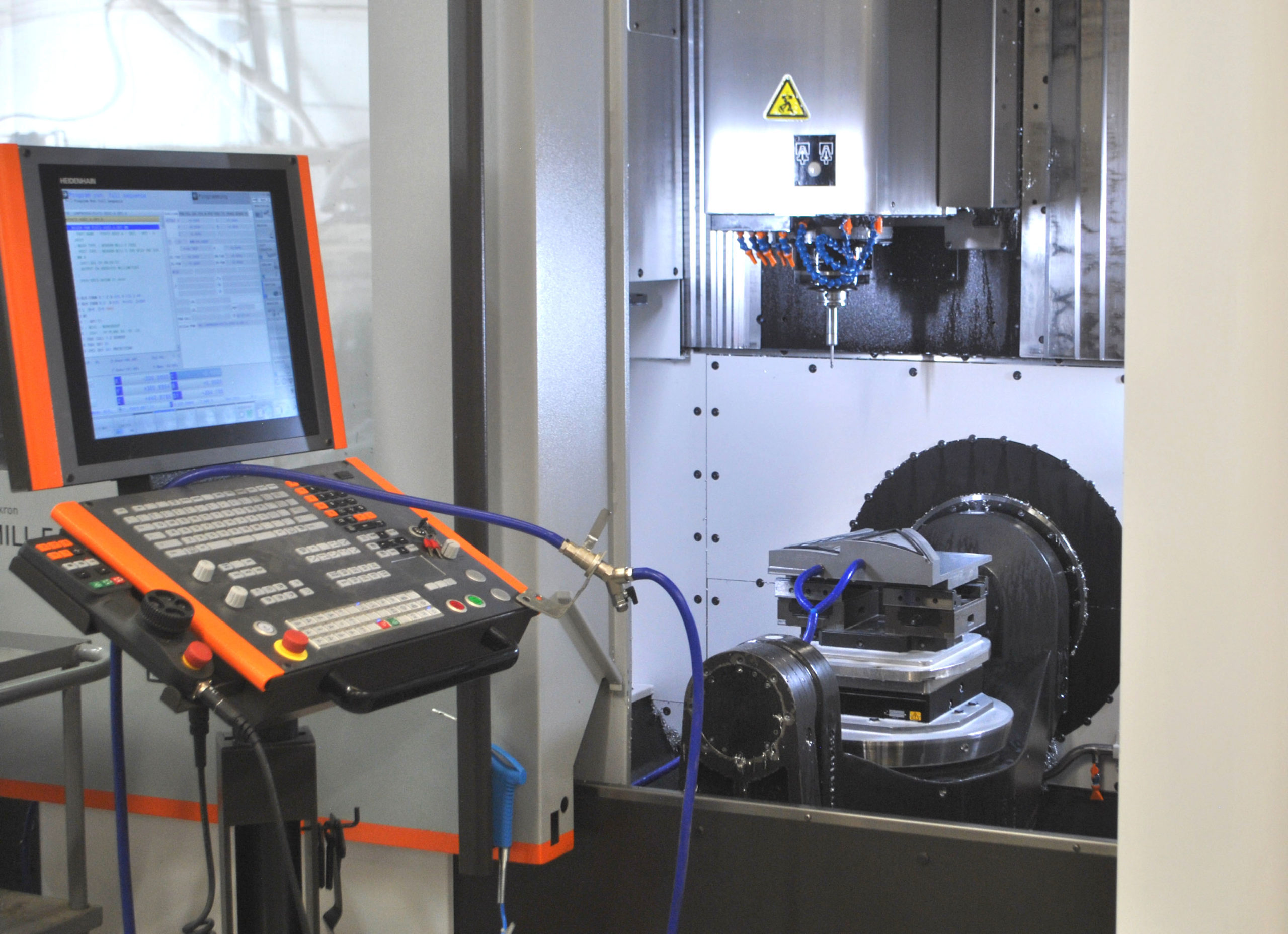

Mikron MILL E 700U
The MILL E 700U is a high-efficiency 5-axis machining centre that has a rigid C-frame construction, large-sized guideways, a double-supported (trunnion-type) direct-drive rotary tilting table and an integrated 7-station Automatic Pallet Changer.
Equipped with the Heidenain tnc 640 control and featuring a powerful, high-speed 36kW/20,000rpm (OptiCool) spindle with oil-air lubrication, the MILL E 700U delivers excellent cutting performance, unrivalled machining flexibility and best-in-class process reliability.
Says Brian Challenger:
“The machine’s advanced spindle technology with oil-air lubrication enables us to maintain part accuracies and keep within tolerances during long machining runs, and its direct-drove rotary table technology, in combination with the StepTec spindle, means we can achieve super-fine surface finishes on machined parts.
“All in all, the MILL E 700U is a versatile, high-productivity machine – and is a real asset to the company.”
