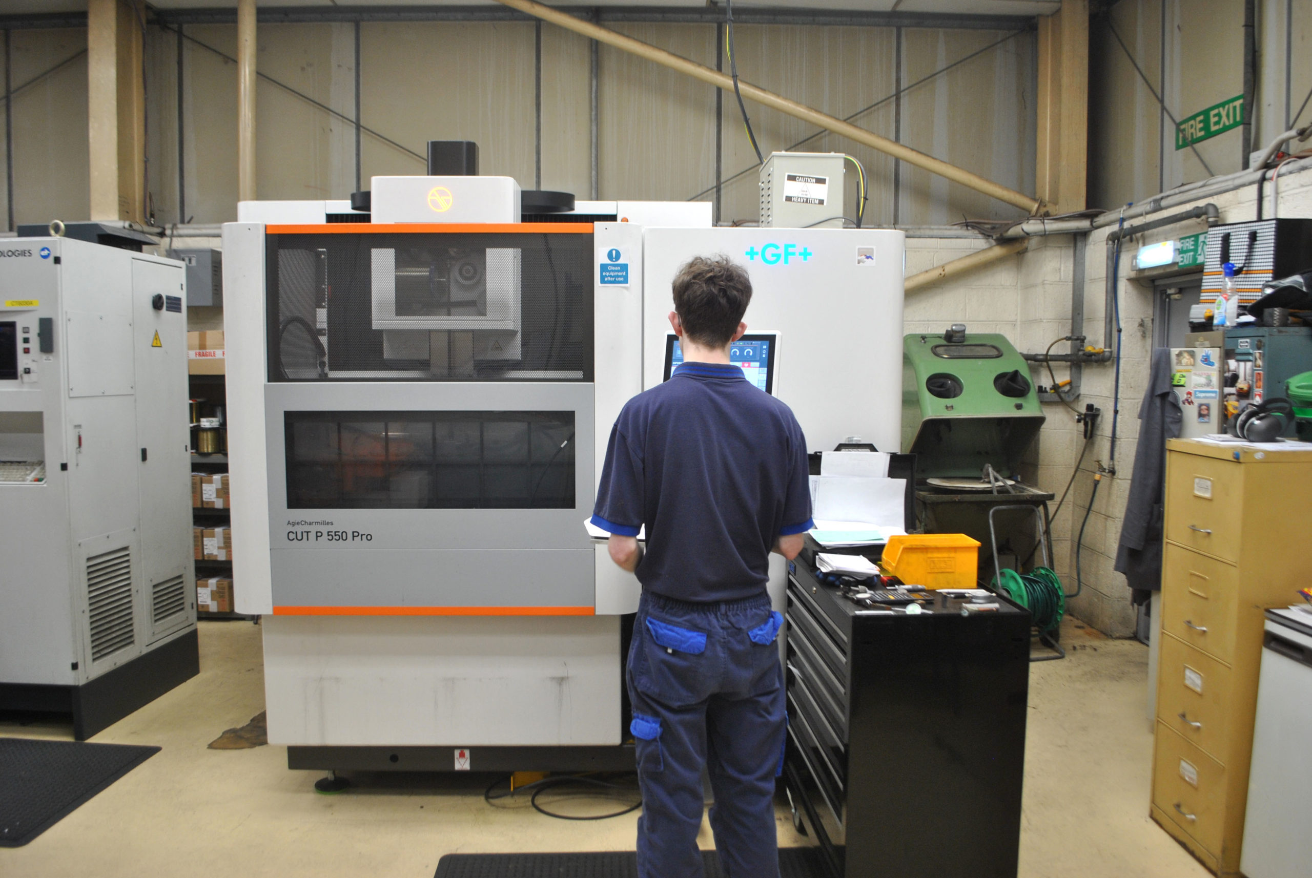

GF Machining Solutions, the milling, EDM, laser and Additive Manufacturing (AM) machine tool manufacturer and automation and tooling systems specialist, has recently supplied a new, state-of-the-art wire EDM machine to Bedestone Ltd., a leading wire erosion and jig grinding specialist based in Birmingham.
The machine, an AgieCharmilles CUT P 550 Pro, was delivered and installed in Bedestone’s 6,500sq. ft. temperature-controlled machine shop facility in June 2021 and has taken its place alongside two, previously acquired, large capacity wire EDM machines and two EDM hole drillers, to create a flexible, responsive and high-precision wire EDM resource for its growing customer base.
The new CUT P 550 Pro has significantly increased Bedestone’s wire EDM capacity and capabilities and was acquired, as part of the company’s five-year ‘rolling’ Capex plan.

CUT P 550 Pro: Taking a closer look
Since being installed the CUT P 550 Pro has been in continuous action machining prototypes, one-offs and small batch series of precision parts for Bedestone’s defence, motorsport, nuclear customers; to name but a few.
The last eight months have provided ample opportunity for Bedestone to become familiar with its new machine…to understand its key strengths…and recognise the contribution it makes to the company’s future growth and success.
Continues Richard Stanley:
“The CUT P 550 Pro is a compact machine. This was an important consideration for us because space is at a premium in the machine shop.”
The machine, despite its compact size, has a good-sized working envelope (550mm x 350mm x 400mm). It also has a stable and rigid design and, amongst its many strengths, features integrated thermal compensation systems (water cooling and air conditioning) that help maintains temperature consistency within ±0.2°, and enable high accuracies and repeatability’s to be maintained – even during long periods of operation.
“Our customers expect and demand exacting precision”, explains Richard Stanley. “The CUT P 550 Pro is equipped with a range of innovations and technologies that enable us to meet, and surpass, customer requirements.”
Central to the CUT P 550 Pro’s speed, versatility and accuracy is its Intelligent Power Generator (IPG) technology and a number of embedded ‘EXPERT’ and SMART systems.
“The IPG digital generator delivers fast processing speeds, improved accuracies and repeatability’s, and enables us to achieve superior surface finishes (down to Ra 0.08um), in fewer passes.
“The EXPERT and SMART systems are equally impressive. They help make us more efficient and increase our flexibility.”
