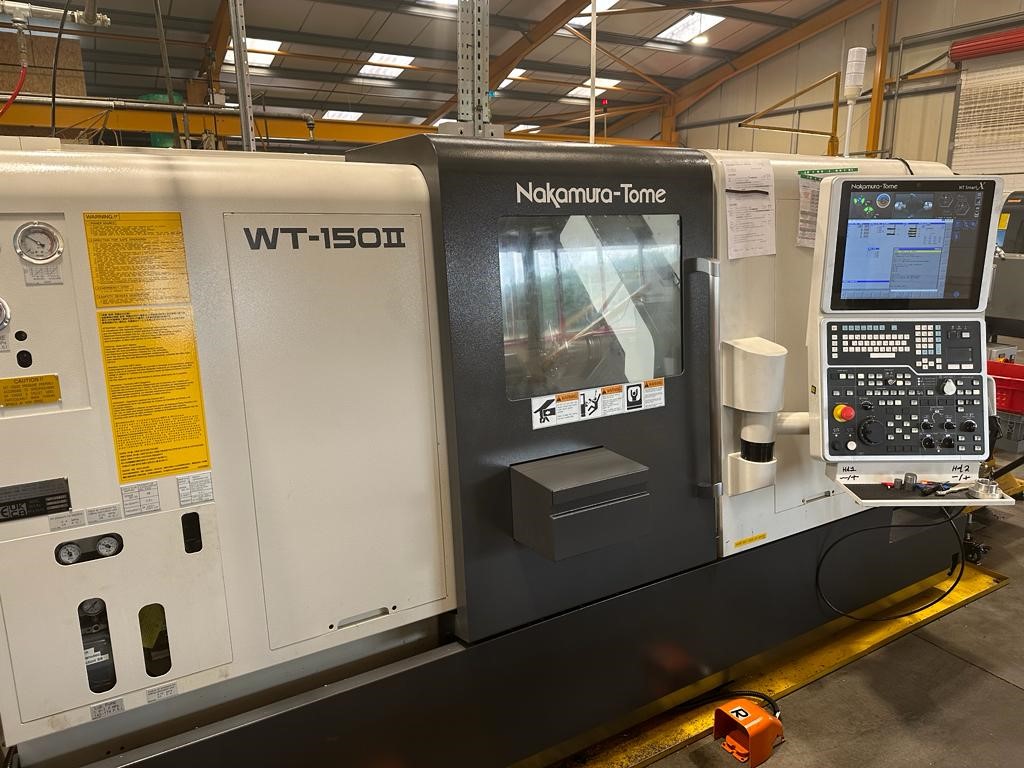

Discussing why the North Devon company has purchased the Nakamura-Tome WT150IIF twin spindle twin turret turning centre, Alex adds: “The latest WT150IIF has replaced a Nakamura TW20 that has reliably run for around 20 years. Whilst the new machine is more than 50% faster than its predecessor, it would be unfair to draw direct productivity comparisons.”
However, the benefits of the latest Nakamura are evident, as Alex continues: “The first benefit is that the new machine will just run continuously without any breakdowns. This would sometimes occur on older machines. In a production environment, we need maximum uptime and the Nakamura WT150IIF is running from 8am Monday to 5pm Thursday without stopping. Previously, these parts would require manual input for several reasons. Firstly, there would be tolerance fluctuations with legacy machines and operators would have to intervene to keep production within tight tolerance bands. This issue would be compounded by indifferent tool life monitoring capabilities on old machines where staff would need to regularly check tool life and performance. With the new Nakamura, the alarms and tool life monitoring are exceptional, and we have eradicated excessive tool changes and monitoring protocols. The team know exactly when the tools require changing and this has improved tool life, consistency and machine uptime.”
