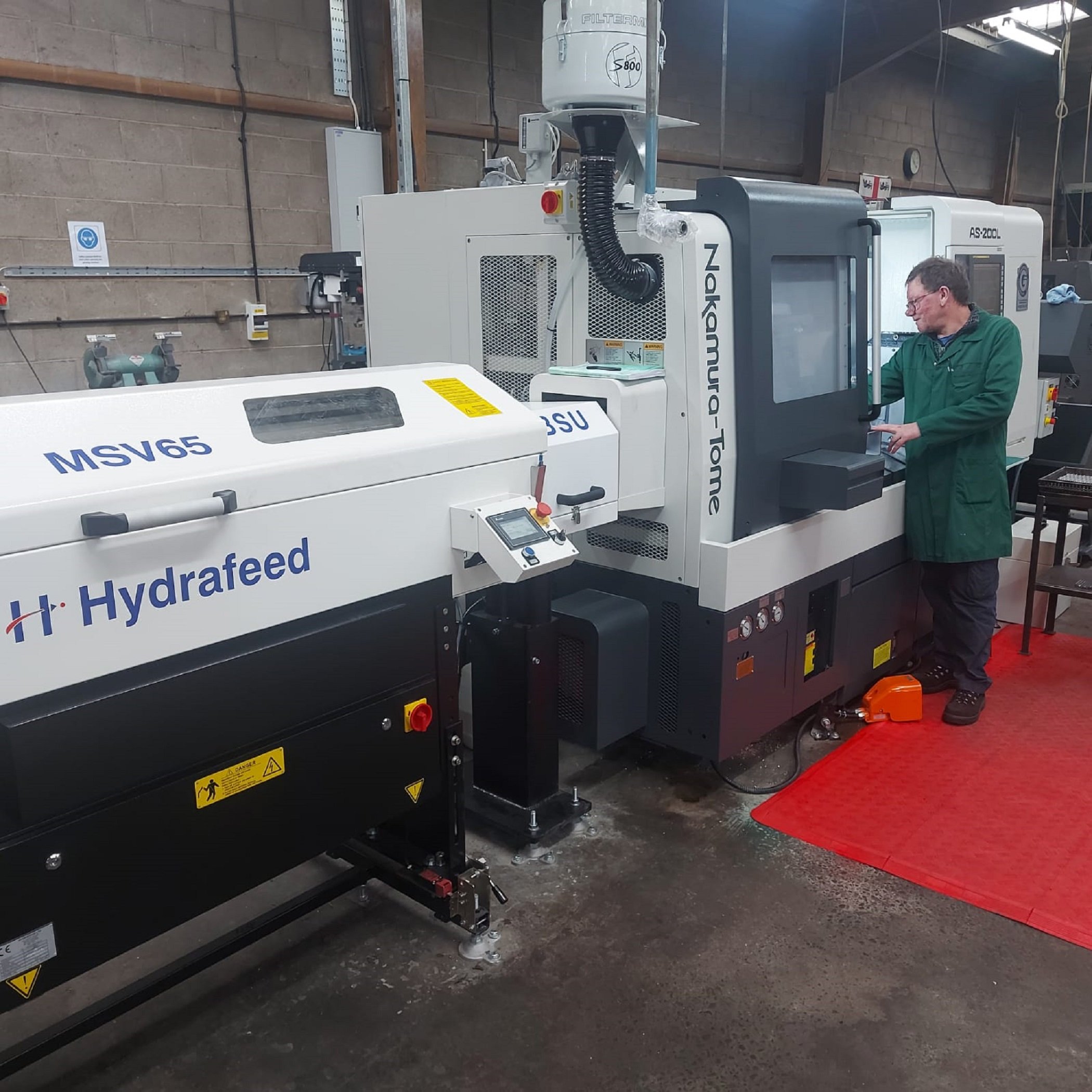

The company machines “normal” materials but increasingly processes more challenging materials such as Titanium, Inconel, Stainless Steel, Super Duplex, Duraheat to tolerances in the region of +/-0.0125mm with the thread rolled parts often being critical components in their respective assemblies. “We have 6 Hardinge lathes and have been using Hardinge for over 20 years, so we understand the build quality, rigidity and stability they offer. Out of the available vendors, the Nakamura-Tome from ETG was sensibly priced, it had the same FANUC programming language as existing machines and it was supplied as a long-bed version for our 400-500mm parts with a bar feed, part catcher, the twin spindle for one-hit machining and of course a highly recognised reputation for build quality, stability and precision.”

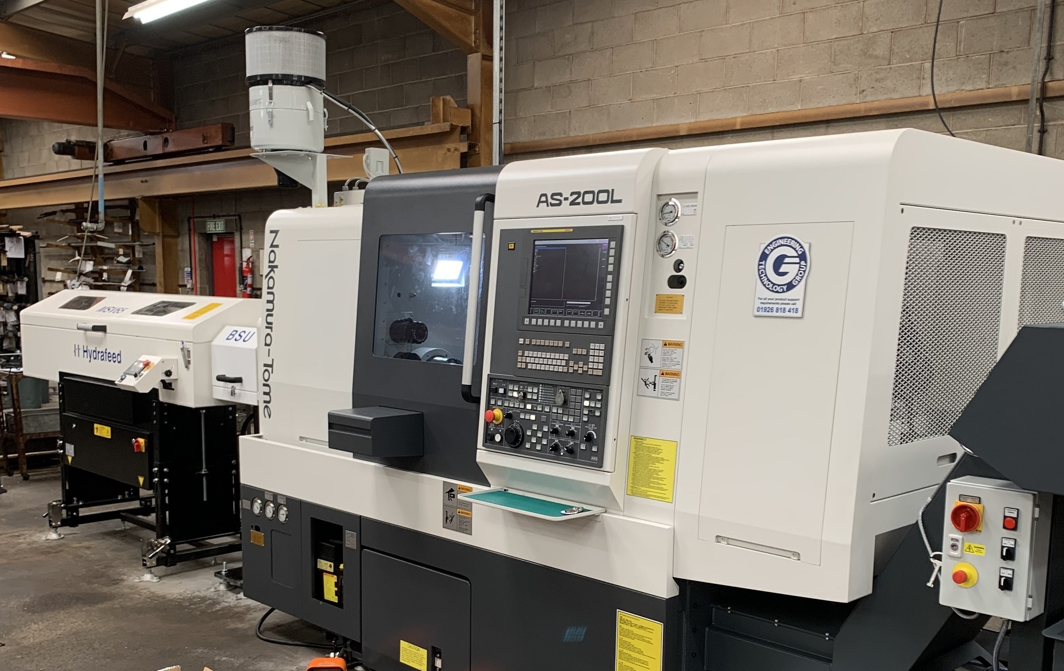

The robust Nakamura-Tome AS200 has a spacious work envelope with a maximum turning diameter of 340mm and a turning length of 570mm with a bar capacity of up to 65mm diameter. The flexibility is provided by a 15-station tooling turret with a 5.5/3.7kW driven tooling motor that achieves a speed of 6,000rpm. The main spindle is driven by a 15kW spindle motor with the sub-spindle driven by an 11kW motor – both high-torque units are capable of reaching a maximum speed of 4500rpm.
