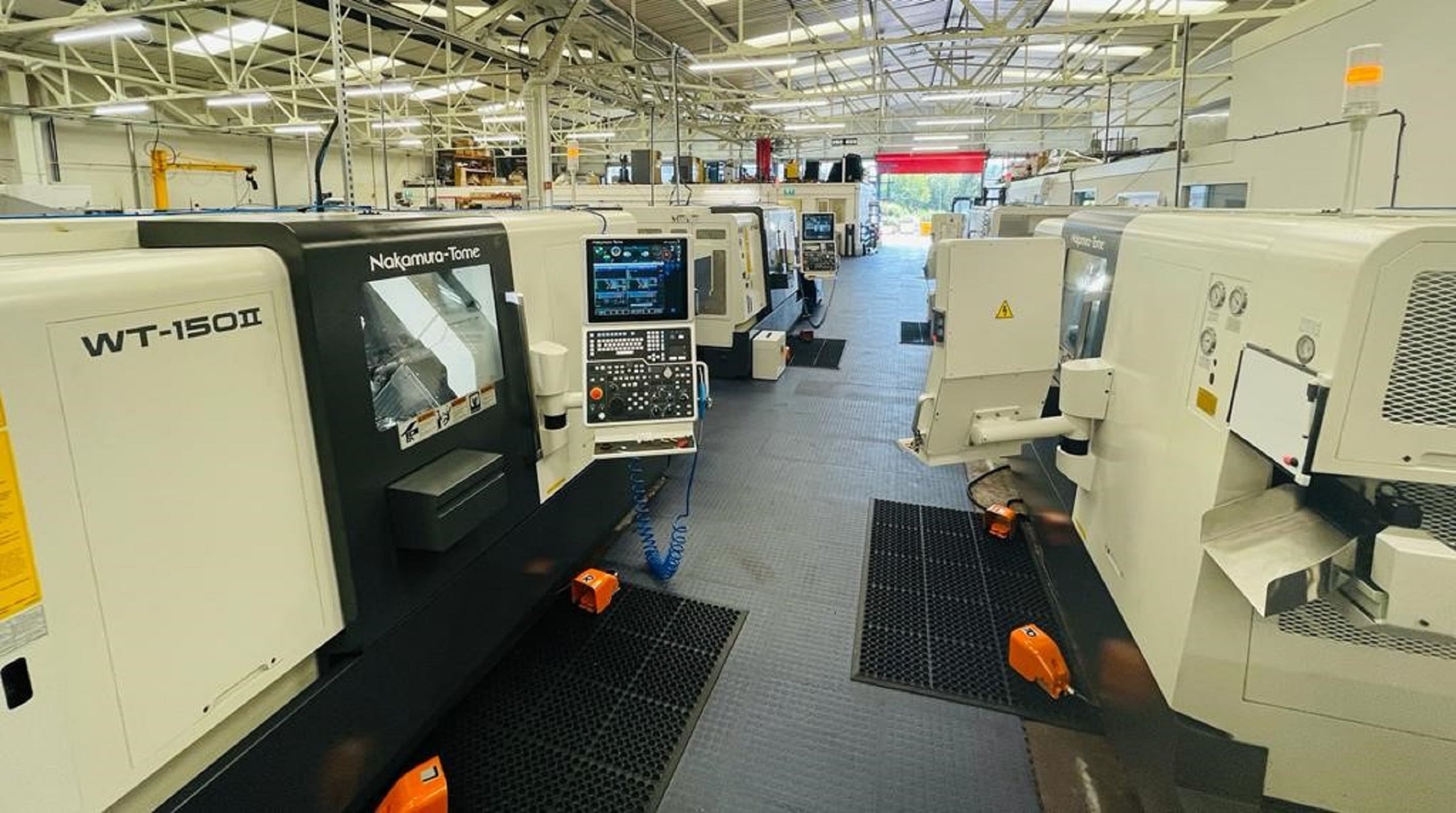

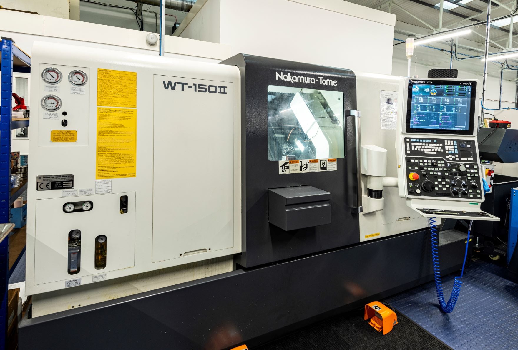

Now with four Nakamura-Tome WT150II turning centres from Engineering Technology Group’s (ETG) Scottish distribution partner RAM Engineering & Tooling, the 20,000sq/ft facility is filling fast with the industry’s leading multitasking machine tools. Serving customers in the oil & gas, electronics, automotive and aerospace industries, ISO9001:2015 certified Quest Precision is well versed in machining everything from simple to the most complex of components. It is this requirement for one-hit machining of complex parts from challenging materials that led to the installation of the first Nakamura-Tome turning centre in December 2019, a twin-spindle twin turret WT150II. The impact of the Nakamura-Tome WT150II resulted in a second machine being installed four months later and this has now been followed by two more machines that were delivered at the end of July.
