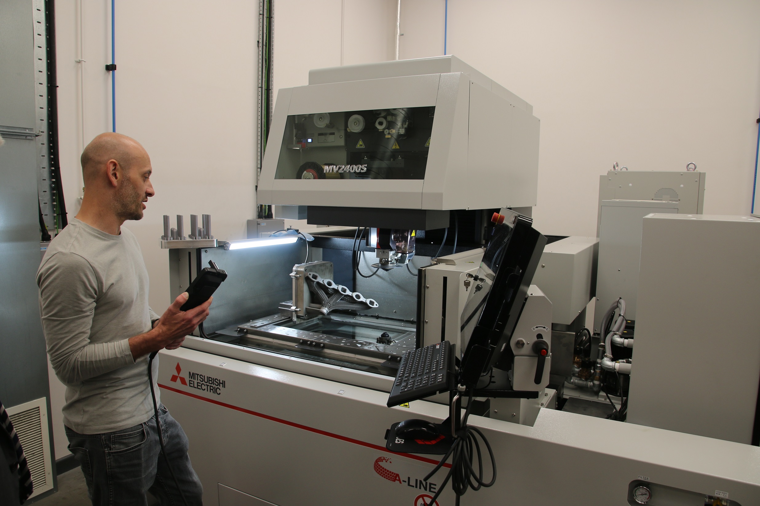

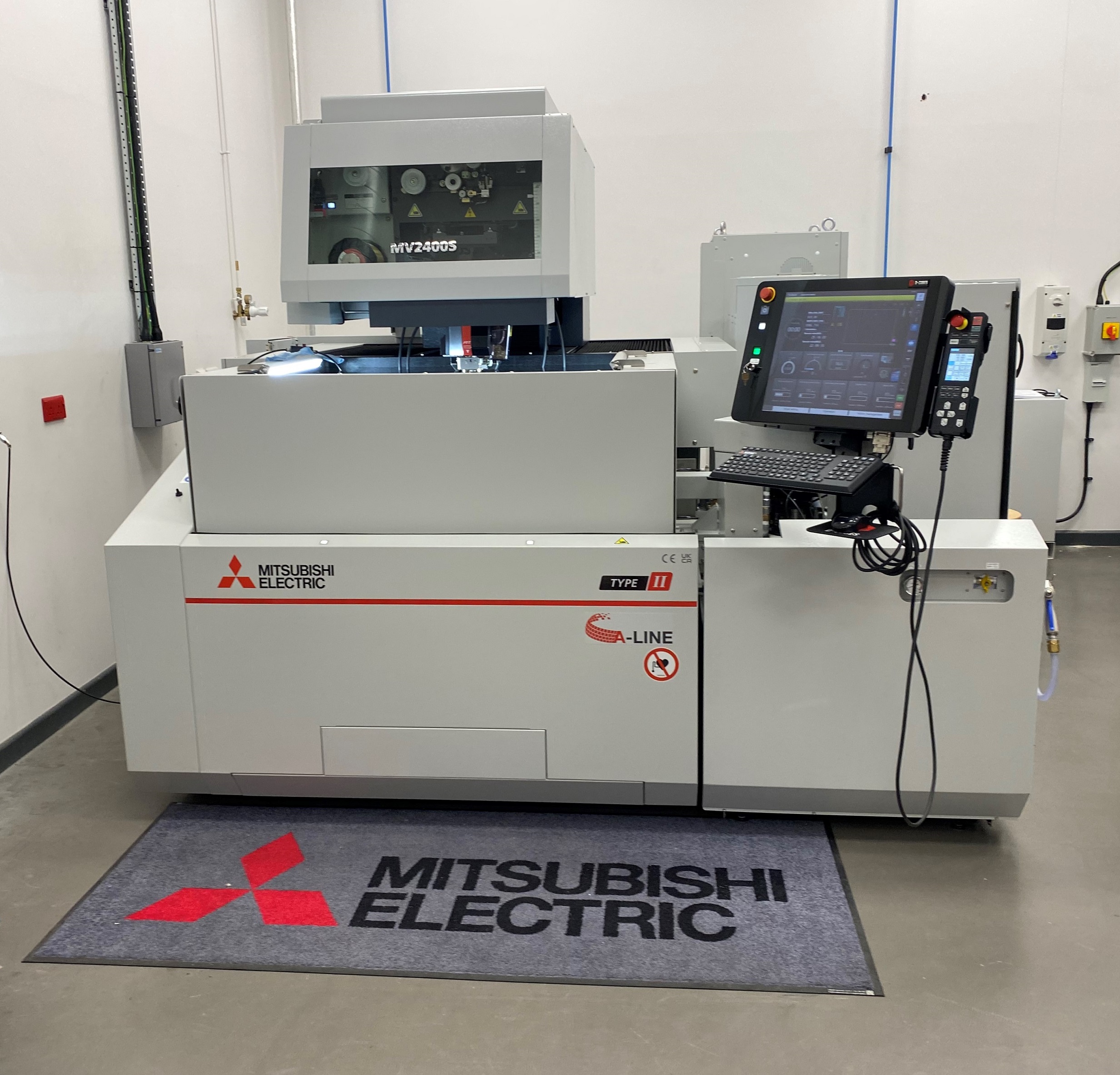

Alloyed spoke to ETG’s resident EDM expert Scott Elsmere, and the Mitsubishi MV2400S Type II wire EDM was identified as the perfect choice for the business. Working with an existing EDM machine that required G-Code programming, a skillset that was thin on the ground in this fast-paced high-tech business – Alloyed wanted a machine with incredible ease of use. The new MV2400S EDM that was ordered in April and delivered in May incorporates Mitsubishi’s intuitive AD Series CAD/CAM system – a feature that has instantly slashed programming times.
As Stephen says: “We can export STL files and any other CAD files into the Mitsubishi and it eliminates most of our programming problems. We load the CAD file to the machine and it automatically programmes the job. It detects what part of the component requires processing and it selects the machining parameters with some very simple data input. For us, we just ‘press play and walk away’.”
For any jobs that may require programming on the machine, the 19inch display interface demonstrates unrivalled ease of use. As Stephen continues: “The functions are extremely easy to understand with intuitive diagrams that guide us through the process. We recently needed to cut some precision shims and a subcontractor wanted to charge us £50 per shim – we clamped a batch of shim material together and programmed and machined them on the EDM in minutes.” Stephen jokes, “I now have a lifetime supply of shim and it has barely cost us anything.”

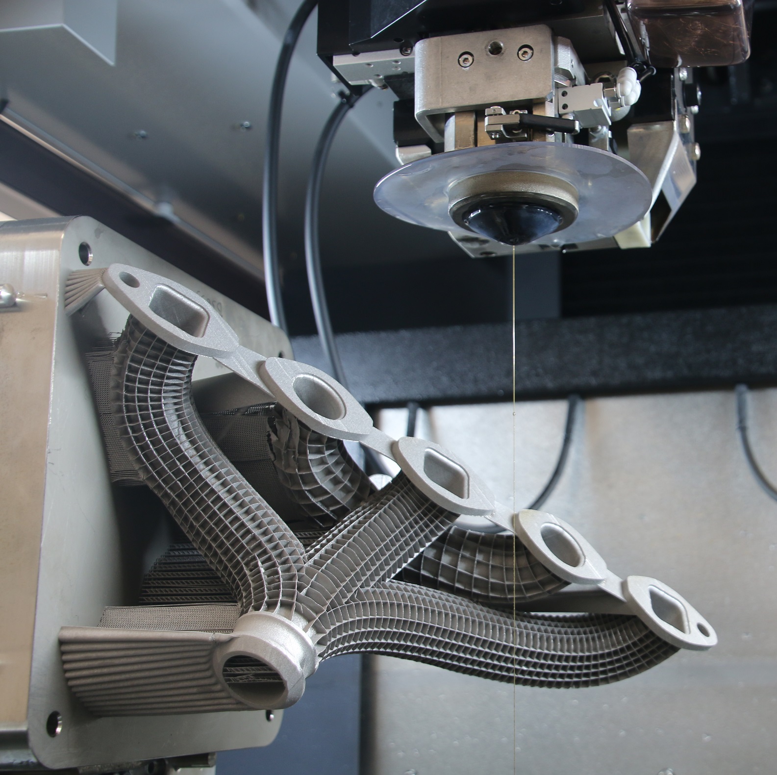

Alloyed additively manufactures a multitude of materials from aluminium and nickel-based alloys to steel, bone alloys, metal matrix composite, copper and even platinum. With such a diversity of materials that are continually being tested, the company 3D prints plates of test cubes in different dimensions for stress, tensile, hardness testing and even CT scanning. A typical test plate may consist of 10 rows of printed cubes – with the new Mitsubishi MV2400S applying its AI technology, the cutting time has fallen from one hour to less than 25 minutes. This typifies the productivity saving achieved with the new EDM machine. However, the productivity and programming benefit don’t tell the whole story.

One of the biggest savings for Alloyed is eliminating manual intervention that was continuously required to re-thread the wire each time it broke – each re-thread would take between 5 to 15 minutes. A short intervention may not be considered too much of an inconvenience, but when the wire continually breaks – it turns into a significant issue. For example, the frequently produced plates of test cubes that are efficiently machined 50% faster on the new Mitsubishi would require 8-10 wire re-threads with the previous machine. Manually re-threading the wire 8-10 times at a minimum of 5 minutes per re-thread was adding a minimum of 40 minutes to a job that only required one hour of cutting. Extending the previous 50% cycle time improvement to more like 100%+.
Alluding to this, Stephen says: “The Mitsubishi MV2400S has an outstanding automatic wire re-threading system that gives us the confidence to walk away from the machine and leave it to run. Our team members will run a number of machines simultaneously – being present on one machine consistently isn’t how we work. The automatic wire re-threading can even be conducted when cutting a large job with a considerable distance between centres. Again, this is another feature that enables us to ‘hit play and walk away’ from the machine with complete confidence.”
