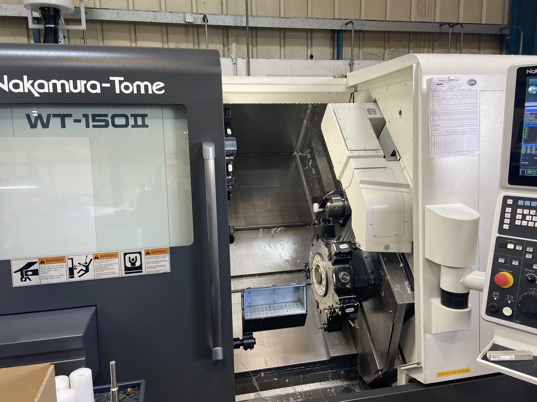

Located across three sites on the Wirral, Diamond Precision Engineering has evolved from a small toolmaking business to a subcontract manufacturing specialist. From a company producing press tools and fixtures in its infancy, Diamond Precision now offers 3D printing, laser cutting and CNC folding, fabrication and CNC machining. As a business that always invests in high-end technology, Diamond Precision has recently installed two Nakamura-Tome turning centres from the Engineering Technology Group (ETG), a WT150 and an AS200.

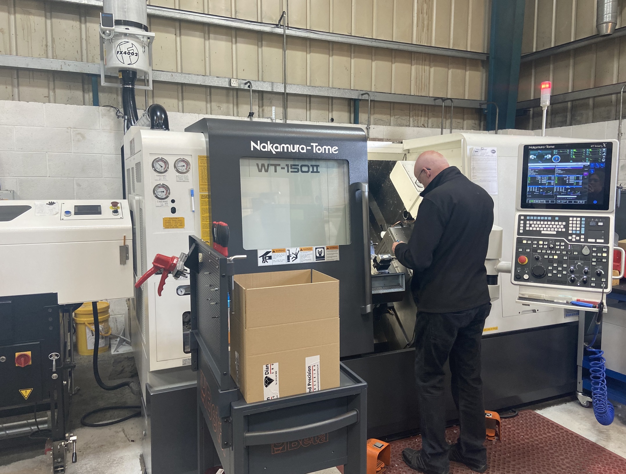

Referencing the benefit of the Nakamura WT150II from ETG, Harry says: “We had a job that I quoted and we were 3 times more expensive than the customer wanted – and I really wanted us to have the job. There were obviously people already doing the job at the lower price point, so I wanted to know how we could do the job at that price. Now, we have the WT150II machine and we have won the order by easily undercutting the clients’ price point. We are now producing 4,000 parts as part of the ongoing order. This proves that the impressive speed and productivity of the Nakamura technology can make us more than just competitive but industry-leading.”

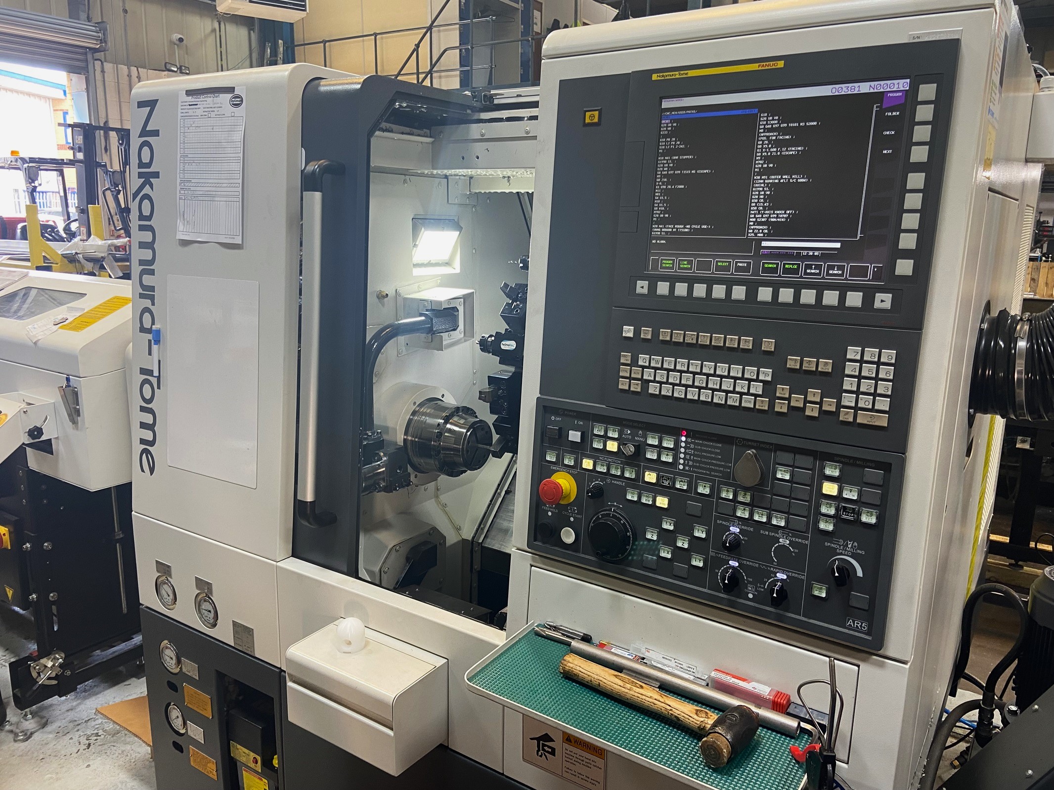

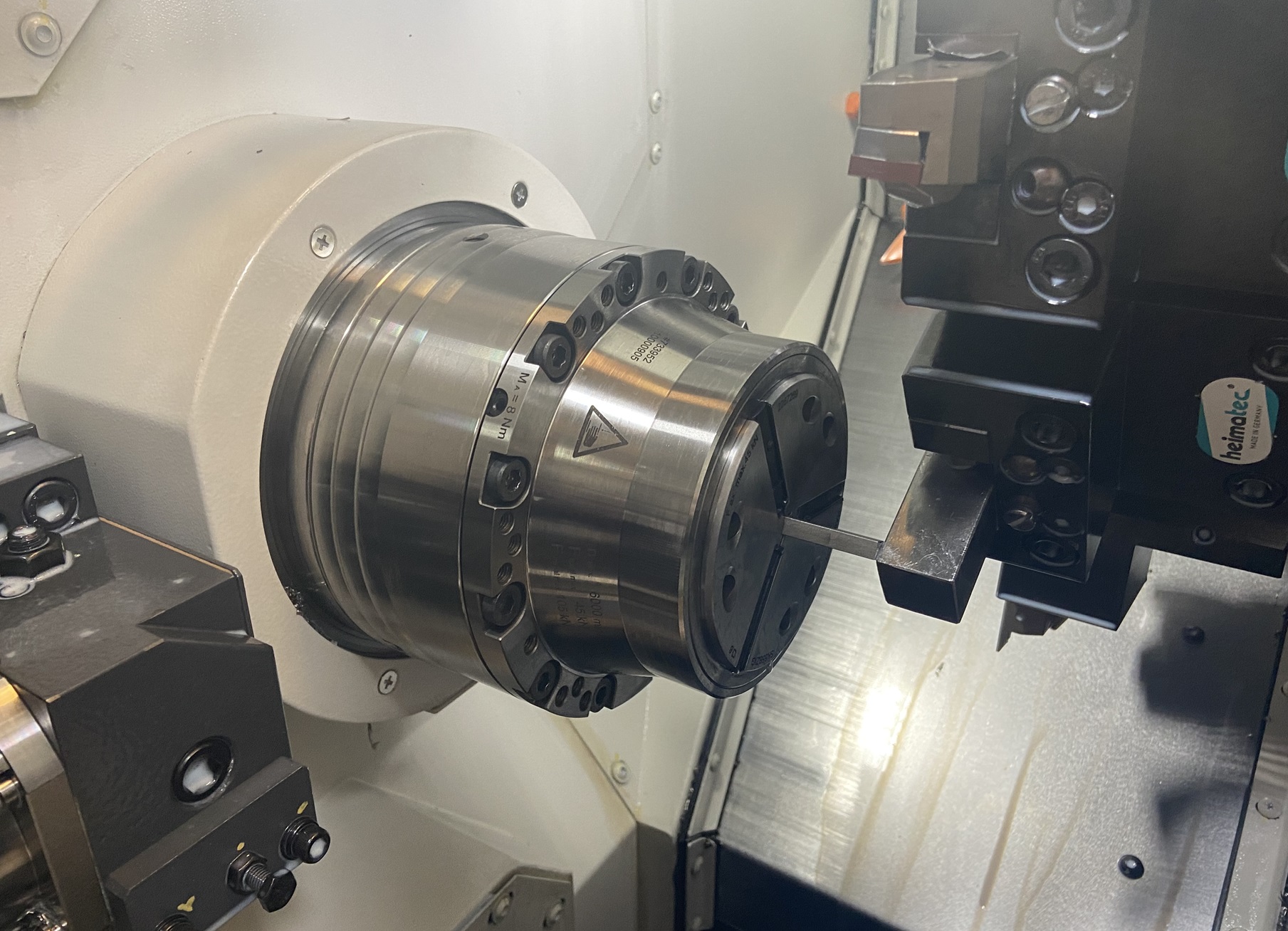

Looking specifically at the Nakamura AS200 where Diamond Precision is machining a small job from a square bar that would have originally been processed on a machining centre, Harry says: “The small job was previously manufactured on a machining centre and it was a horribly tricky job to handle. The 316 stainless steel part had three operations until one of our team suggested barfeeding the job on a Nakamura. Now, the AS200 is producing a better-quality part and as it is bar-fed, it can run automated all day. As important, it is producing a better quality part and more consistent surface finish as it is even deburred in-cycle. Now, we have drastically reduced the cycle time and we don’t need an operator present. As a small business, we have to innovate or our competitors will overtake us. Fortunately, we are really lucky that we have some great guys with fantastic and creative manufacturing ideas in our business.”
Adding his thoughts on the Nakamura AS200, Harry says: “Even though our AS200 is not a twin-spindle and twin turret variant, it has thoroughly impressed us. There are lots of jobs the single spindle and single turret configuration can handle in just one operation. One job is a family of two components and because of the programming expertise of our guys, we can profile the first and second parts in one hit and then just part them off. This is giving us two finish parts in one hit.”

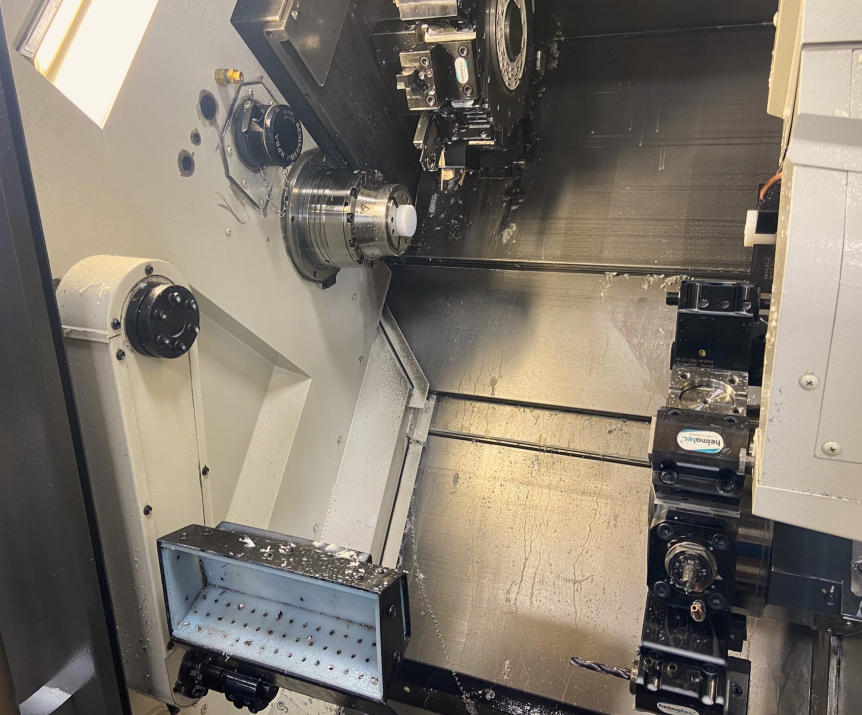

With both the larger Nakamura WT150II and the smaller Nakamura AS200 machines having part catchers, live tooling, and barfeeders – the combination already offers an exceptional level of automation. Alluding to the level of automation, Harry adds: “We have found that automation is like an art form in itself. Making the parts when we are here is half the battle but what we have learned with Nakamura is the ability to leave the machines to run unattended overnight. However, automation brings other challenges like getting the parts out of the machine. If we are making a batch of 700 parts in one night, how do we get parts out of the machine? The WT150II has a conveyor that simplifies this, but it can be more challenging on a smaller machine – but it’s just a learning process. On the WT150II, we had some parts that we left running and the swarf was too long and stringy, jamming the conveyor and stopping the machine. It provided another opportunity to learn, we have now employed strategies to break the swarf. It may have added 3 seconds to a cycle, but we recently left the machine to run from Friday morning through to Saturday night.”
