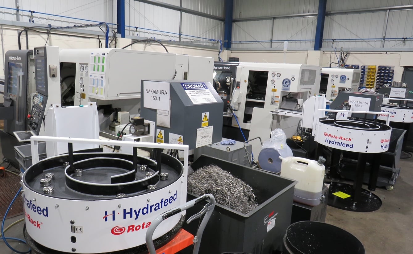

“I think we bought our first Nakamura machine around 2003-4, and we’ve had them ever since,” recalls Paul Cobb, Managing Director at HPC Services Ltd. Now with five Nakamura-Tome turning centres on the shop floor, the subcontract manufacturer invested more than £600k in three machines less than 12 months from August 2018 to June 2019. The Nakamura WT100 and two WT150II machines followed the July 2017 arrival of a smaller Nakamura AS200 MY turning centre with live tooling and a Y-axis facility. At that time, Paul said: “As a subcontractor, you don’t know what is going to come through the door on any day, so these machines are perfect for us. We mostly use them for making mill/turned parts, on medium-sized production runs from a few hundred parts to a few thousand, that is a real sweet spot for us.”
As part of the Hemlock Group of companies, HPC has more than 17 turning centres and 25 staff that are producing components for the industrial equipment sector. This ranges from fire suppression equipment, printing machinery, scientific devices, packaging machinery, camera equipment and braking systems for the rail industry. The company typifies the subcontracting sector with its diverse workload, the variety of sectors it supports and the expansive diversity of materials it machines and the services provided. To support the diverse requirements of industry, the company has added yet another Nakamura-Tome turning centre, a Nakamura WT150IIF that arrived shortly before Christmas.

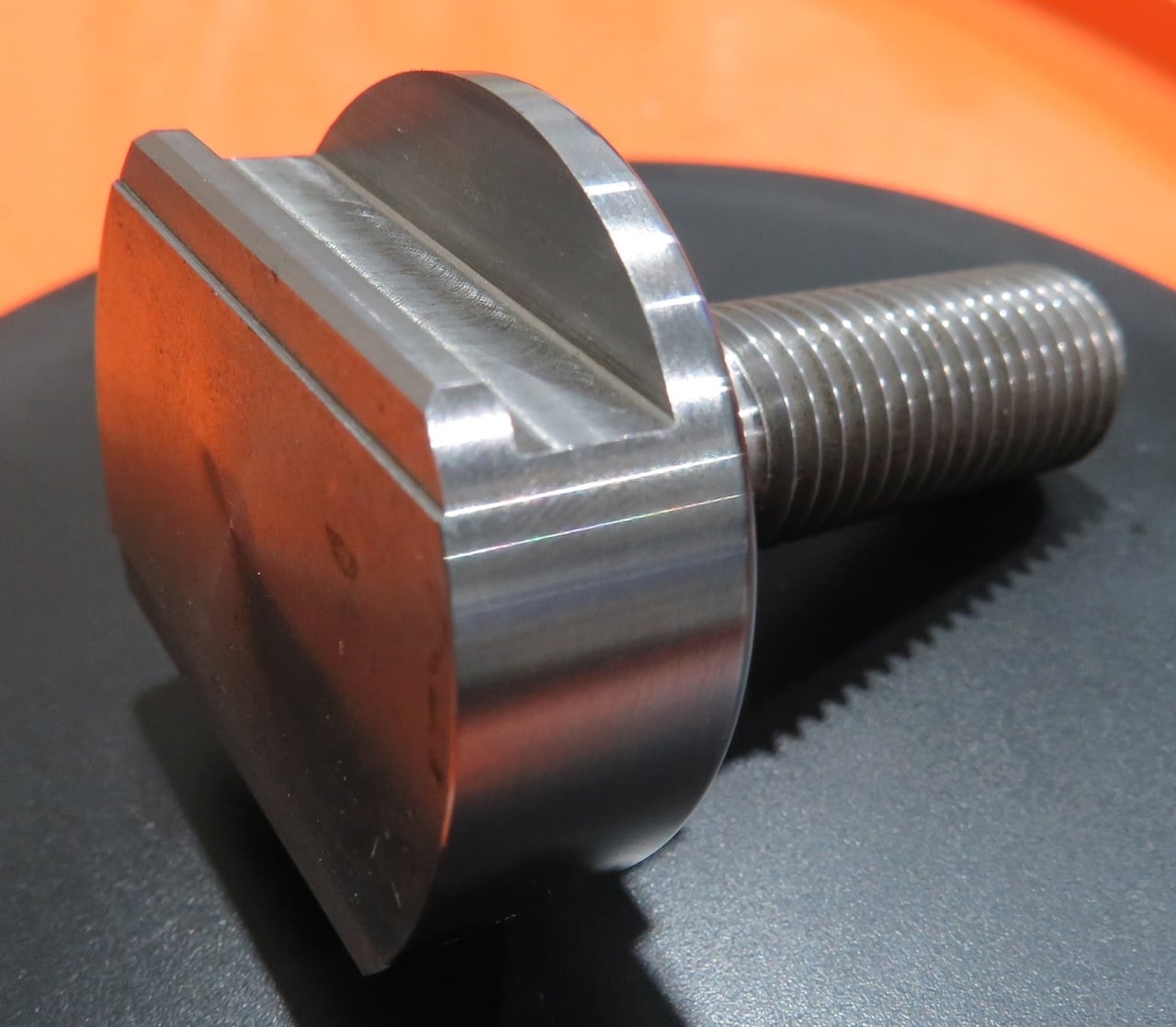

“The Nakamura machines have a lot of versatility and the ability to throw a lot of driven tooling stations at the components. So, if you want to make fully milled parts with complete automation, you can. For example, it can be quite difficult to automate a machining centre, but if you can mill a prismatic component out of round bar, you are better off making the parts on a Nakamura machine. We do quite a lot of that type of milling work on the Nakamura machines.”
“Additionally, you don’t want to be putting your turned components onto milling machines after they have been turned, as it can knock all your geometric relationships out. So, if you can make components in a single operation on a turning centre with all the complex milling and drilling, the quality of the finished part is far superior. Furthermore, the cost per component comes down as there is less handling of the parts.” This is exemplified by the set-up of the latest Nakamura machines that are all equipped with barfeed systems and a part accumulating Rota-Rack system from Hydrafeed. This configuration permits unmanned machining for upwards of 18 hours.
