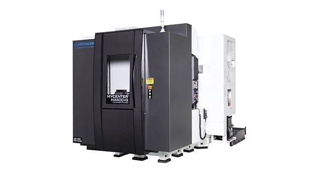

At MTDCNC, we’ve seen many examples of UK manufacturers pushing productivity boundaries, and this application from Iconic Engineering Solutions, using a Kitamura H400 horizontal machining centre supplied by Dugard, is a standout example of high-efficiency machining.

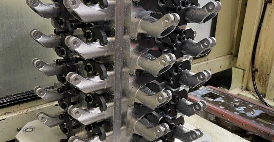

Iconic Engineering Solutions has designed and manufactured a bespoke high-density workholding system that allows them to fixture 48 parts per pallet on their Kitamura H400. With one pallet dedicated to Op1 and the other handling Op2, the setup enables continuous, uninterrupted production with minimal operator intervention.
The results?
  • 1,000 parts produced in just over four days
  • Standard 8-hour shifts
  • Components come off the machine fully deburred and washed — ready to ship.
