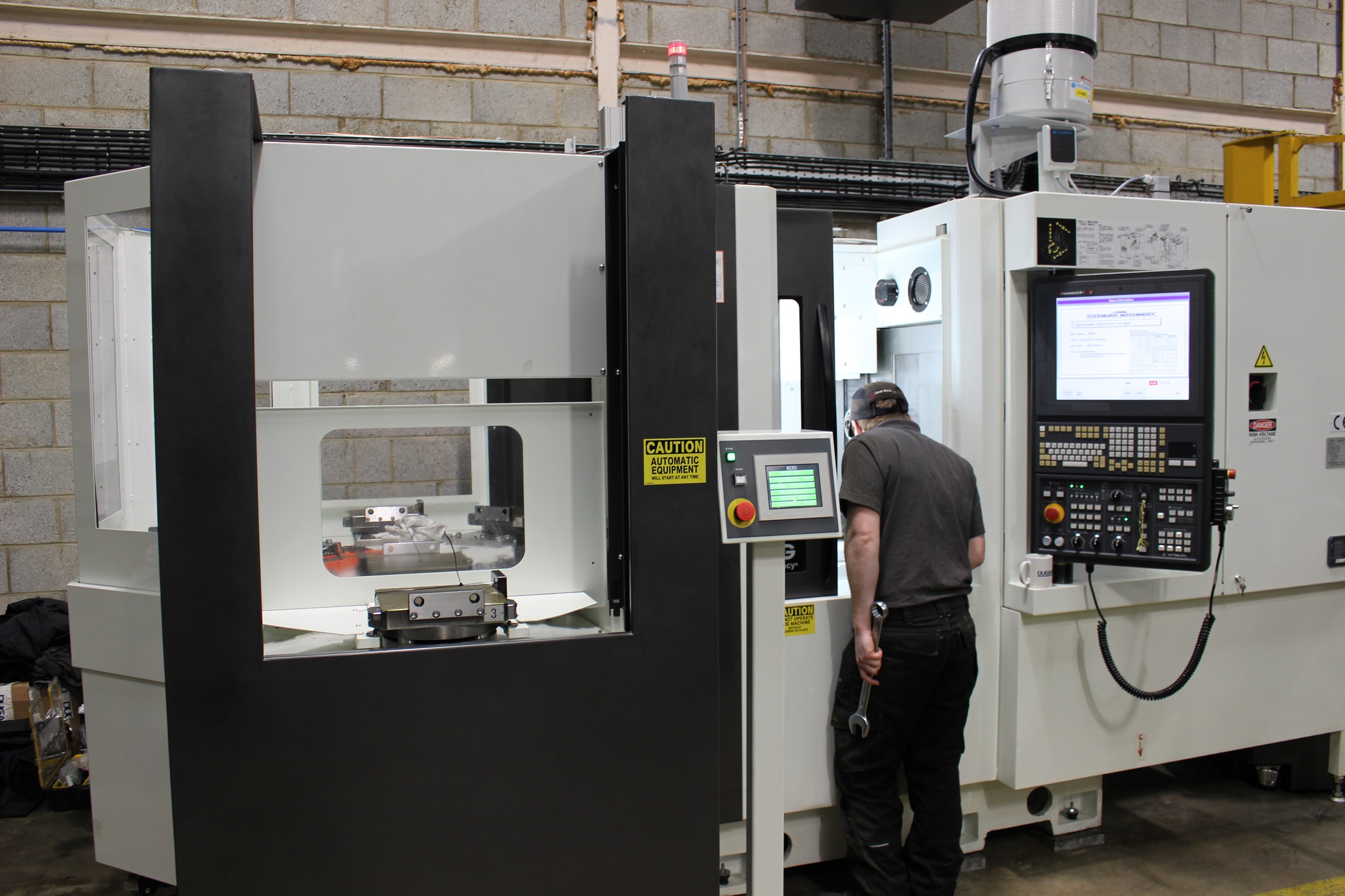

Looking closer at the Kitamura brand, Darren states: “Whilst we haven’t had a Kitamura machine before, everyone knows they have an excellent reputation. The build quality is outstanding and the base is all hand scraped for precision. The spindle speeds and the power levels are all perfect for us. We have gone for a 30-taper spindle with 15,000rpm, an ATC of 102 tools, the 10-pallet automation, mist extraction, Renishaw spindle and tool probes and much more. The probing will be very important for checking tool breakage when we are producing M2 and M3 tapped holes and running small tools, especially when we run lights-out.”
This capability may be somewhat of an understatement from the new owner of the 4-axis Kitamura Mycenter HX250iG. This is because the Kitamura machine offers industry-leading rapid feed rates of 60m/min and a pallet change time of fewer than 8 seconds and tool changes in less than a second. The precision level is epitomised by the 4th axis 0.001-degree table indexing that has a positional accuracy of +/-2 arc/sec. This is complemented by a positional accuracy on all linear axes of +/-0.002mm with repeatability of +/-0.001mm.
The compact machine provides X, Y and Z-axis travel of 305 by 305 by 350mm with full 360-degree B-axis rotation and a powerful 11kW spindle motor that offers the perfect blend for both heavy material removal rates and high-speed cutting of small to medium-sized components. Quality is instilled throughout the machine with high-resolution built-in encoders, double roller linear guideways, dual contact spindle and the groundbreaking Arumatik-Mi CNC control system that incorporates 67million pulse encoder technology and 8,192 block look-ahead capability.
