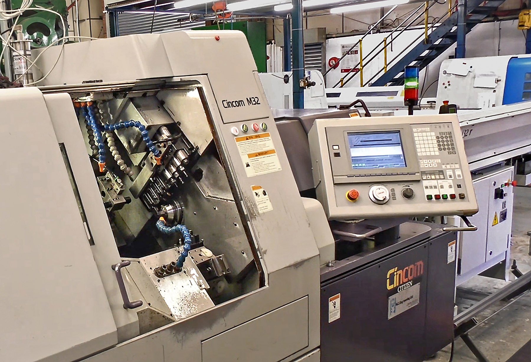

Vertical machining centres and a single-spindle, fixed-head bar auto are to be found on the shop floor, but in May 2020 the company bought its first sliding-head twin-spindle lathe, a 20-year-old Citizen Cincom M32 equipped with an Iemca Boss 432r barfeed. It was originally sold in 2000 by the Japanese manufacturer’s agent for the British and Irish markets, NC Engineering, which in 2008 became a wholly-owned subsidiary, Citizen Machinery UK (www.citizenmachinery.co.uk).

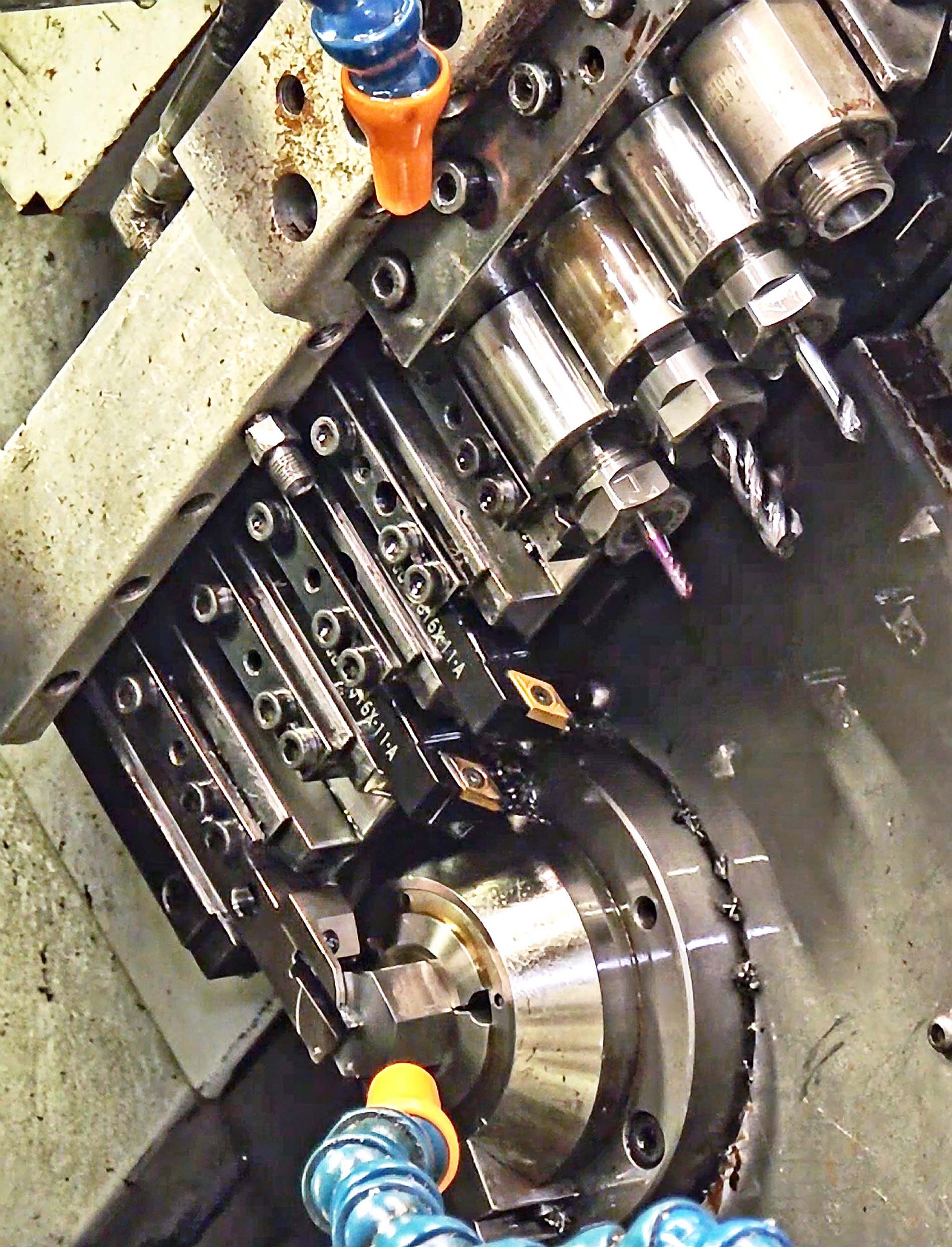

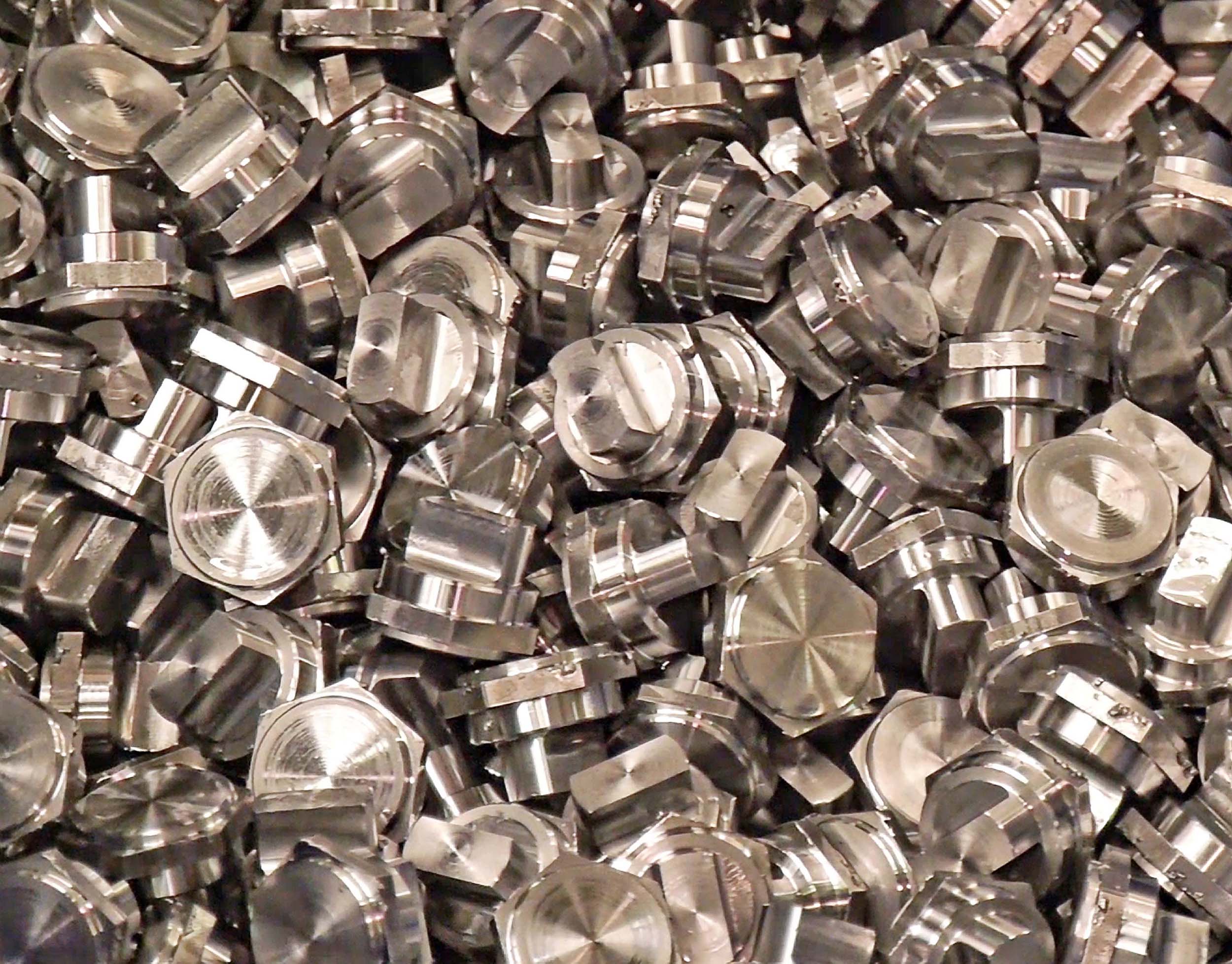

None of this is necessary on the Cincom. It is able to synchronously and automatically transfer a component from the main spindle to the counter spindle for back-end machining while front-end operations are carried out simultaneously on a new length of bar. Prismatic features are added in the same cycle using live cutters and the tool carrier’s Y-axis. Components come off the lathe pip-free after parting off due to close control over the machine’s spindle speeds and feed rates. Production times have drastically reduced from, for example, 3.5 minutes down to a single one-minute cycle without any manual intervention, allowing parts to go straight to plating.
Director Phil Stanley added, “The speed and surface finish we are achieving are just incredible and the fact that there is no operator intervention means that we are able to implement lights-out production, which we are looking to do later this year.”

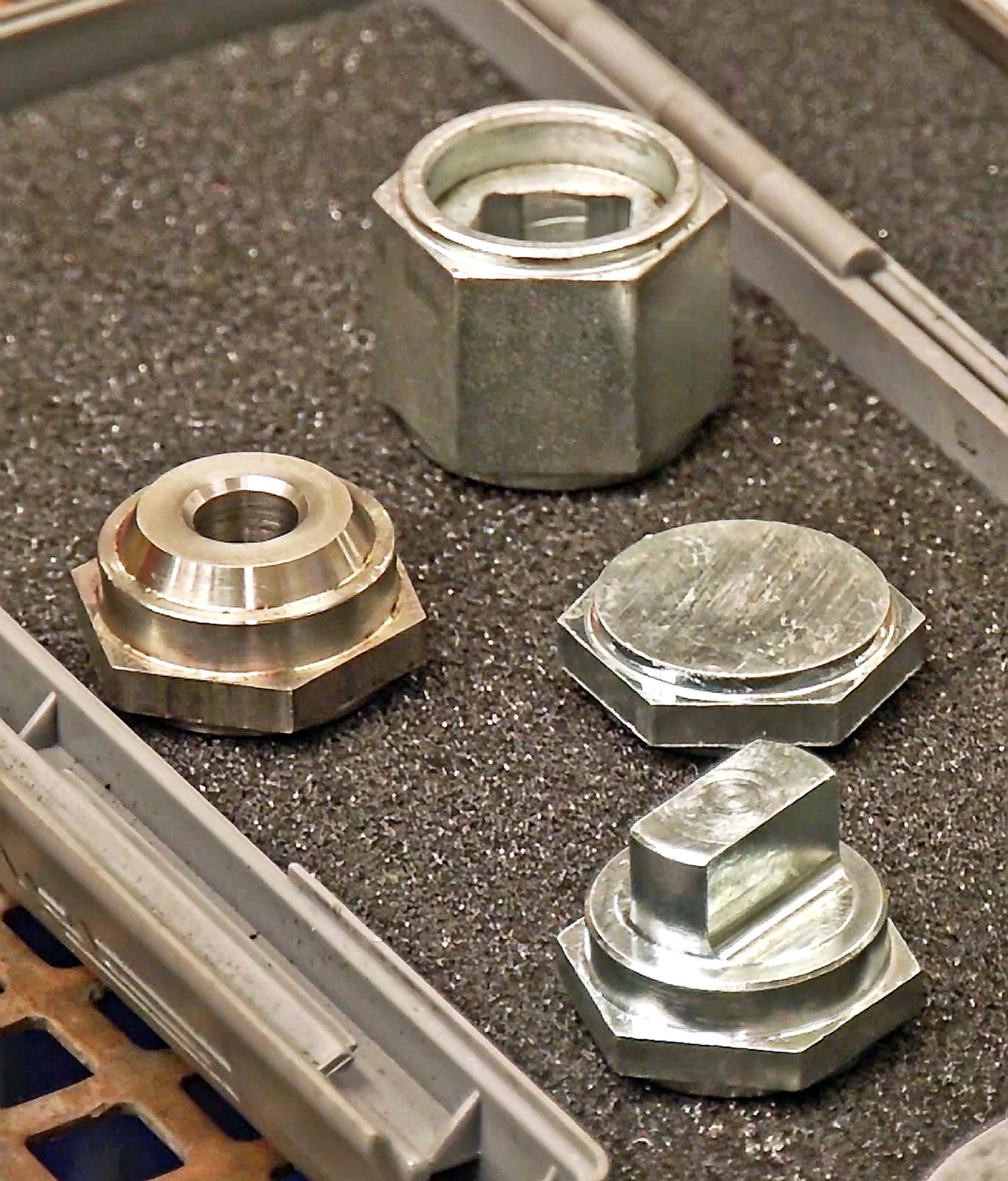

In the first few of months of operation, the Cincom M32 was devoted to large volume production of one particular component but another four part numbers have now been added. All are machined from 1 inch hexagonal steel bar and annual production will exceed 200,000-off.
